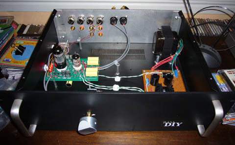

Been enjoying the Impasse back at my place again. Here is a photo. Not really finished, but one input is all I need ATM. Still sounds great. Jack, thanks for making those boards!! You still have a box of them? I'm very pleased that I used the monster chassis from an old B&G power amp. Having everything with lots of space around it helped make assembly easy..and its really quiet.

The reason I want to attenuate one amp would be that my bass drivers have their own amp and are less efficient. so I would turn down the amp for mid/highs to get the correct response.
Jack, Ohhh,
so those are spaced for Molex connectors! That explains the eeensy holes. Doh! Wiring that was the job of the
Assembly Department- Jan Didden wired the boards to the inputs and outputs and to each other.. 🙂 I think he just gooped on solder and stuck the wires in the puddle..
In the photo you will see the "Pass DIY" sticker. While this isn't exactly correct, it IS for a Pass amp and I didn't have "SYdiy" stickers, and I
had to cover the old power switch hole with something!

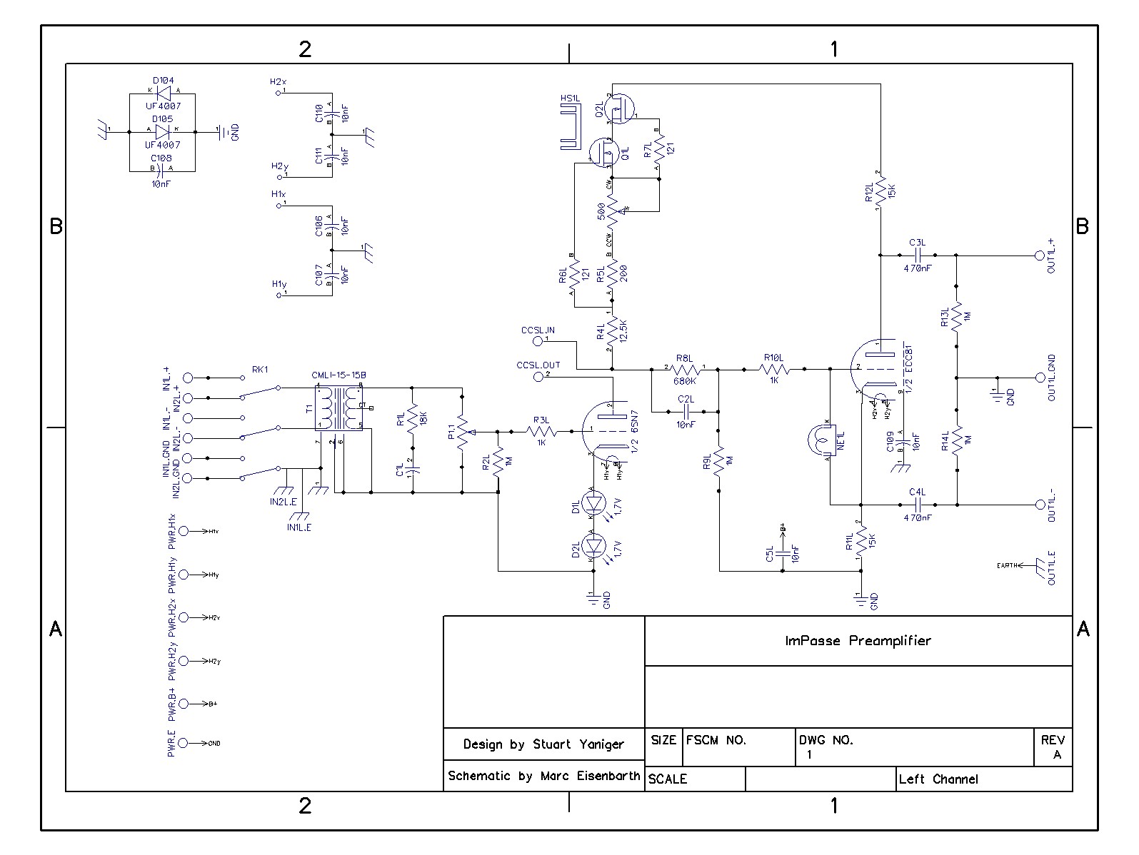

I started to read this thread near at beginning and have only just looked at it again. Could someone point me to where I could find a copy of the schematic please? I assume it's available by now.
In respect of the Molex connectors -- I do, in fact, use ribbon cables when I have ones of the correct length. It makes life (and testing) so much easier. I also use CAT5 and have some teflon insulated #28 which I purchased decades ago at Electronics Surplus in Cleveland.
To what I know, the schematic isn't available on line.
[snip] Wiring that was the job of the
[snip]!
I DID NOT! However, come to think of it, it was like a search-and-destroy operation. You need another solder iron, remember 😉
jan didden
This isn't the original schematic from the article, but a pretty accurate redrawing of the signal circuit portion from fellow diyer and neighbor luvdunhill.

To contribute to this awesome thread and device, I just whipped together a BOM from the original info. It would be great if someone could proof it for me.
Great! It seems I deleted a bunch of resistors in the transfer, plus invented a 112k5 resistor. Thanks for the review.
R5 is listed as 200R in the schematic and 300R in the article... I have it as the 300R
Completely non-critical. It can even be 1k and make no difference to the circuit operation- strictly there to prevent oscillation of the MOSFET.
