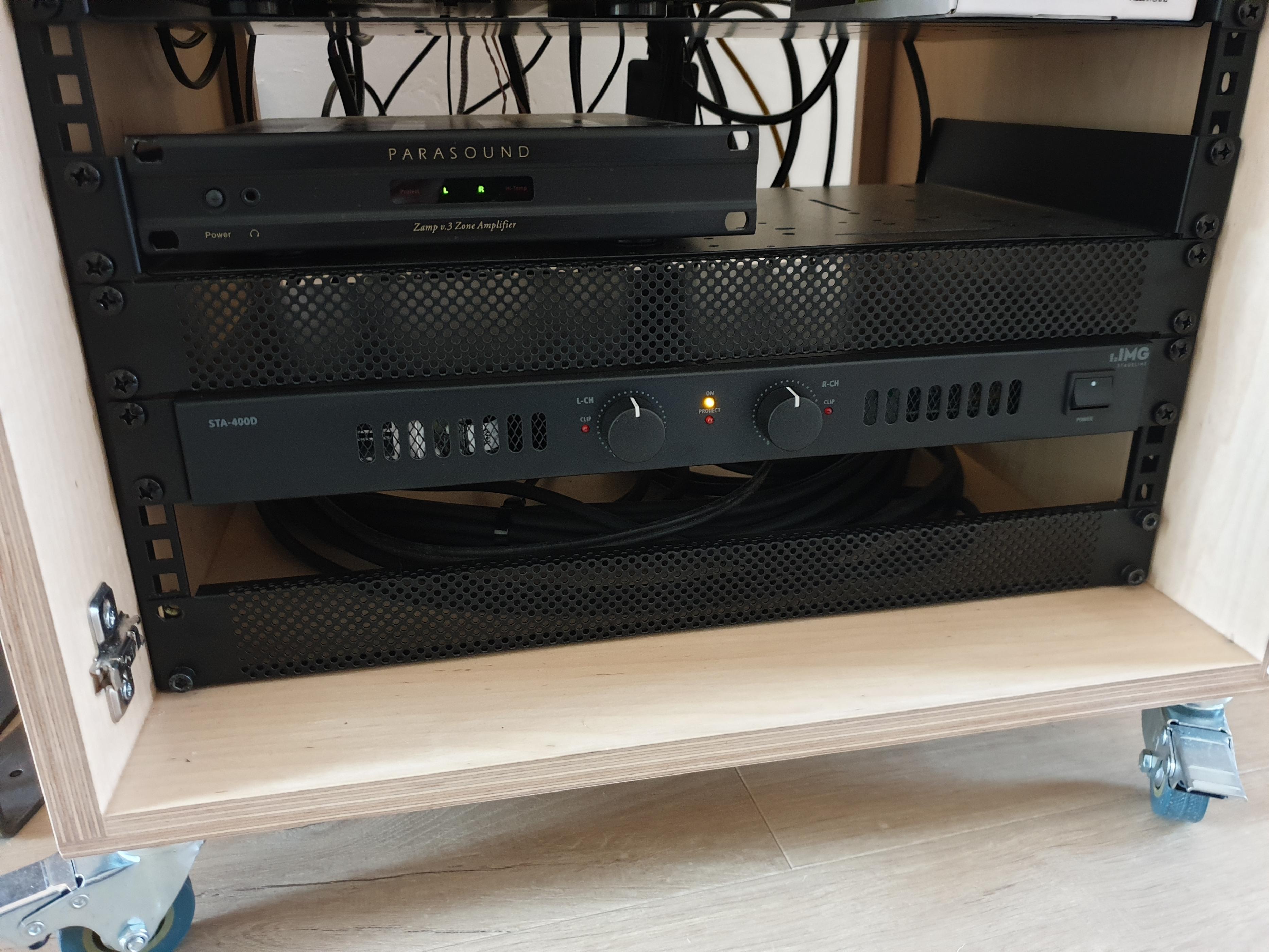

Installed my 400D today. Only using it for 100hz downwards so not a lot to report yet. Need to give it a movie workout.
Only comments I can make is that the heatsink side gets very hot and the fan noise is only audible when you put your ear to it. Not silent but close enough.
It is a 1u amp after all. Fans that small need to make a bit of noise in order to have any effect on airflow whatsoever.
I've seen some other more quiet compact designs have used larger fans tilted at an angle inside the enclosure and a bit of creative ducting.
Small fans need higher rpm than bigger fans to move the same amount of air, same as with woofers.
No, I'm not vcomplaining about the fan noise. Just drawing it in to comparison to the manual stating silent operation. I guess in an industrial or installation setting this qualifies. Mine is in a cabinet so is inaudible.

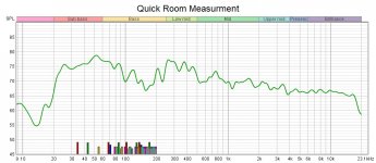

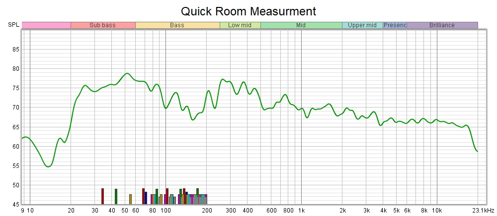

My wife and I just bought a house and I did my first sweeps for the set up and it does show a roll up at 20hz. Again, fine with me as we are in a Victorian terrace in London and pays to not bother your neighbours with infrasonic noise.
