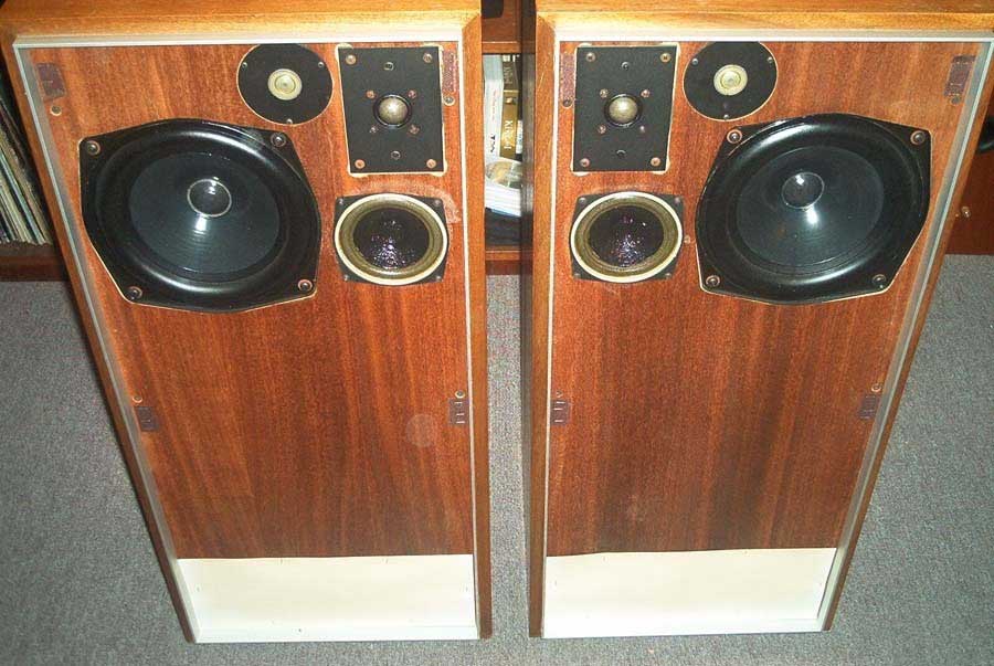

Hi DIYA,
I acquired a fantastic pair of IMF TLS 50 II's recently and unfortunately some of the drivers have been replaced. They still have the original Audax 12X8 D25 tweeters and Kef B200 woofers, but the one midrange and the supertweeters are different. I'm looking for some input on what I can do about the midrange drivers because I am quite happy with the supertweeters. Unfortunately though the midrange was replaced with something that sort of was just slapped in and this needs to be remedied. It looks like the other midrange is still original.
If someone might be able to tell me what midrange the original driver is that would help.
Here are some pictures:
Honestly, I'm not sure which one is the original and which one is the replacement!
Thank you for any and all help.

Jeff,
Your pictures are linked to inside your gmail accout so we can't see them. If you could attach them to the forum (Go Advanced, Manage Attachments button)
The mids on there are Peerless K4040 (? not sure if the numbr without looking it up) in the cans, your pic will remind me of the superTweeter (Coles 4001?)

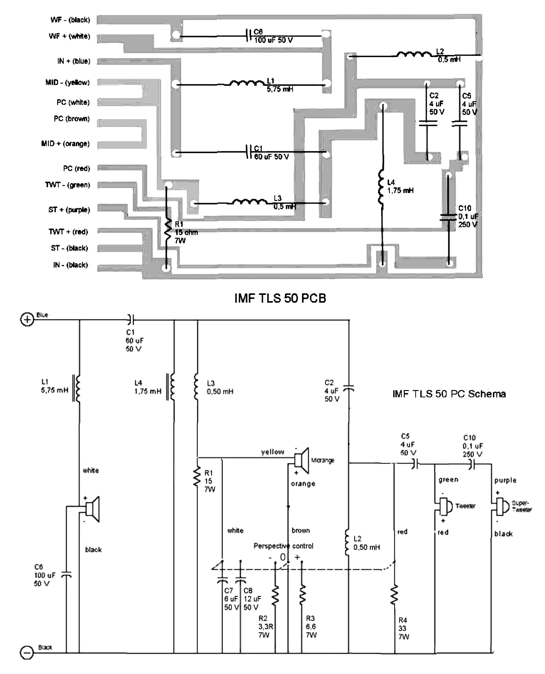

snatched from elsewhere

With regards to the supertweeters, I'm not so sure if I do want to replace those. I don't know a whole lot about replacing components in speakers, although I am experienced with Car Audio.
Anyhow, what I'm worried about is the crossover. I'm no electrical guy and unfortunately I think modifying the crossover is a bit out to lunch for me for now, unless I must absolutely do it for the mid-ranges and then in that case would be a worthwhile venture for the tweets possibly.
What's your thought on that? I do like the supertweets in there right now so I'm not sure if it would be worth it to change them out.

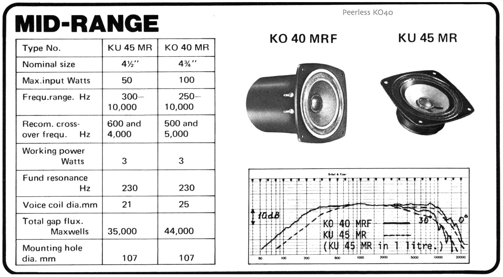

OK so I think I actually managed to find a pair of Peerless K040MRF midrange drivers in working order!
However, I have heard there are two different types of this driver and only one is correct for the TLS 50 II's? Can someone confirm this? I read somewhere that there is a "can" type and that is not the right kind for my IMF TLS 50 II's.
attachment.php
Pull one of your mids and if there is a cardboard tube in bhind, then you'd prefer to have the open back version. The canned version could be installed. I don't recall whether the can can be removed or whether it is part of the basket. Jerry at Falcon likely knows.
I still think a 2-way with something like FF85 is the way to go.

I own a pair of the 50's and a pair of 40's. The pictures of the mids you are questioning look nothing like the ones in my 50's and 40's which are identical, which I can assure you are stock. I bought these speakers from the original owner, an elderly gentleman, the mids in the 40's need refoaming which also lead me to believe they are the original. I believe IMF may have used different drivers in the course of their evolution. I have noticed that particularly with the bass drivers I have seen pictures of.
I am a new member here, just joined. I was actually on the hunt for a pair of cole super tweets for my 50's, when I came across this thread. I know this thread is from May, but I could send pictures of the mids in mine sometime if that would help any...Terry
