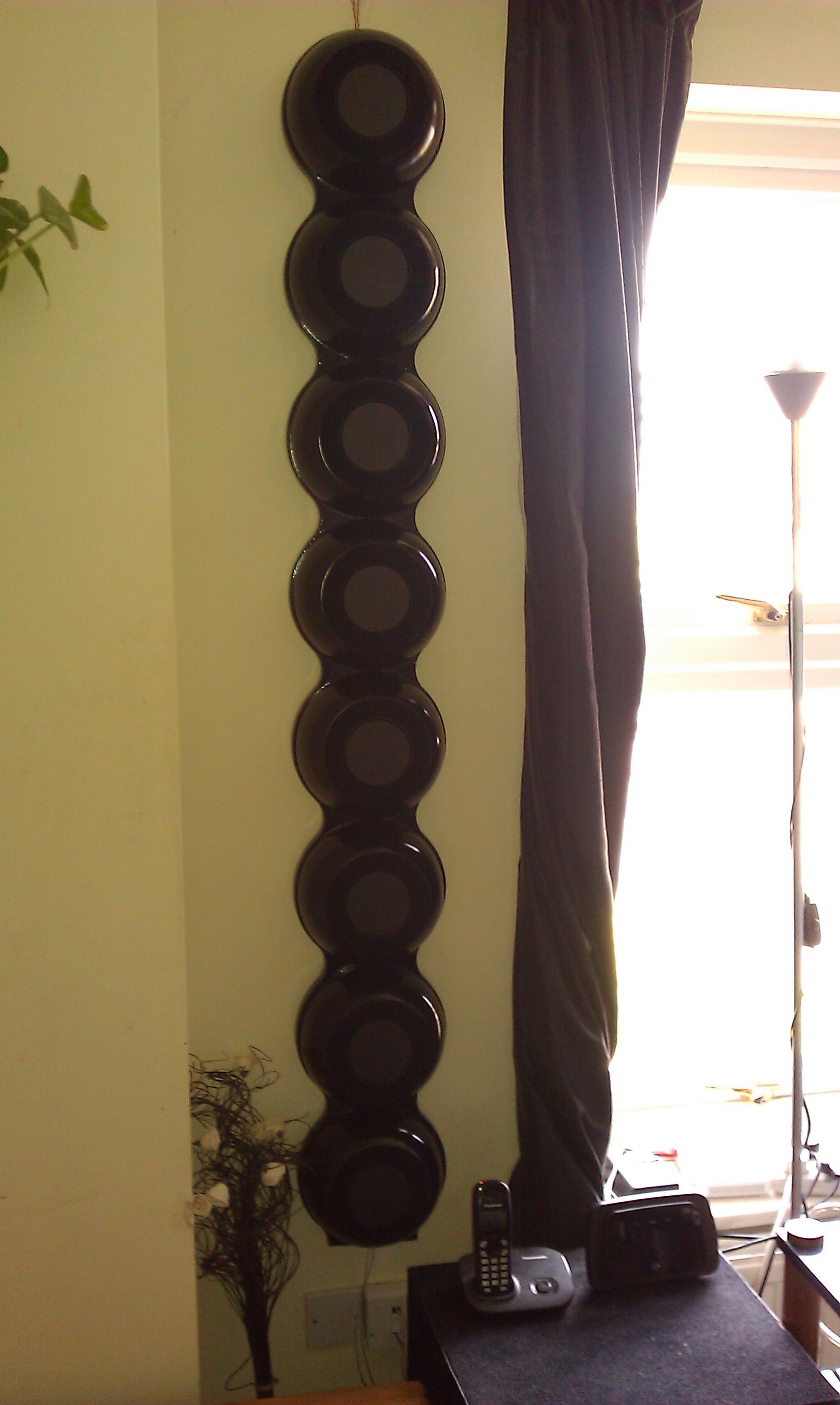

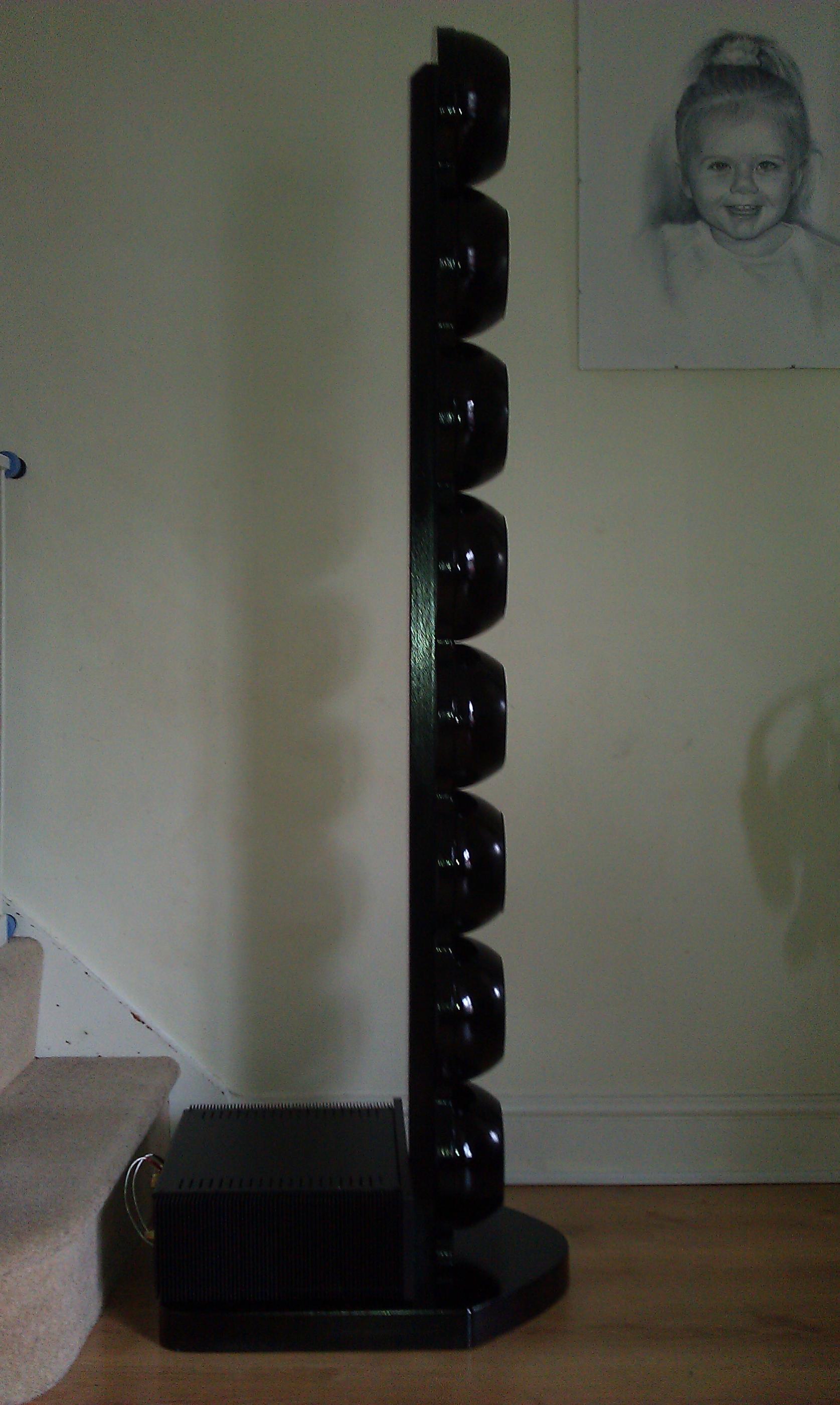

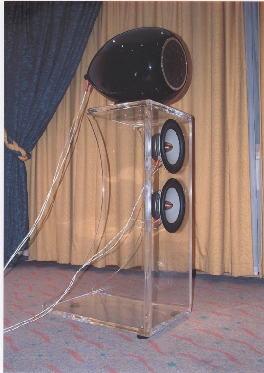

I have been a long term fan of the Manger driver, used in custom 20Kg "tear drop " enclosure it is a true point source reference above 300Hz or so. Attached is a pic of the "Angel", and acrylic open baffle bass / mid cabinet with the Manger in its "tear drop" enclosure sitting on a 25mm custom Sorbothane support.
More recently the 4.5 inch Neo magnet BMR driver has caught my attention and I am enjoying great sound from the BMR in line array cabinets. Attached a couple of pics of an on wall and free standing line array.
Used as a single point source in a "flat faced rugby ball" or even conical enclosure they are unbeatable desk top monitors or nearfield studio monitors. Two caveat's, low max SPL's...
There is no way round 20 watts max continuous power handling and 89dB / 1 watt sensitivity with a single driver, the max continuous SPL is only going to be around 104dB with around 108dB or maybe 109dB peaks.
Still loud enough for most folks nearfied or in small rooms.
Second caveat, must crossover to bass driver at 150Hz (48dB or higher, octave slope) to 200Hz (min 24dB per octave slope), if you try 80Hz straight to sub its not so pretty!
The good news is that used in 10 or 16 driver line arrays you dont need a sub at all! Genuine full range music with no bass or sub drivers to crossover to.
I Eq flat to 35Hz and have great dynamics with headroom to die for.
The unique broad and even off axis power response of the BMR makes it a perfect choice for line array and the on-wall cabinet design benefits even further from boundary support at low frequencies.
I do encourage you to try a pair, the BMR 's are low cost so its well worth buying a pair and experimenting to judge for your self.
All the best
Derek.

Cheers Derek, those are fascinating designs to see – what enclosure materials are used here other than the acrylic? Which BMR is this exactly (the CSS one?) and where are you sourcing them? I'm very curious how this unit compares with the Tangband aluminium flat cones, if anyone can comment...or speculate. Also, what DSP/active crossover equipment have you chosen to use?

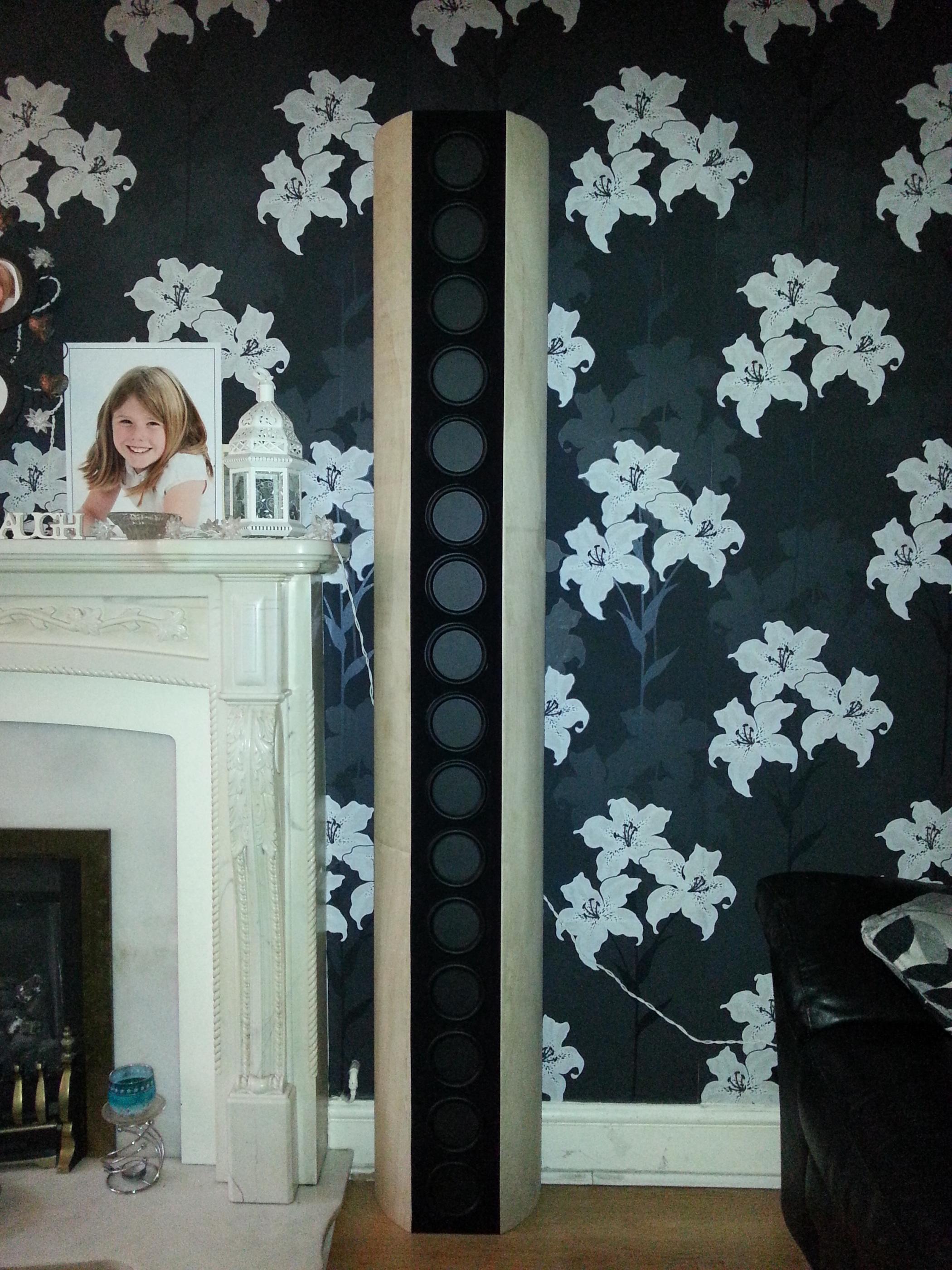

LA 16 unfinished
Hey Patrick,
If you liked the Naim with 1 BMR, you will love these...16 BMR ( 4.5 inch Neo magnet) per side!
112mm square driver chassis mounted tight edge to edge so 112mm centre to centre. I simply can not hear any peaks / nulls comb filtering effects at any realistic listening distance. even at 1 meter they blend better than a two way stand mount, at 2 or 3 meters they just engulf you in sound.
You are right about imaging, really even everywhere in the room.
Makes Eq'ing easy as it sounds the same off axis as it does in the listening seat.
About a year ago I made an 8 driver per side version using a slightly differend BMR, still great results even with 200mm centre to centre spacing.
Cheers
Derek.

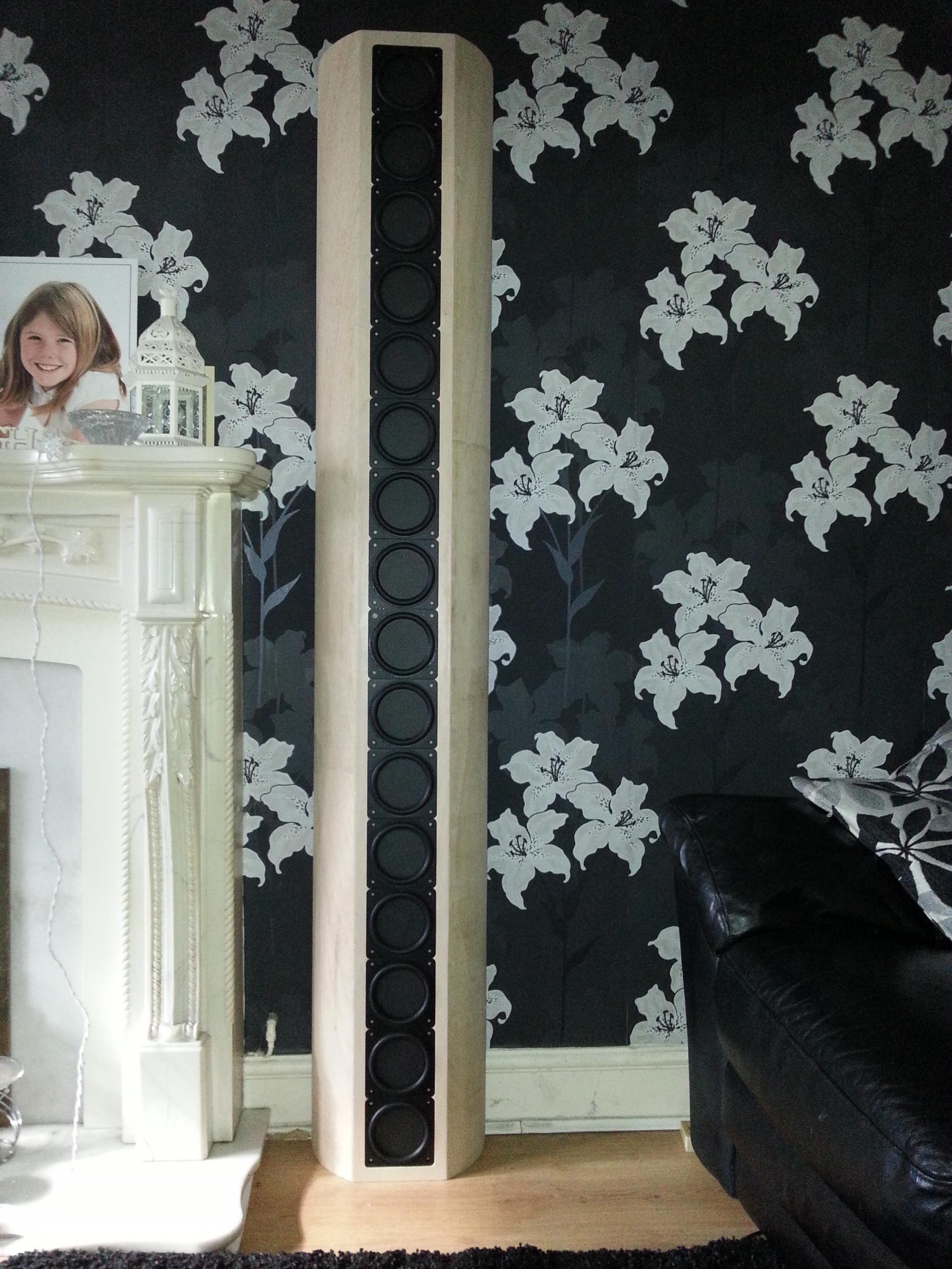

4.5 inch Neo BMR
Hi Colin,
I had to buy a large MOQ of drivers to get the spec and quality I wanted.
The ferrite magnet versions sound muddy and distorted to my ears, the rear wave bounces off the large magnet and straight back through the cone...Out of phase, yugh!
Also the small Sd of the 2 and 3 inch drivers means they have to really pump in and out big time to produce high SPL's. This also adds to the muddy sound and loss of detail, all very stressed.
So for me the 4.5 inch ( Sd 60) Neo magnet is the Goldielocks driver.
I am going to make a range of DIY kits available in a couple of months.
The attached LA 16 's are astonishing, really surprising everyone so far, even me!!
Cheers
Derek.

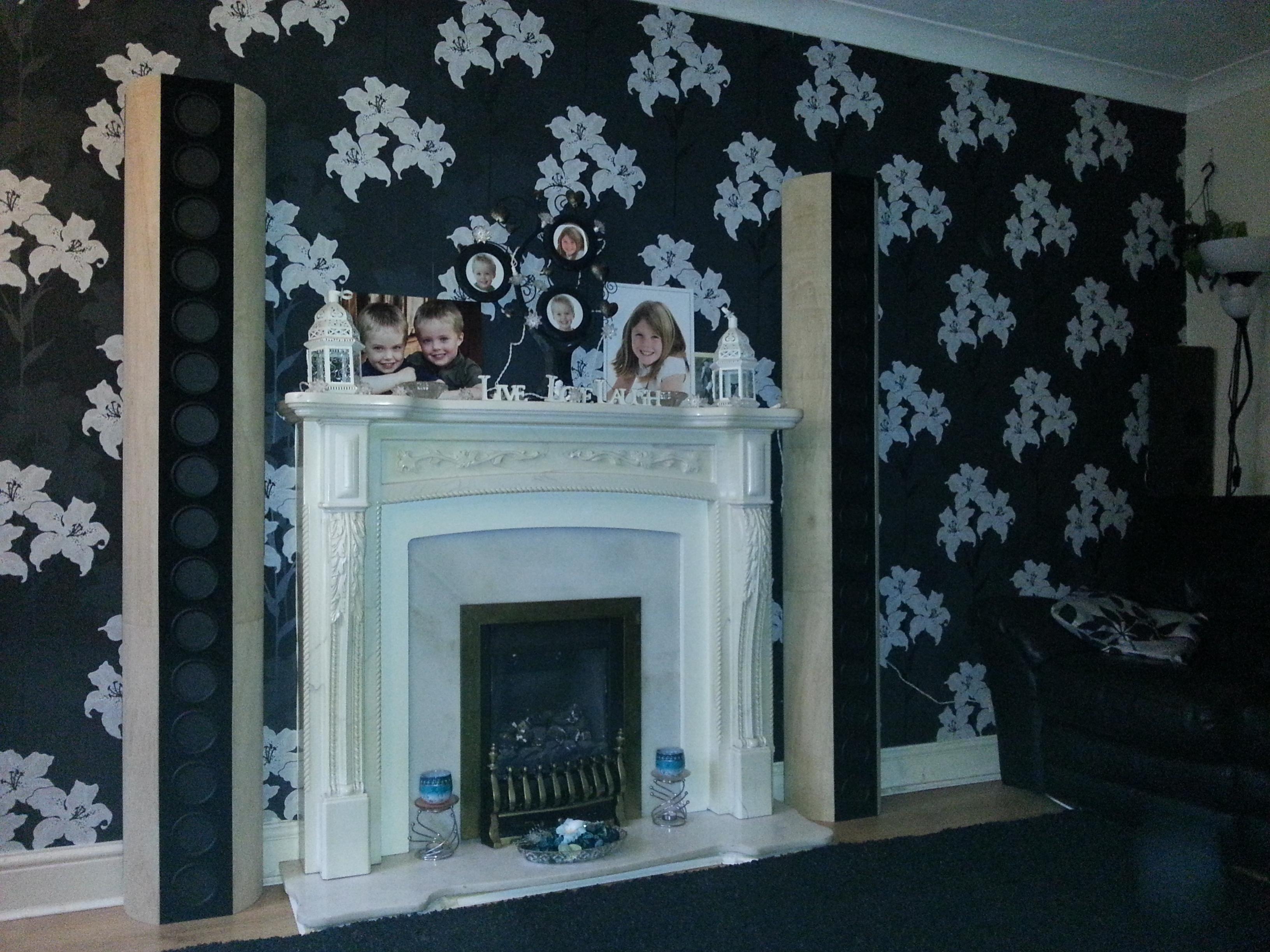

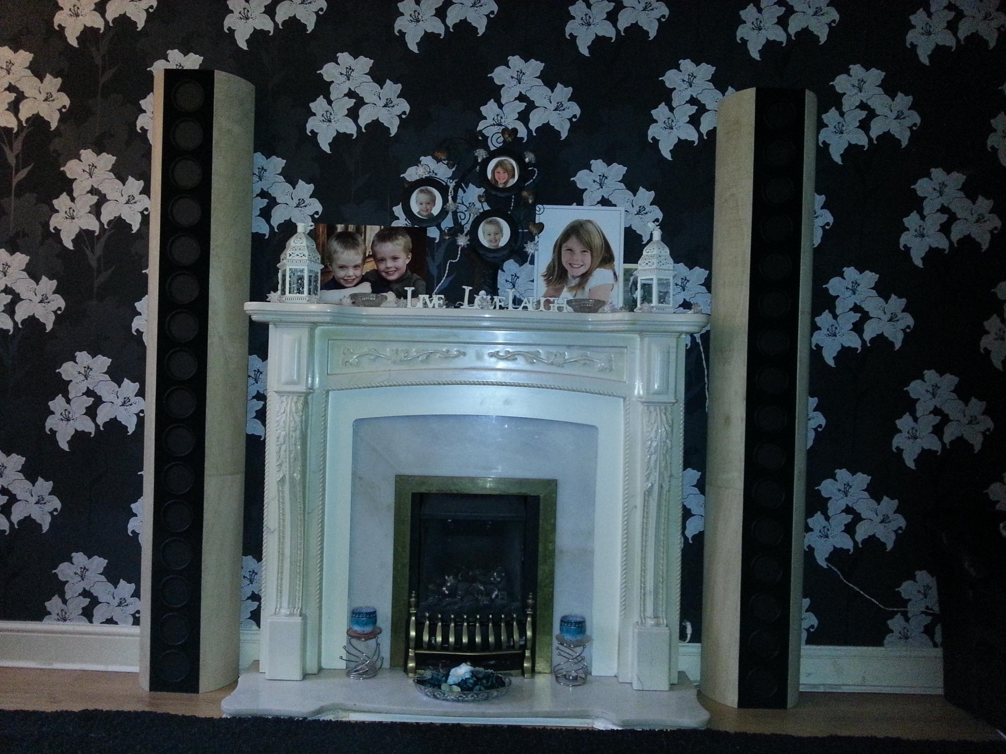

For the LA 16 ( picture attached) a set of 32 drivers will cost £ 1,248
The LA 9 ( 18 drivers) will cost £810, and the 8 drivers for the LA 4 will cost £ 392.
I havn't worked out all the kit options and prices yet, but they will be very high quality with everything included for a really high end result.
The finishing will be up to the customer.
The 4 Ohm, LA 16 is a genuine 100dB for 1 watt @ 1 meter:
So 2 watts gives 103dB,
4 watts gives 106dB,
8 watts gives 109dB,
16 watts gives 112dB
32 watts gives 115dB
64 watts gives 118dB
and 128 watts gives 121dB.
I am able to run a very high current and high power, (140watt into 8 Ohms, 280 watts into 4 Ohms) almost flat out with a lot of music.
Realistic in room peaks of 120dB with average 90 dB SPL, actually sound sooooo much quieter than the meter suggests.
The most common reaction and comment is " I had no idea it was that loud until we tried to talk!"
