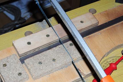

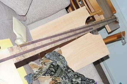

Your post has reminded me to put up some of my steel chopping pictures, anyway first I ordered 6 lengths of 3000x13x3mm mild steel.
The next task was to bodge a jig together so I could cut the steel into more manageable lengths, my wife was NOT happy about our flat being used as a storage area so....
Several fag packet calculations later I had figured that trapeziums were needed, 45 degree cuts on one end and 90 degrees on the other which would make cutting easier as I would waste very little steel. The dimensions of the pieces parallel sides were to be 63mm/50mm and 50mm/37mm.
As I was in a rush to appease my wife, I decided to perform my cutting in two operations, first to cut ALL the steel to 100mm long rectangles, then later at my leisure to cut the trapeziums.
The pile of cut steel.
My boss at work is a happy chap and although I have a desk job, we maintain a lab for any small electrical and mechanical projects that pen pushers in other departments may require.
I had been explaining my plans and he just couldnt wrap his head around the tweeter working, I assured him it would so he gave his blessing to use the lab in my spare time to get things working. I will have to do some presentations once I've finished, all part of my personal development plan.
The next step was to make the diagonal cuts, this was achieved by putting the saw at 45 degrees through my cheap, bodged wooden jig.
This left me with approximately 320 pieces of rough cut steel, so out with the file.
My final task was to drill alignment holes through the steel pieces, all measurements were taken from the critical 45 degree cut ends and I used a pillar drill and my previous jig to drill the holes one at a time. I've misplaced the photos of that for the moment, but will post them when I find them (4 pcs and 3 camera in the flat!)
Thats all for now, and yes ALL the steel was cut by me, by hand.
