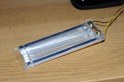

Baldon and c2cThomas, thanks for the kind words, none of this work is finished yet and I'm just experimenting with things.
Here is the element mounted in a perspex frame
This isnt finished yet as there is some unwanted movement in the diaphragm, I intend to try using cotton thread to ensure everything stays in place.
The diaphragm is held to the frame with generic double sided tape and will be mounted in the magnetic circuit with wedges and foam.

Hello Nick - thank you for posting the photo of your diaphragm. If you look at the Heil patent there are some square cutouts that align with the pleats (folds). These were used to anchor the top and bottom of the diaphragm to the frame and thus space the alignment between the folds. Hope this info helps.
Ooh I really should re-read the patents, however this batch of diaphragms is done.
I'll try the cotton with these and change the layout for the next batch as I want to try a slightly wider strip of foil so I can make a bigger diaphragm with more pleats.

Hi Nick
Do you really think the non-permanent spray will hold for long?
For the planar prototype I have made I used 3M permanent spray. Still looks to hold after 2 years (but they haven't been playing much), but I would actually consider something like diluted Araldite or something ...
But 3M also has something much stronger than the oe you are using:
90 HIGH STRENGTH AERO ADHESIVE - Nextag Stores
Do you have any means to make measurements of the units??
Would be super cool to see both freq response and distortion figures.
What is the sensivity of the drivers (just like same as a normal dome, more, or less)?
And again, you are really on to something here 😎 .... keep it up, and keep us posted 🙂

I have had a square of sprayed mylar hanging in the lab open to the air for several weeks now and it is still sticky so I have reasonably high hopes for its holding ability.
If it fails in the future I will investigate other options, for now it was what I had available so I used it, the fact that the build up (thickness) is low I consider a desirable trait so I will stick with spray adhesives, I would think that Araldite would probably become too brittle once set to be considered a suitable alternative.
I have been trying to get my old measurement system working but have too many computers which dont appear suitable, also my original laptop with external soundcard has been formatted and the card disappeared so am having trouble getting a measurement system working, this will be a task for this weekend assuming my wife lets me.
I too would like frequency, sensitivity, phase, impedance, distortion and TS parameters but initially I will settle for the first two.
Sensitivity appears to be higher than a standard dome, I have two magnetic circuits completed, they are the same except one has a 9mm gap and the other a 6mm gap, the 6mm gap is much more efficient, with them both playing I cannot hear the tweeter with the larger gap!
I've no idea of freq response but it sounds better than a portable radio when I play full frequency music through it, though bass is obviously missing.
Nick.
