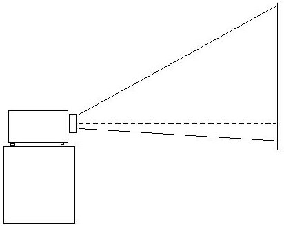

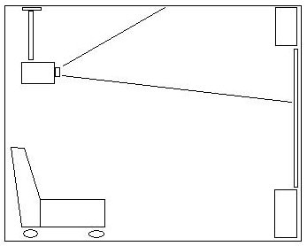

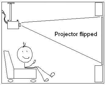

Please see the following pics: pretty much self explanatory...
if the projector is mounted to the roof or on a tv wall unit it will throw most of the projection image onto the ceiling since it is a table top projector. only way is to mount it and filp the image (some how)
I heard it is possible with a HTPC (Home theater PC) but i dont have one set up yet. so i need to find another method.

I thought the light would be spread evenly and not tipped tword one direction.
The projector's I've delt with do not throw the image higher than itself and you have to put books undernieth it to make the image high up enough.
I don't understand why you have a problem. maybe your projector is designed differently.
If the image is partially projected onto the cieling just tilt it down a bit so it shines on your screen.
Then you might complain about keystone problems, but wouldn't you get keystone anyway if the projector was mounted upside down?
yeah, this projector is different i guess. i guess when they design a projector to be table top... thats all they want it to be.
this projector shoots most of the image up.. like shown in the pics. i guess its so that you dont have to set it up on books/blocks/boxes.
i have to worry about keystone because this projector can only correct it by 10%. if i get to much keystone then the image will be all @#$% up and i would like a decent projection. i guess i will try to flip the lcd over or set-up a HTPC to see if it works.
