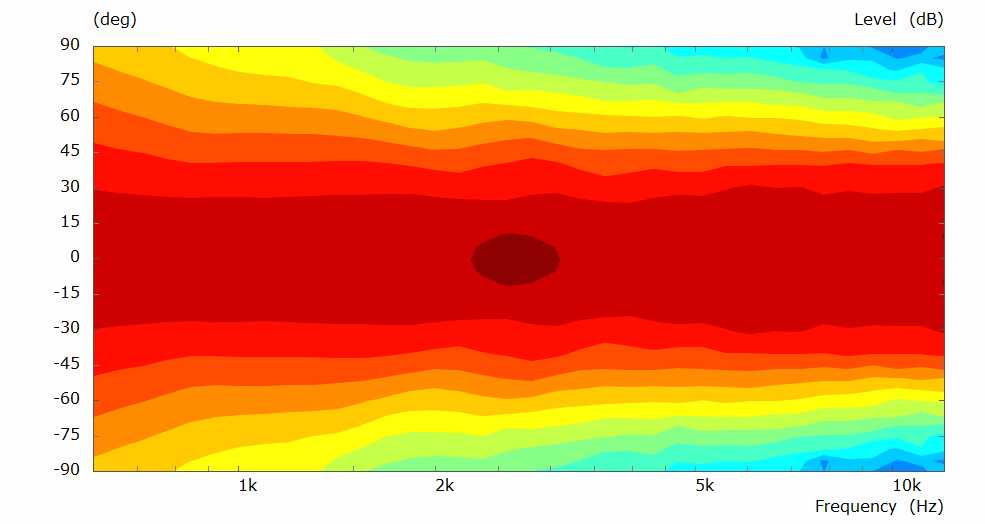

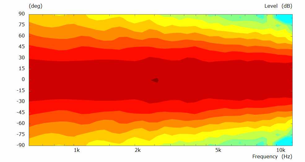

I can't speak for JBL waveguides even though I have one but the shape itself has no inherent need to make that trade off. All the good profiles I have simulated are well behaved in the diagonal. It is much easier to check with a BEM observation script than finding a way to take diagonal polar measurements in real life. You can see the difference between H and D in the attachments.
