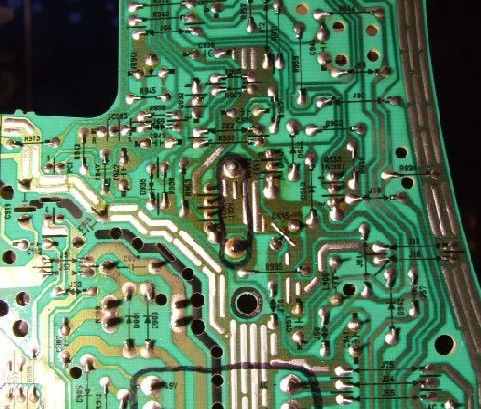

OK, the 24V are taken directly from a winding in the flyback transformer as I thought, so they should be employed in an unipolar way.
How do you want to solve that? The slave PSU has to be powered from a flyback-like arrangement. We can either build a new off-line flyback or use a conventional 50/60Hz transformer and then a low voltage switching circuit. In the latter case, the voltage is not very important, it may be something in the 20V range.

And over to the area of the small heatsink:

OK, if we go switching LV, I have a 100VA 12-0-12 that will be around the right voltage, I'm just a little worried about power consumption, though iMacs are fairly efficient.
If you can point me towards a suitable circuit for an off line flyback then I suppose I can reuse the existing HF traffo. The switcher is a 5S12650 (it looks like, very faint printing), so I suppose I could start googling for datasheets to see if I can reuse that as well.
pinkmouse said:
Thanks Jason, but the problem is not with that board, I just need to get high frequency 24V ac into it, normally provided by the huge iMac PVB, (power and video board, but don't let the video bit distract you, it means CRT driver stuff).
