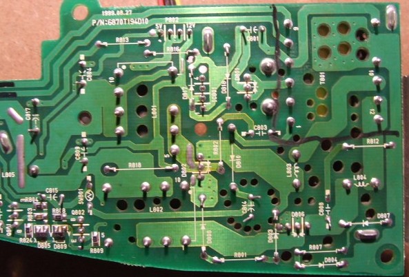

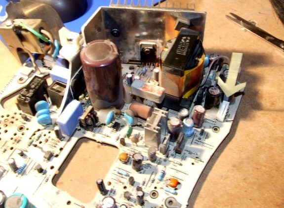

So, the iMac logic card uses a downconverter, pic below, to convert 24AC to the various DC levels required. However, I assume that this is already switched from mains voltage, so that 24V will be running at a much higher frequency than mains 50Hz. So, my question. Is it possible to reuse the big traffo from the main PSU and create a simple switching front end to drive it at the higher frequency required?

It looks like a flyback so it may work with DC input too. Can you provide more detailed pictures including the bottom side of the PCB?

I'll post some more pics in a bit, but I just had to put my camera on charge. I suspect it needs AC though as the input goes directly to the legs of the big transformer on the right.

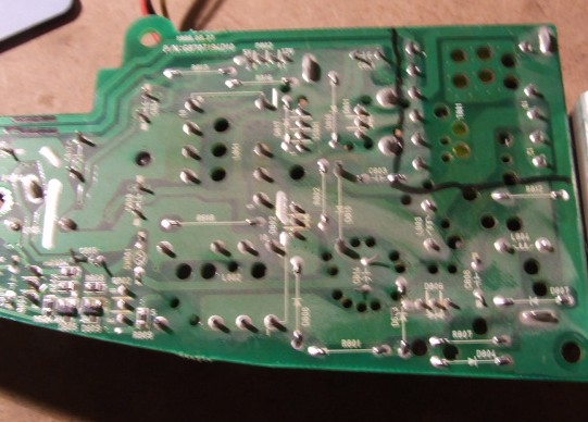

Anyway, pic of the underside by the input/output connector:

Thanks Jason, but the problem is not with that board, I just need to get high frequency 24V ac into it, normally provided by the huge iMac PVB, (power and video board, but don't let the video bit distract you, it means CRT driver stuff).

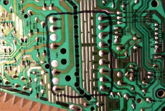

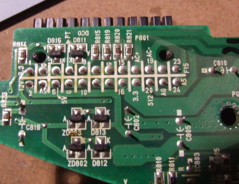

Hi pinkmouse, can you provide a better quality version of the picture from post 9? The dirt and the fact that it's out of focus is preventing me to see most of the tracks. It may not be 24V HF as you think.

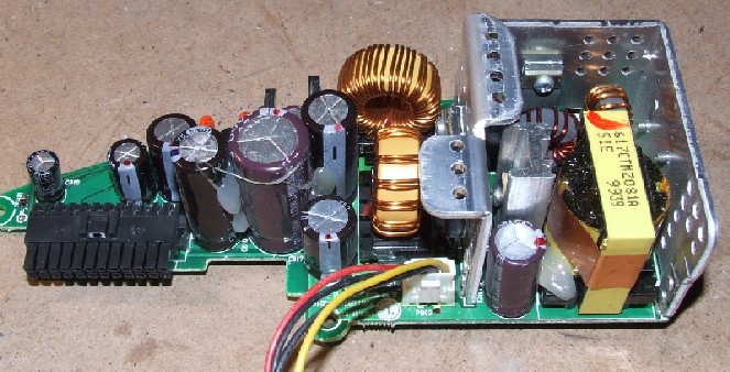

Well, it seems that they use a linear regulator for the 12V output and magnetic amplifiers for the 5V and 3.3V outputs. The transformer is then fed with high frequency AC so you were right. The AC waveform may be either unipolar (switching in one direction for 50% of time and allowing the transformer to demagnetise for the other 50% of time) or bipolar (produced by a full bridge). The frequency also remains unknown, you would have to do some bench tests in order to know how long it takes to saturate and derive a suitable frequency.
Do you still have the circuit that provided the 24V AC? A quick look at the topology would already tell me if it's unipolar or bipolar.

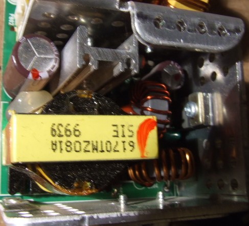

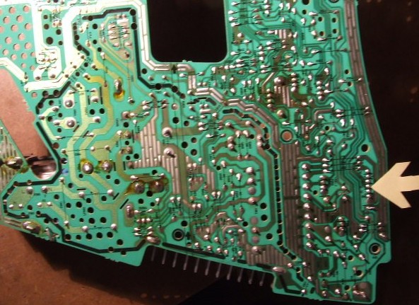

Great, this one looks like a big off-line flyback. Can you take a couple of clear pictures of the bottom side of the board? The interesting portion goes from the big heatsink to the small heatsink (including it) and the edge of the square hole.
They may be slaving the other transformer to the flyback and attaching the primary of the other transformer directly to the secondary of the flyback.
Oh, and try to read the model of the big swithcing IC in the big heatsink, it will probably tell us the switching frequency.
