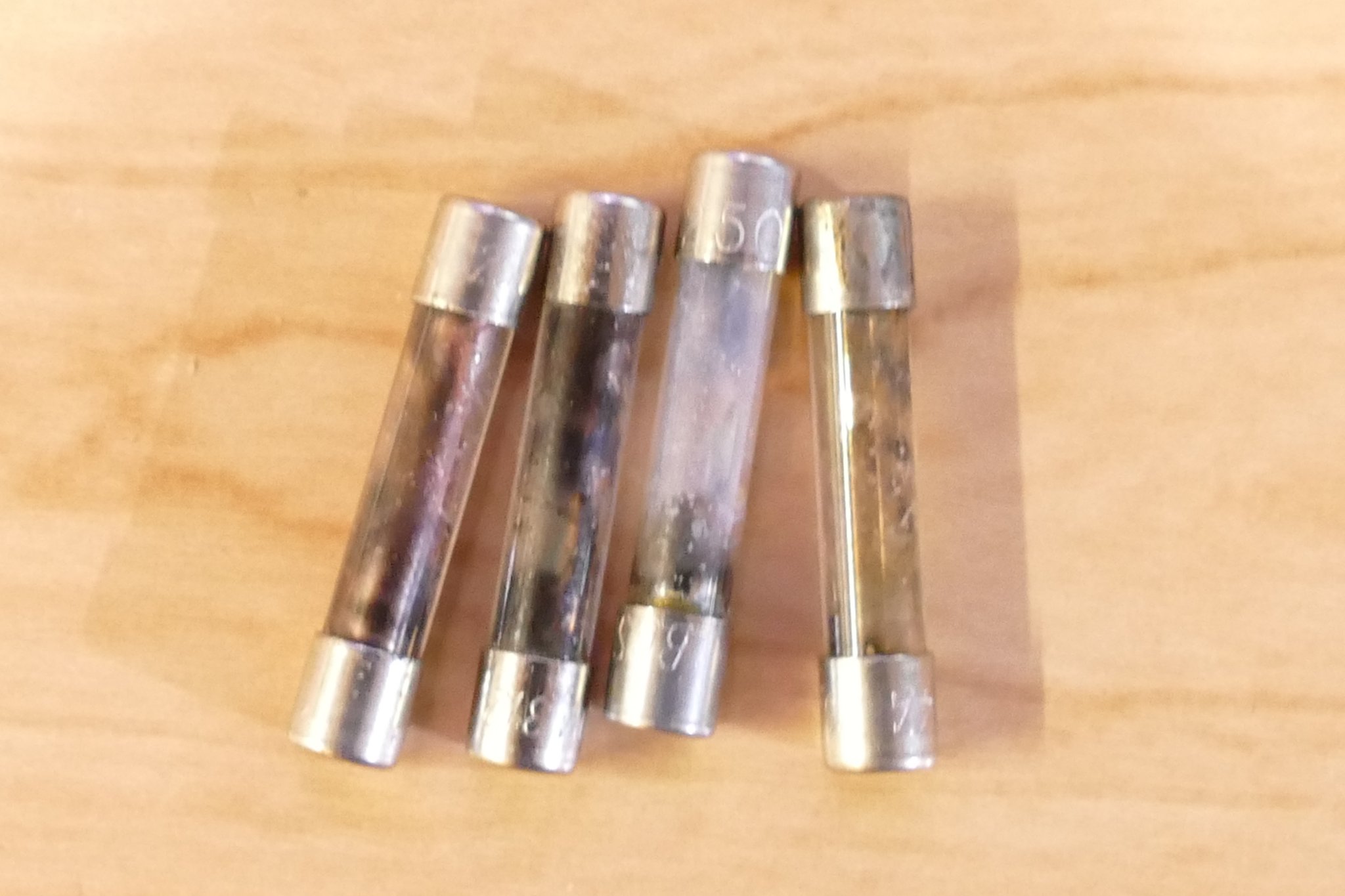

This talk of HP equipment and HP/GPIB reminded me of an event that took place about a month ago. It was a very windy night when I went to bed. No rain or lightning, just wind. Sometime in the early AM I was awakened by a very loud noise. It was a loud burst of some kind but since I was asleep, I can't say exactly what it was. The next morning my wife told me that the 12 year old Sony TV in her room didn't work. Investigation revealed that a couple lights did not work, so I checked the breaker for that room, and it had a ACFI trip (Arc Fault). Reset the breaker lights work, TV dead. OK, it was 12 years old.
A few days later I turned on one of my HP RF signal generators and it did not power up. I tried another, then all of them and none worked. OK, maybe the surge suppressor / power strip tripped. No, both "good" lights were lit and other stuff on that strip worked fine. nothing was left on at the time, but the generators have ovens for the crystal in the master reference clock. They are always on. I finally ripped everything out of the rack to get to the back of the generators. The fuse in each one was blown. Not just a little blown, 4 had their insides vaporized and the 5th one had exploded. What happened to the sig gens that took me forever to acquire and restore? Nothing! I replaced all the fuses, and they all worked. I'm guessing that a tree branch or some other flying debris put the 7200 volt line in contact with our 240 V feed, or some other short circuit further upstream caused the big bang event. Our house is closest to the pole transformer, 30 feet from pole to breakers kind of close. All of the dead stuff is close to the breaker panel. The Sony is directly above it and the generator rack is about 10 feet away in the basement. Everybody else on that transformer is fed by a long piece of triplex.

Maybe double check service grounds at your panel and water.
I lived for a few years in a house that did not have a ground at the breaker panel or at any sort of water pipe. Also the utility said there was a ground wire missing on an adjacent pole.
I Added 1200 square feet of addition to my house years ago and replaced the panel and meter housing at the same time. Realized there was no ground stake at the breaker panel. Also the water pipe that had a wire clamp did not actually run to the panel.
The pesky RF leakage into the stereo seemed to go away after replacing the panel and adding grounds at the panel and water inlet..
Reactions: tonyEE and anatech

Yup, high energy fault.
I did insurance claims for consumer electronic equipment for years. That is typical of an over voltage event. I'm so glad you didn't lose anything serious.
It's a good thing HP is so robustly designed. I'm sure your heart sank to the bottom looking at your gear at first. I'm in the habit of installing an MOV across transformer primaries, 150VAC. This also extends the life of power switches by clamping the turn-off spike that sometimes happens. The ovens for the crystals would have been in the line of fire. The equipment may work, but a temperature regulator could go wonky. You would have caught a total failure by now I would think.

When I worked at DEC - say, mid 80s - we tested the power supplies with this "Keytek" AC line transient generator. Running the test, I used to think "This doesnt do anything" - until the day it did. Found a nice, pointy etch trace close to a screw head...
I'm sure HP tested such expensive equipment similarly, before release.
