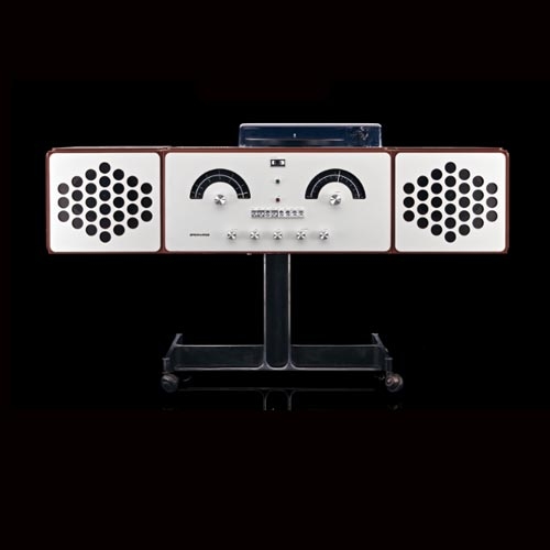

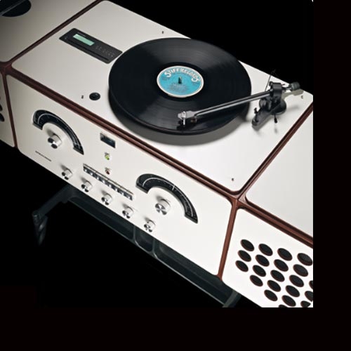

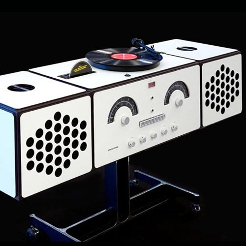

Hey, does this remind anyone of something?
Its the Brionvega Radiofonografo RR126. Its a new machine recreating a 1965 original.
I dunno, sure reminds me of something...now if I can only remember what...
By the way, there's a place that has it on sale for only 4900 euros.
Kind of makes me think that my Project G could be worth something if I ever needed to sell it.

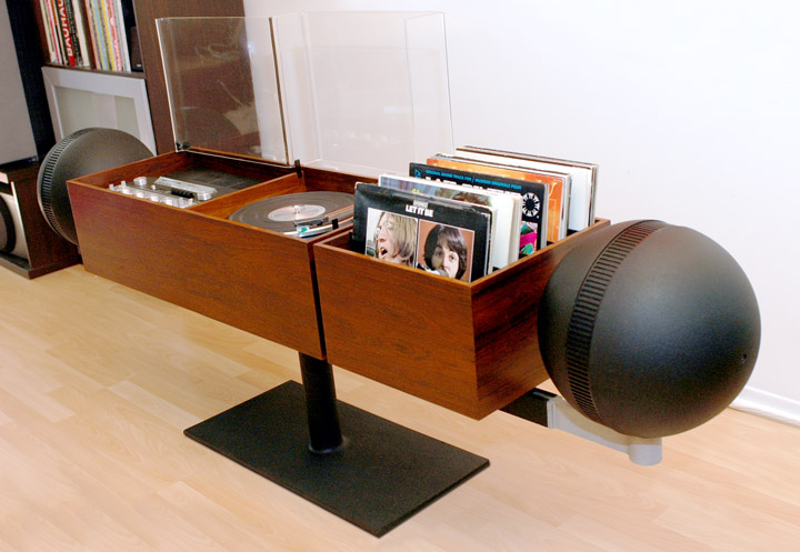

Some updates: I had been thinking of not including a turntable, that is until my son brought home a free Garrard Lab 80. So how could I NOT put in a period appropriate turntable like that? So that means that now I need to use a vintage style amp. I have a Marantz 2220 that could work well. I am also thinking about how to set this whole thing up as a media center.
Is nothing simple?!
I'll be starting this project with the speakers. Now, if I had some spare cash I could buy those drivers and get started. Who needs food anyway?
Is nothing simple?!
