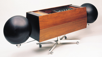

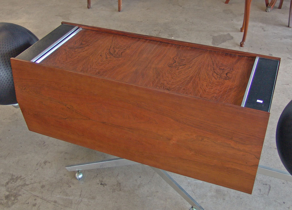

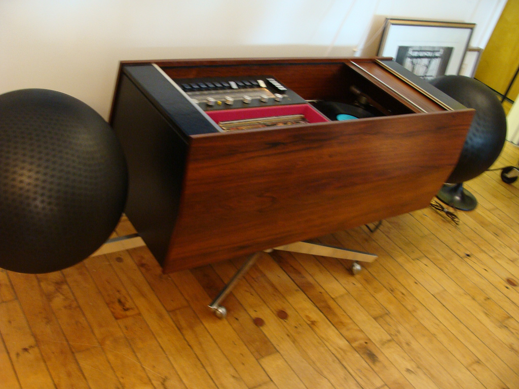

This is what I have to work with. The speakers are built into 18" globes, mounted on arms situating them on either side of the cabinet. The globes are two hemispheres, the back is solid and hold all the guts, the front is basically a decorative grill. Originally the front hemisphere consists of two perforated, spun aluminum pieces, an inner "silver" one and an outer anodized black one. The original speaker driver was a Warfdale Super 10. I don't have any info on how it was utilized.
I don't feel any great loyalty to the original speaker design or electronics. The only requirement from me is that the whole thing needs to fit within the 18" diameter of the globe.

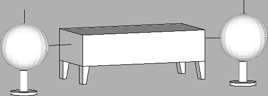

Something like this sketch. Its nothing serious just putting down an idea I had while laying in bed the other night. The bottom right circle, seen in profile.
