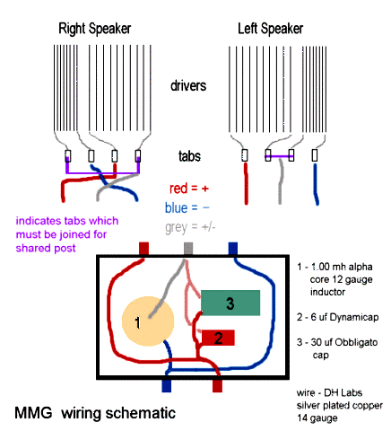

I've had a pair of Magnepan MG-12 sitting here for over a year. I have to redo the goo holding down the wires on the right panel because I'm getting some buzz out of it on bass-heavy material. While I have it apart I'm going to redo the XO and probably set them in wood frames while I'm at it, basically do the entire Peter Gunn approach. I found his original XO schematic posted on the IA/MUG forum, which was based on the SMGa. However, many of the Magnepan models had parts selected to tailor the crossover point to that particular panel, and of course the PG parts list was an ever evolving work in progress. Also, I'd like to get a clarification on the below diagram because it doesn't make sense:
First, why is the panel on the left shown as "right speaker" and vice versa? I suspect it has to do with flipping the panels but I still can't get my brain to understand it. Also, where is the resistor for the tweeter? PG quite clearly talked about using a single resistor there.
If anyone has a recent schematic and parts list appropriate to my panels please DM me.

The drawing is a picture of the wiring as viewed from behind the speaker.
An attenuator resistor would be placed in series with the tweeter (blue wire going to the panel).
I don't believe PG's crossover mod was based on any engineering. I would leave the stock crossover as is unless you thoroughly understand the speaker's design.
You may be interested in my article on Modeling the MG1.6.
Ed

Thanks for the detailed info Ed, it's very appreciated.
I'll have to review my convos with PG to be certain but what I was given to understand is that he had a friend who would model the crossovers for him in software. He called him his "CAD guy" and they'd been collaborating for a number of years. PG tweaked the parts values for certain speakers - and some panels like the 2.7 I believe required some re-design since they offered a midrange section in addition to the bass and treble of the typical Mag - but otherwise the crossover was the same across all the models.

I spent a lot of time experimenting with resistors. My conclusion was that Magnepan got the stock response right.
The parallel crossovers in the MG12 and MG1.6 are very sensitive to the amplifier's output impedance. 0.5 ohms of output impedance will boost the midrange by 1dB. The crossover works properly with near-zero output impedance.
Harshness is due to tipped-up treble in pop music recordings. Classical music recordings can have "bite" in brass instruments and "delicacy" in string instruments, but the sound would not be described as "harsh".
