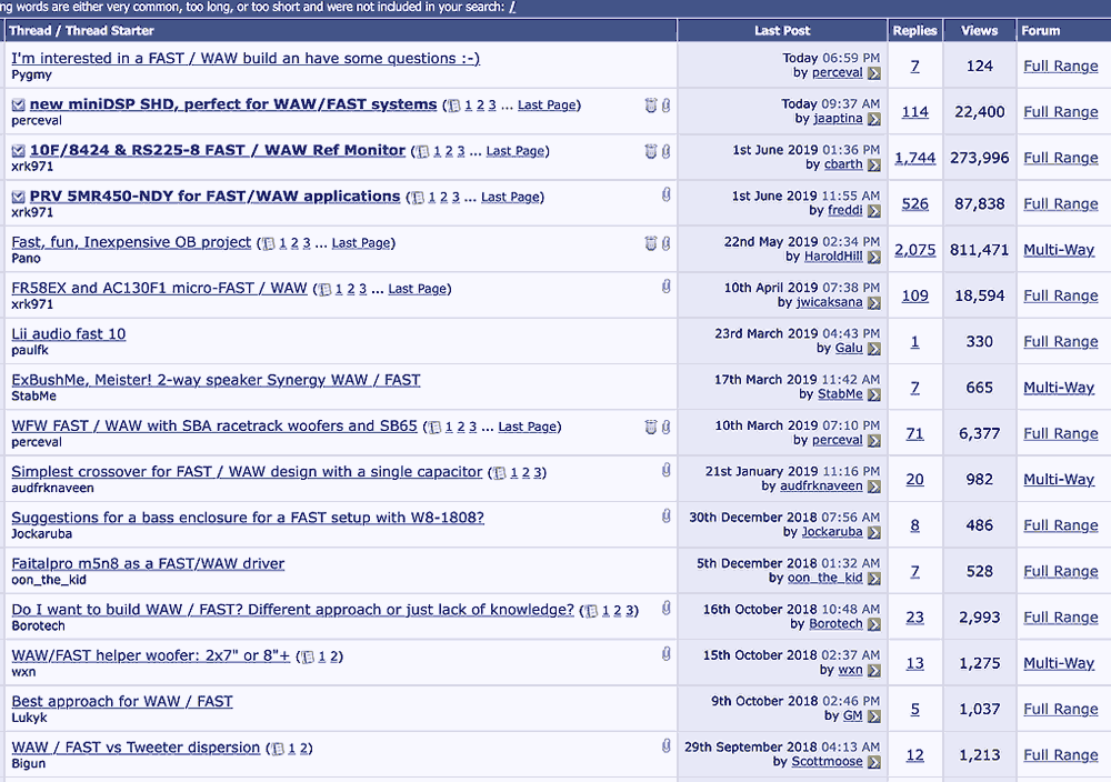

Do you have links by any chance?
It's pretty hard finding them browsing either the multiway section or the full range section!
There are so many threads and so little I find (by reading the title) that are WAW specific..

Use google with keywords diyaudio, fast, waw, to get more presentable and easier to search threads.
Loads of threads in here about the subject.

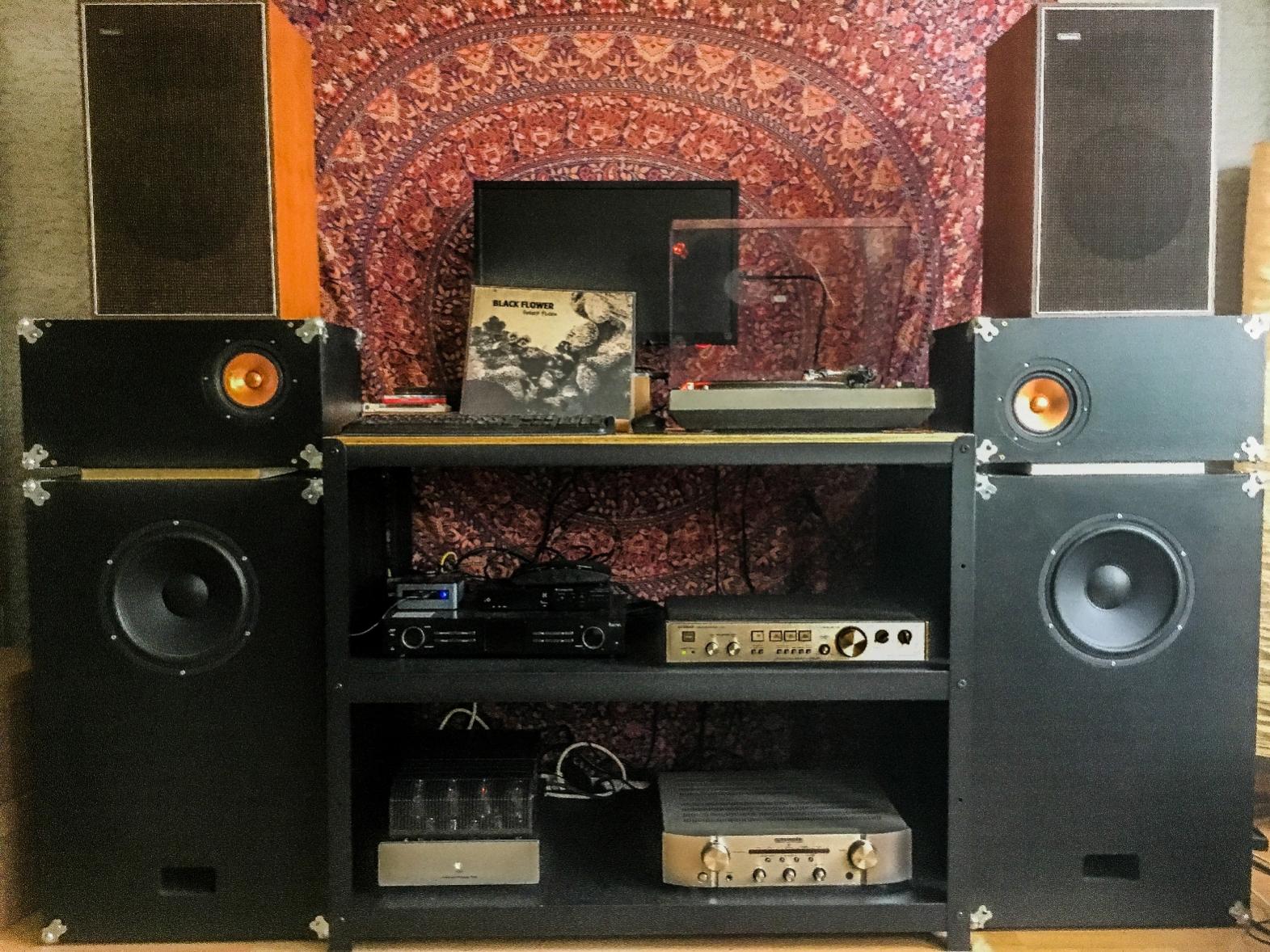

i'm doing it 2 way, with an Alpair 10M gen3 driver and a Scanspeak SCAN-SPEAK 26W-8534G00 in a ported box, and that works very good. The CR is 1st order at 180Hz. I'm still building the final version (first used tops that were build to work on their own and did not integrate like i want it), but even with the actual tops, it sounds way better than i expected or heared in other expensive speakers.
Some suggest i should use a filter (as the 10M starts to fall at 15K), but i use a zorbel to reduce the impendance peaks and make the slope of the fall less sharp. Like this you still got those high frequencies, but slightly less powerfull than with a tweeter calibrated flat (wich i like).
But as long as the CR is out of the 300-5K range, it's good for me. Sadly most speakers have their CR point in the middle of that.
I don't biamp, and my woodworking skills are not as good as yours. This is how they look now with the not fitting top with an Alpair 10M, but i'm building a new top (waiting on delivery of the last parts) ... The subs are 150L ported boxes tuned to 25Hz with one 10" driver. They are amped by the Prima Luna Prologue amp on the bottom of my rack. The speakers on top are my beloved old Goodman Mezzo SL speakers that are amped with the Marantz amp, both feeded from the same Luxman preamp.
The crossovers are now temporally in wooden boxes (from leftovers) on the back of the sub, but they will be integrated in the seperate top section that i'm building now. The tops that you see now are ment to be used on their own (with a port on the back) and are my first own design, and are still a joy to listen to (due to the good driver). now they measure rather flat (within 6dB) from 25 untill 15K where the slowly fade out... I'll may post a picture when the new tops are finished (if i don't forget it)... All is own design (designing the speakers is half the fun for me).
EDIT: pic is up now...
