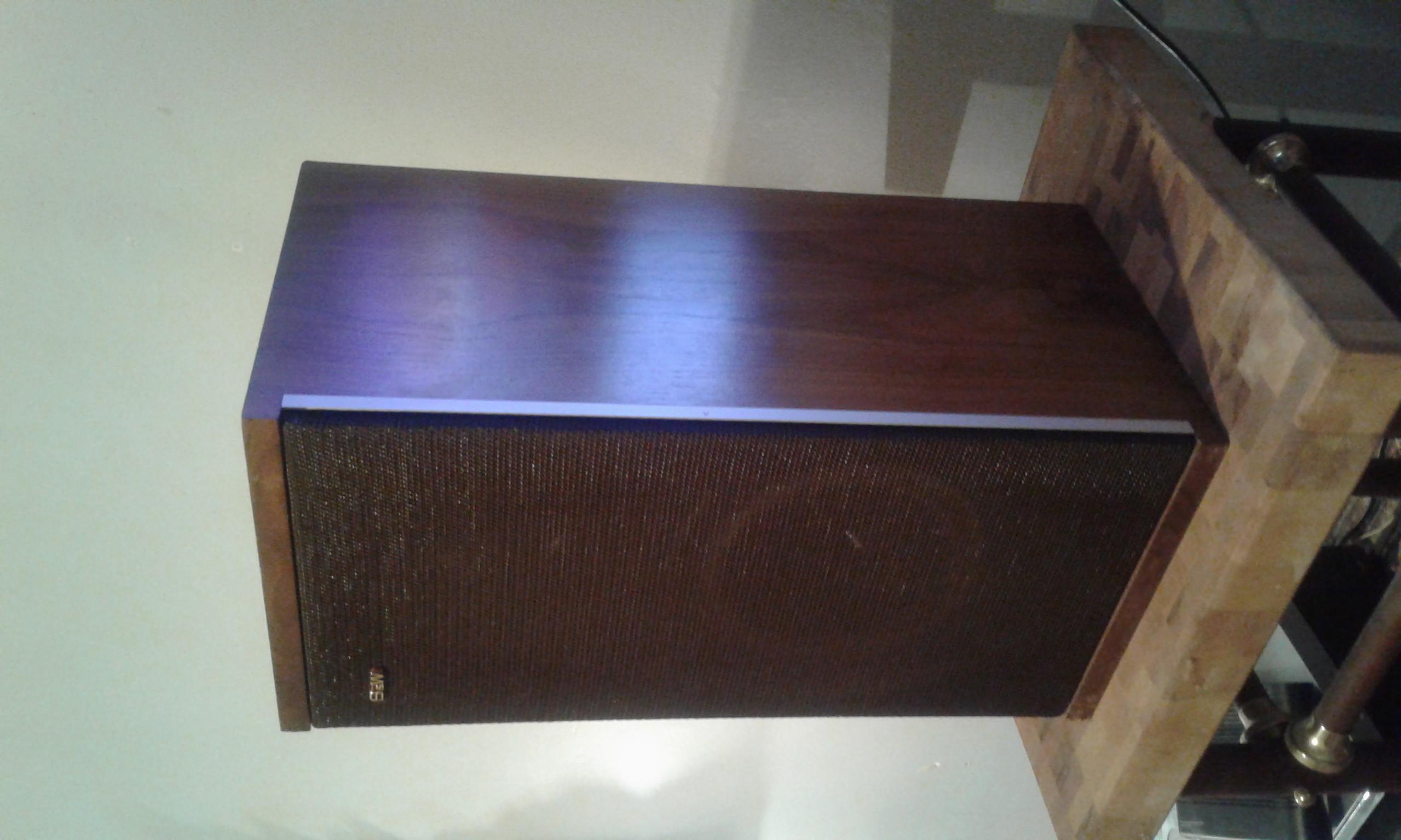

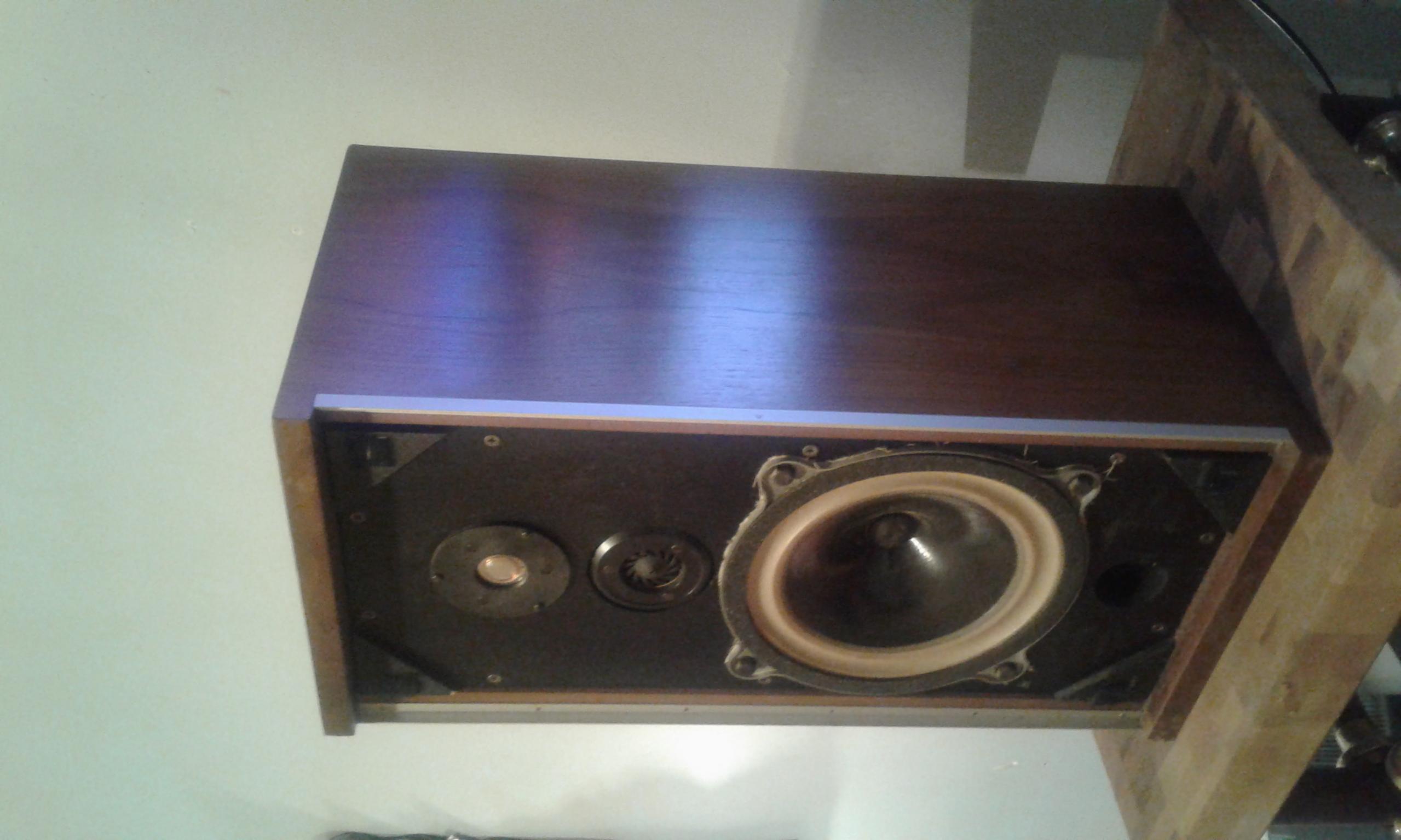

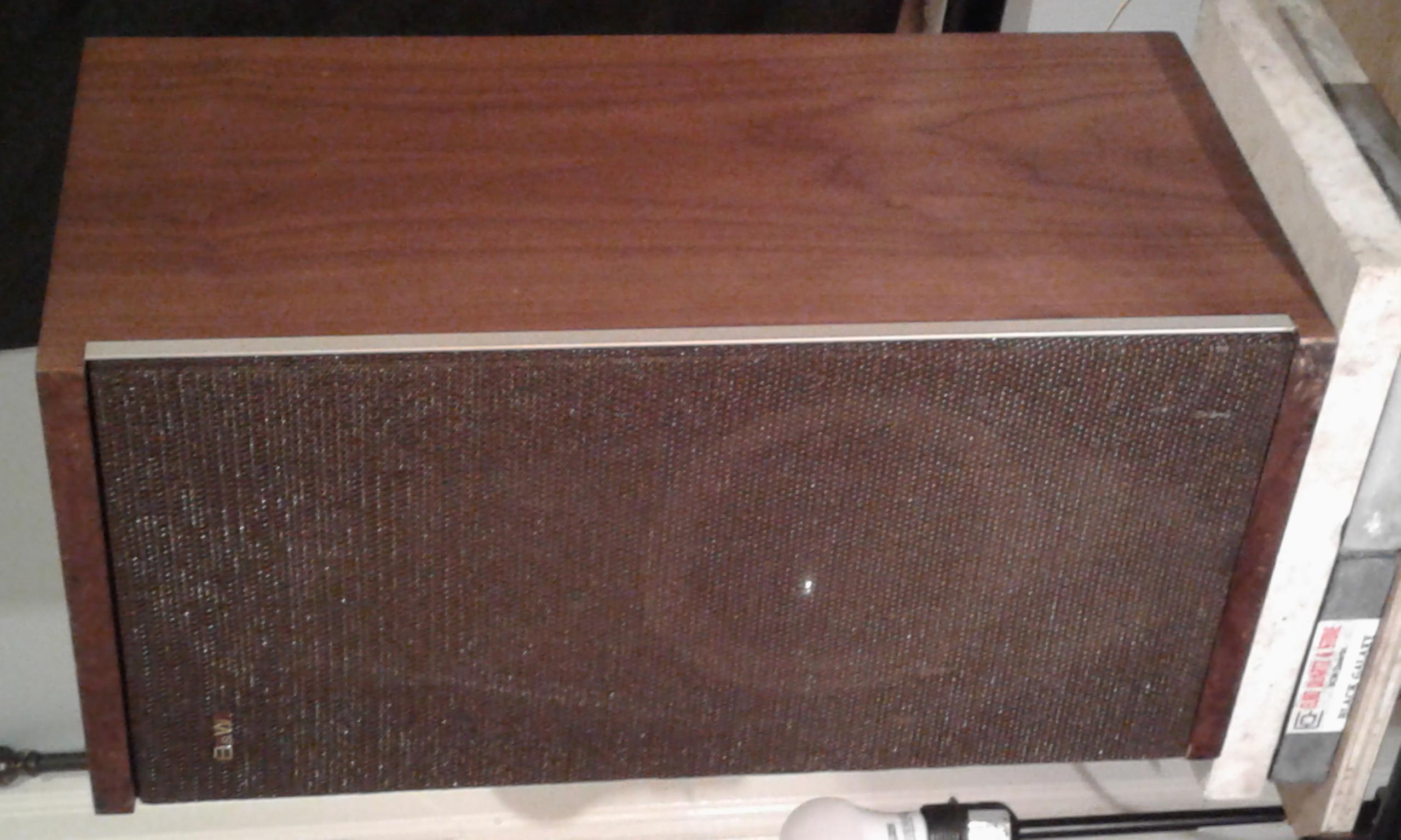

Everything seems to be intact. Even the old school looking B&W logos. I haven't cleaned or oiled them yet. Could do with some stands.
Appologies. I tried to flip them back over. Darn phone.

Don't change a thing.
If you must mess around, keep these as a reference and play with something that's not working right, or that you build from scratch.
This is a fine implementation of some very good, if a bit unusual drivers.
Kind of a smaller Spendor BC1. See Troels Gravesen's study of the Spendor and particularly the 1300 tweeter(the lower one).
I have the 1300s in Celestion Dittons, and they are something special, ColesAcoustics still make a version of them(and that supertweeter) that I plan to try sometime when budgets allow.
If you want to make these sound better, work on your room and placement, add a bass bin or sub for the bottom end.
Leave these as they are until you have made a few speakers better at this size than these. The only thing that will hurt those caps is frying them with a soldering iron.
Enjoy them. And enjoy messing about with other stuff(that doesn't work right).
