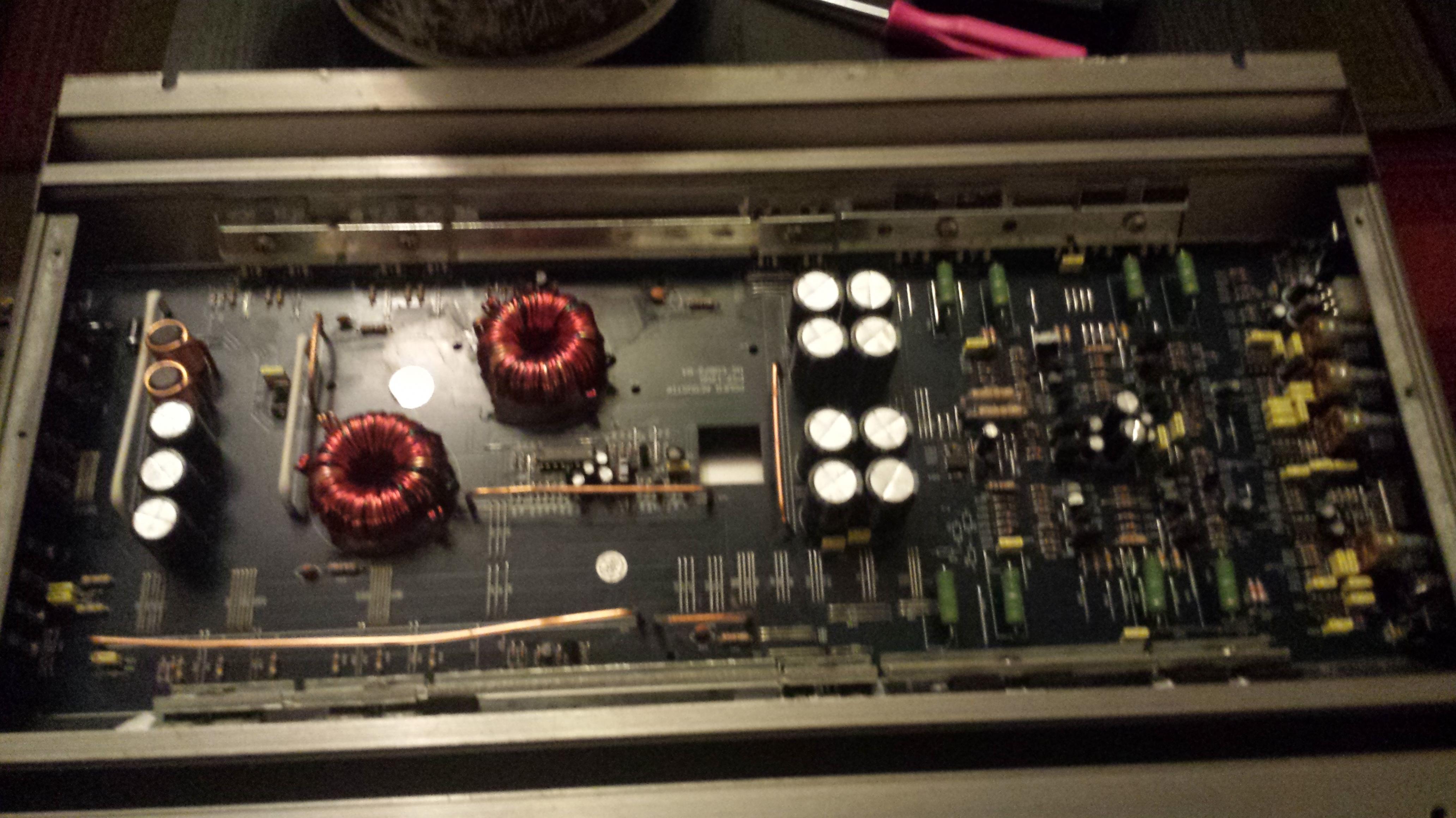

I have a 1200watt amp car amplifier that i plan on using in a car , that i plan to pretty much gutt and up grade the parts or beef it up .
I have some plans for it but just wanting to make sure everything is going to work as i think please help !
I plan on changing out the heat sinks and adding upgraded / bigger and better ones .
I plan on changing out the capicators it has small stock one i believe sapcon 150+ . Im thinking about using 3900uf 160volt snaps . Will they work ?
I need recomendations on good transformers i can use .
And im changing out the mosfets from 50n06 to t20s of possible .
Post a good quality photo of the amp that you're going to modify.
Thanks so much for your response , please continue to help me if you can and i posted a photo please let me know if your not able to see it

For my reference TS1440.
I'll start by asking why you're doing this? These amps are inexpensive and buying a second one *(using both amps) would give you more power than modifying this one.
