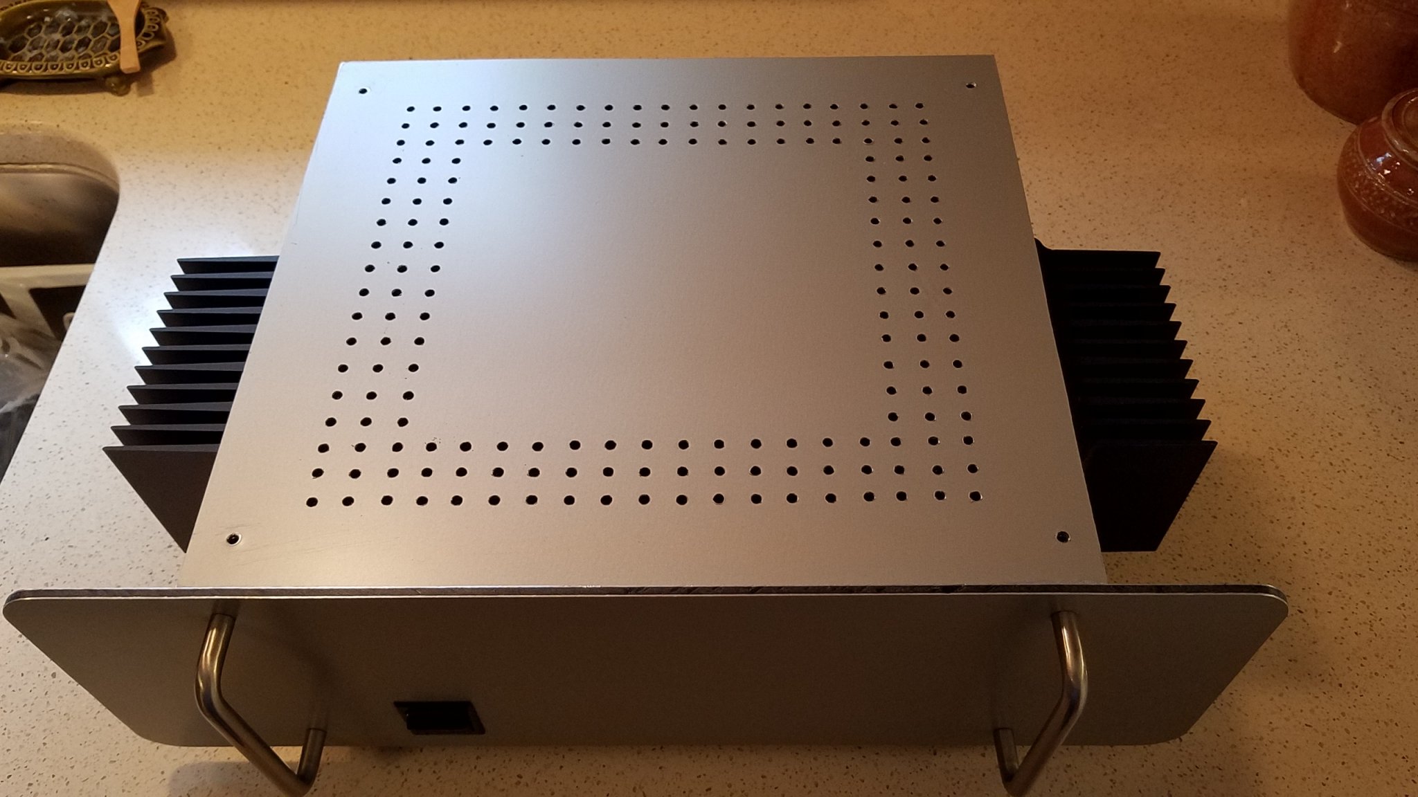

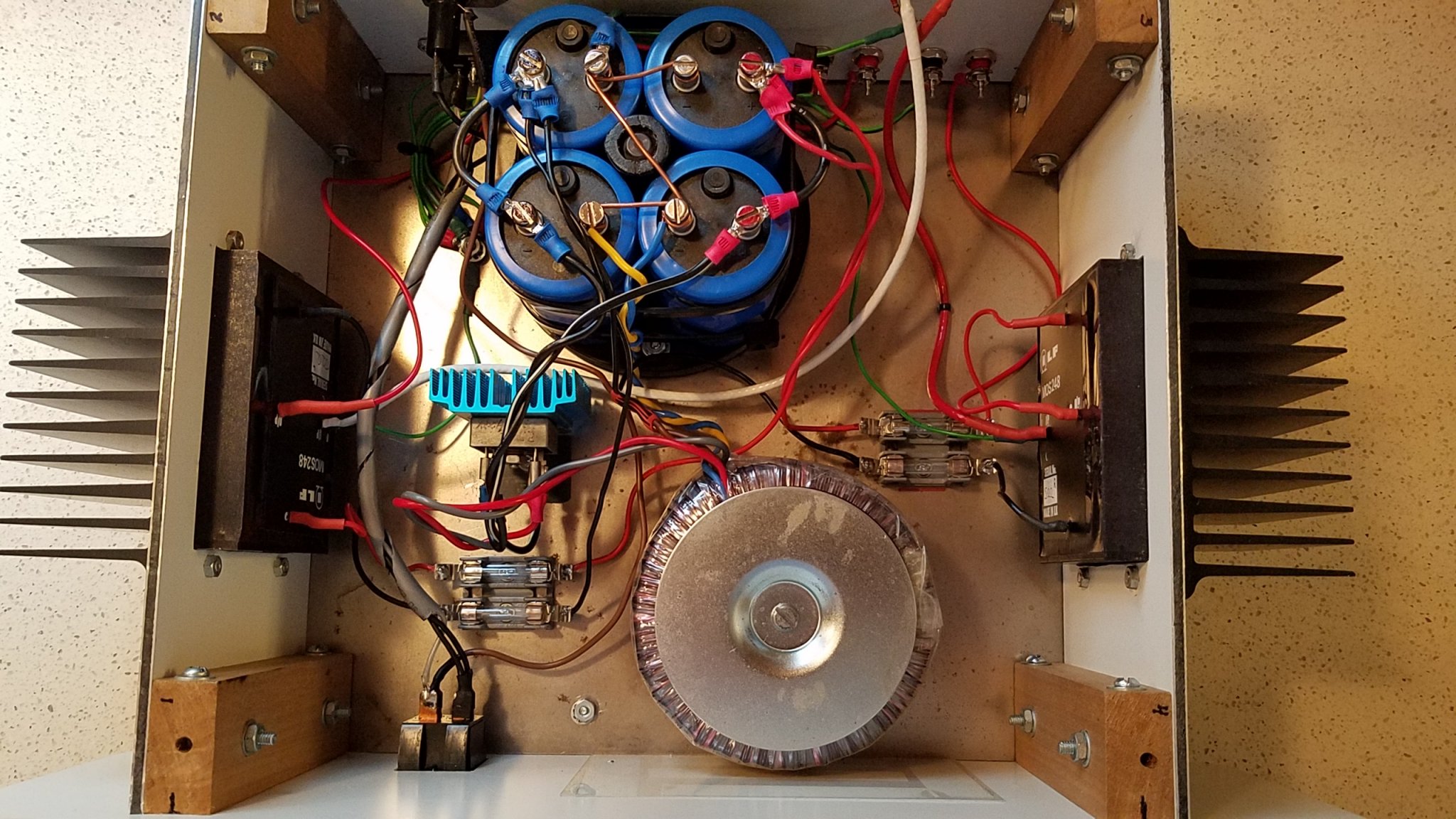

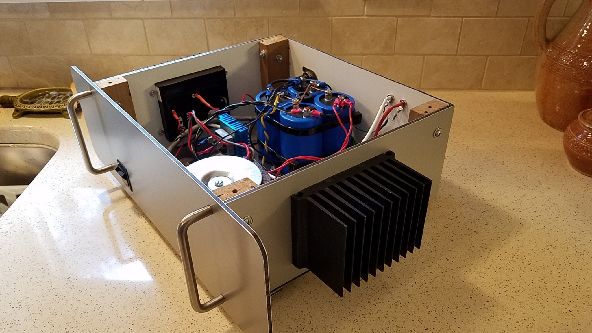

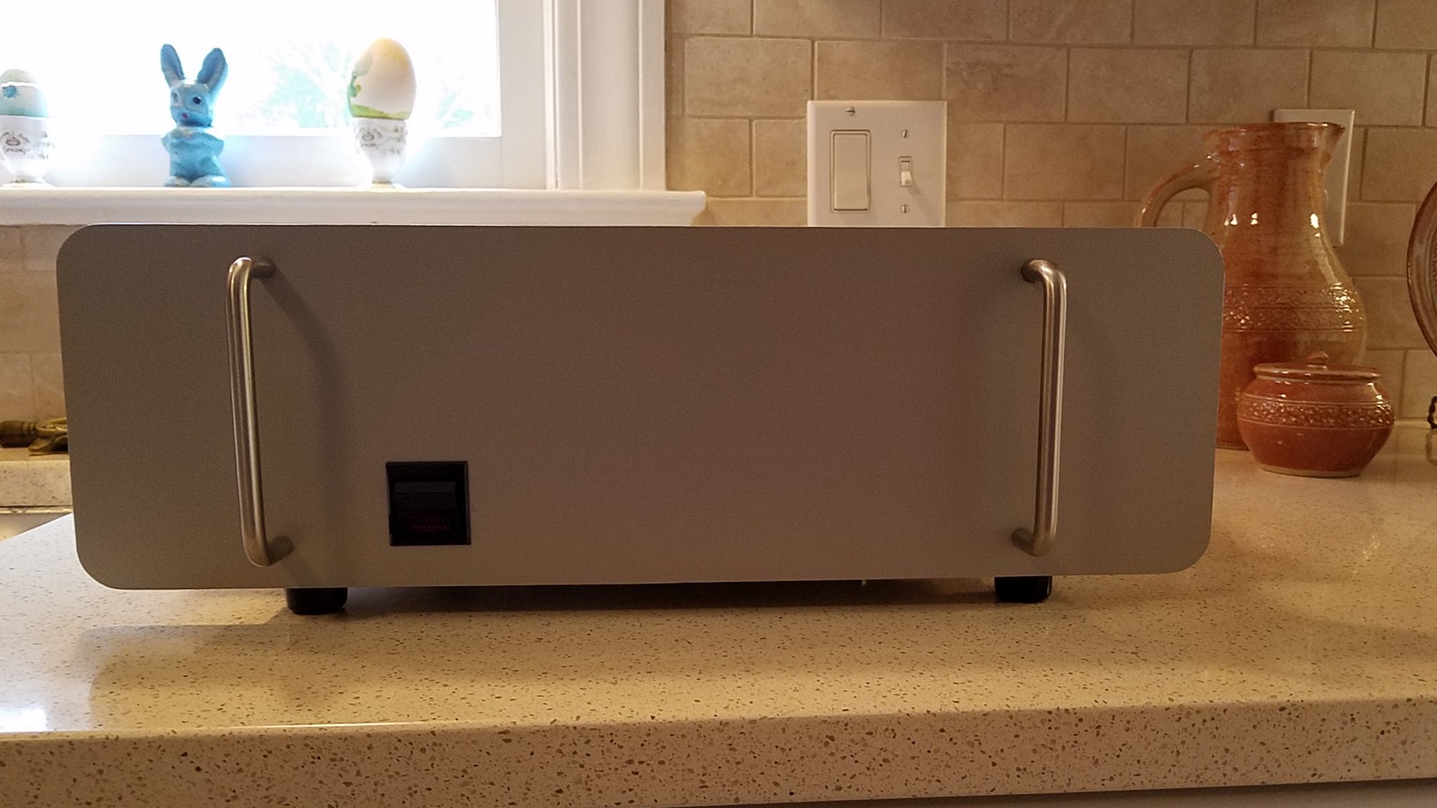

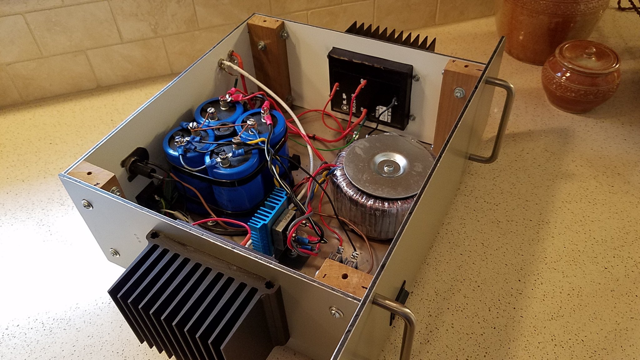

I purchased a pair of ILP MOS248s, in London, in the early to mid 80s. I never had time to build a power amp until full retirement and Covid-19 isolation afforded me that time. I made the enclosure from aluminum laminated building cladding. The toroidal transformer and Sprague 10,000uf filter caps were also purchased from Henrys Electronics Ltd.
The end product turned out better than I expected. In my 72 years of owning, Sherwood, Kenwood, Pioneer, Sony, Marantz, SAE, Carver consumer audio gear, I am blown away by its sonic quality. I have played it thru my AR-3As and my Klipsch Chorus IIs. The MOSFET output drives them to produce powerful bass, clear midrange and crisp highs.

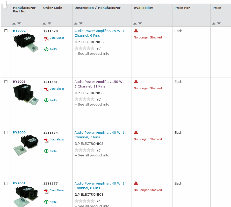

ILP modules have been searched for for ages. Great idea, but not serviceable and no discrete replacement. There ought to be a law.
