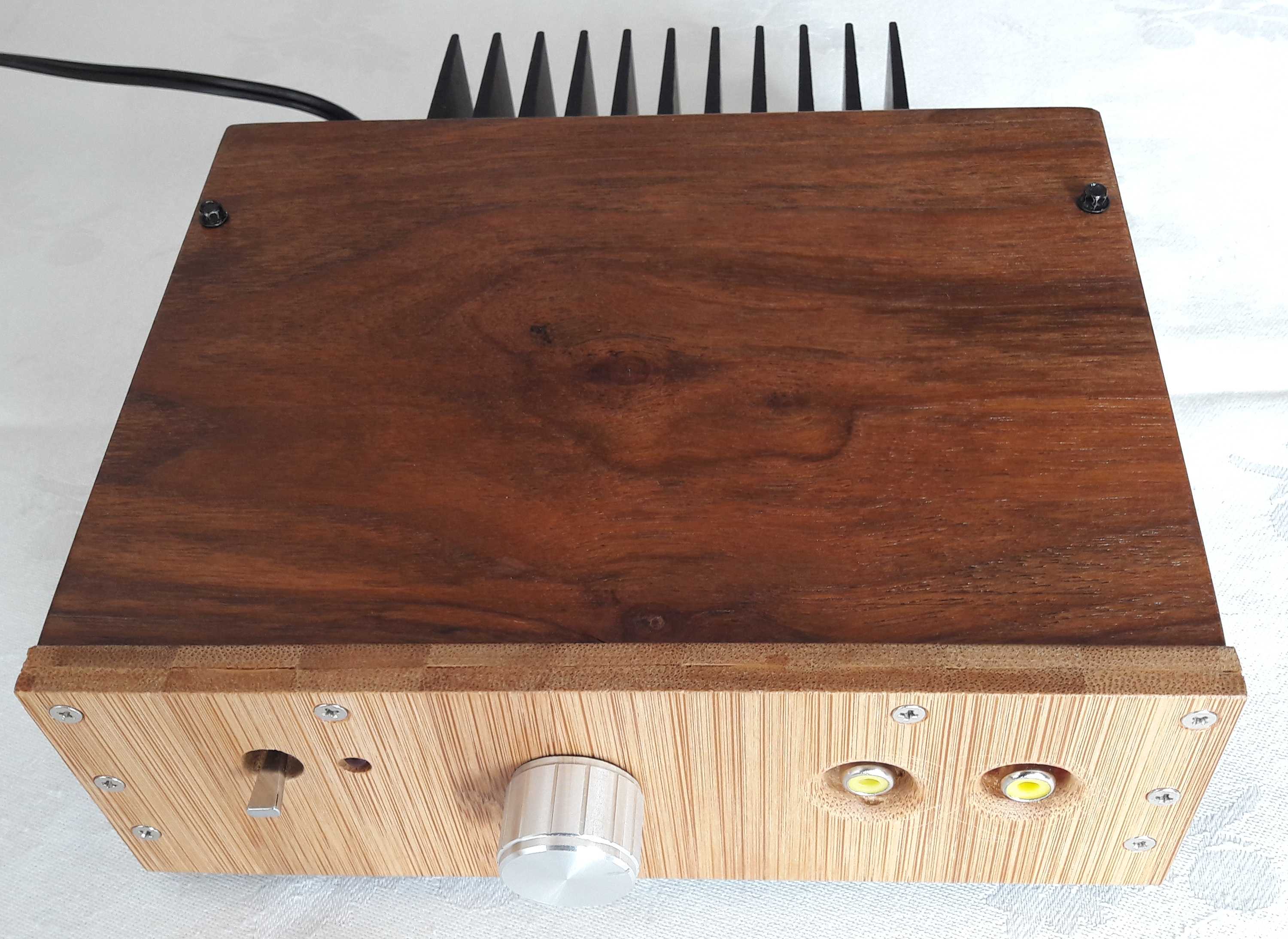

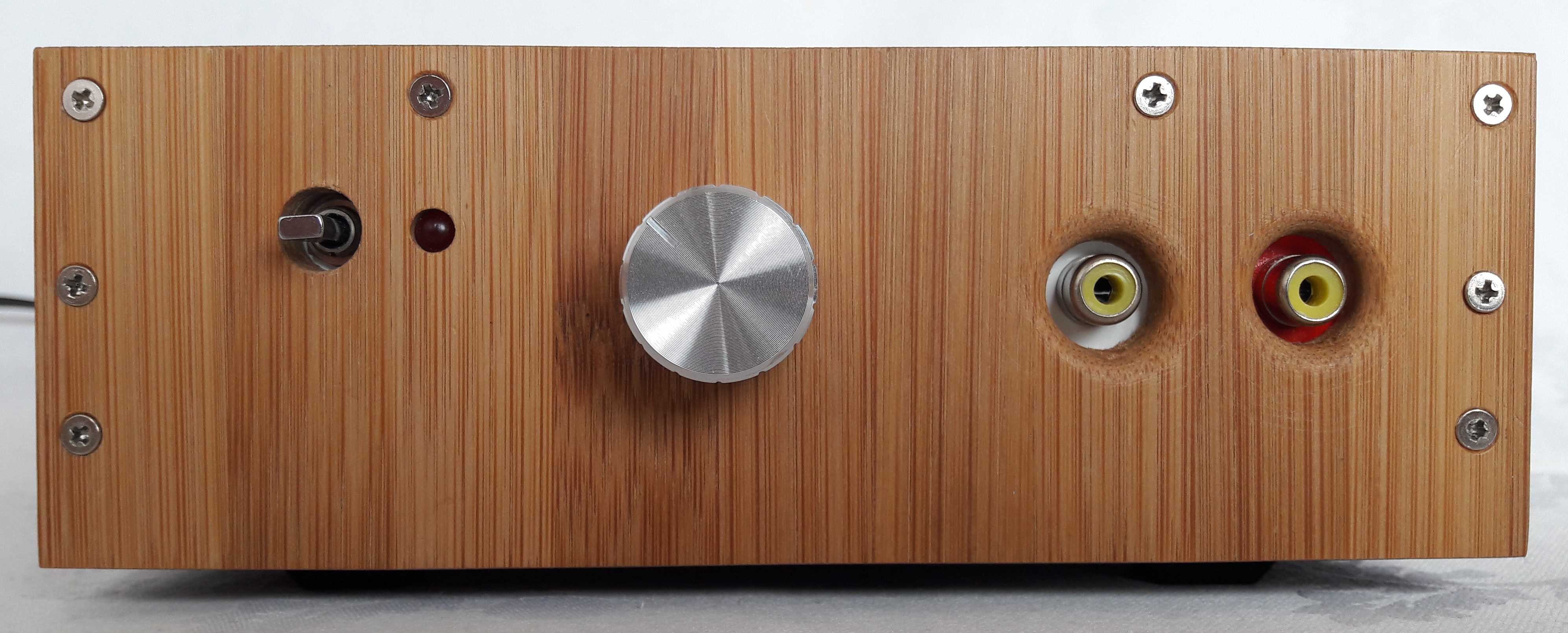

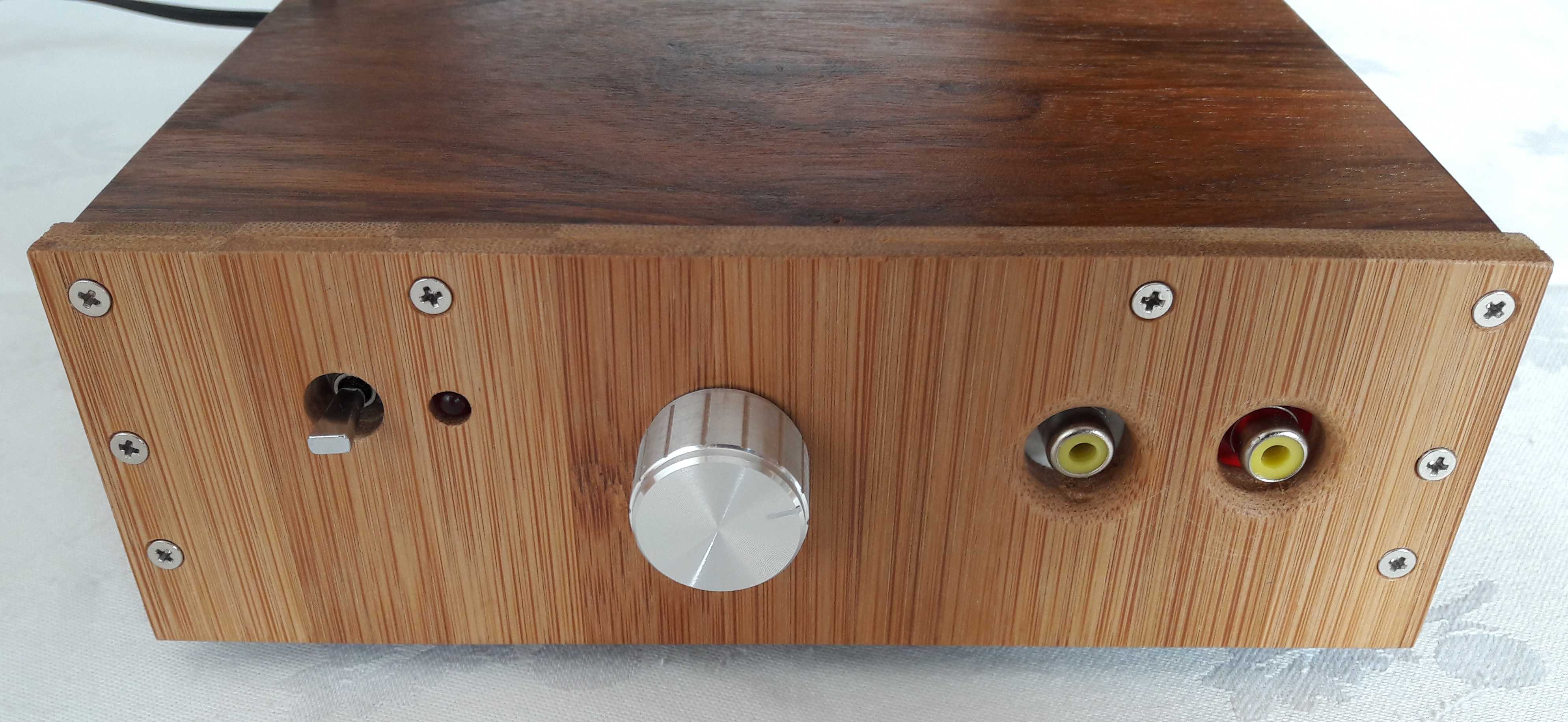

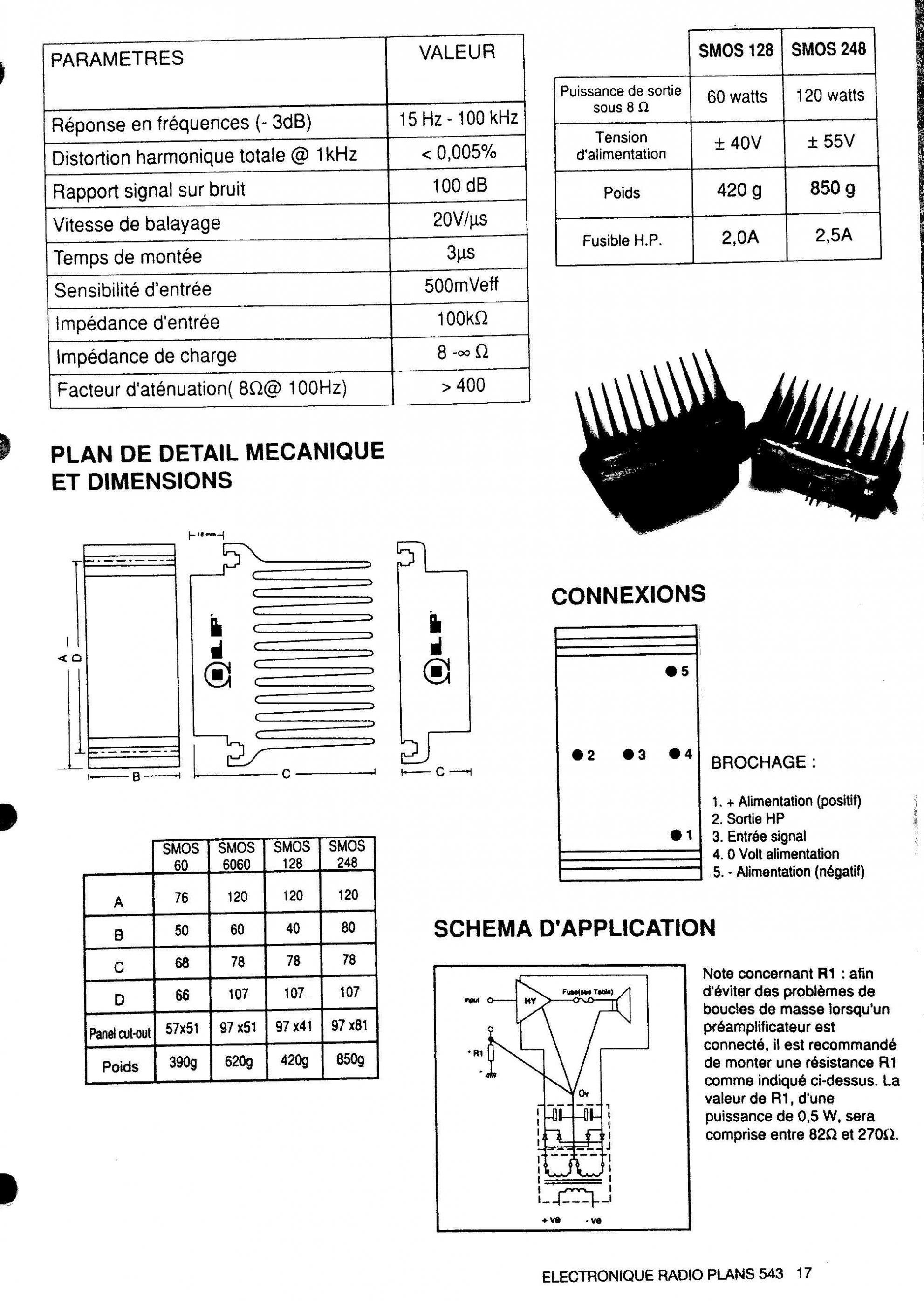

I’m still using one ILP module as monoblock amplifier (bought it in 1993). More specific the SMOS 128, it sounds ok, no hiss at all.
I’ll post some pictures here or in “Chip Amp Photo Gallery”.
Attached are the product specs.

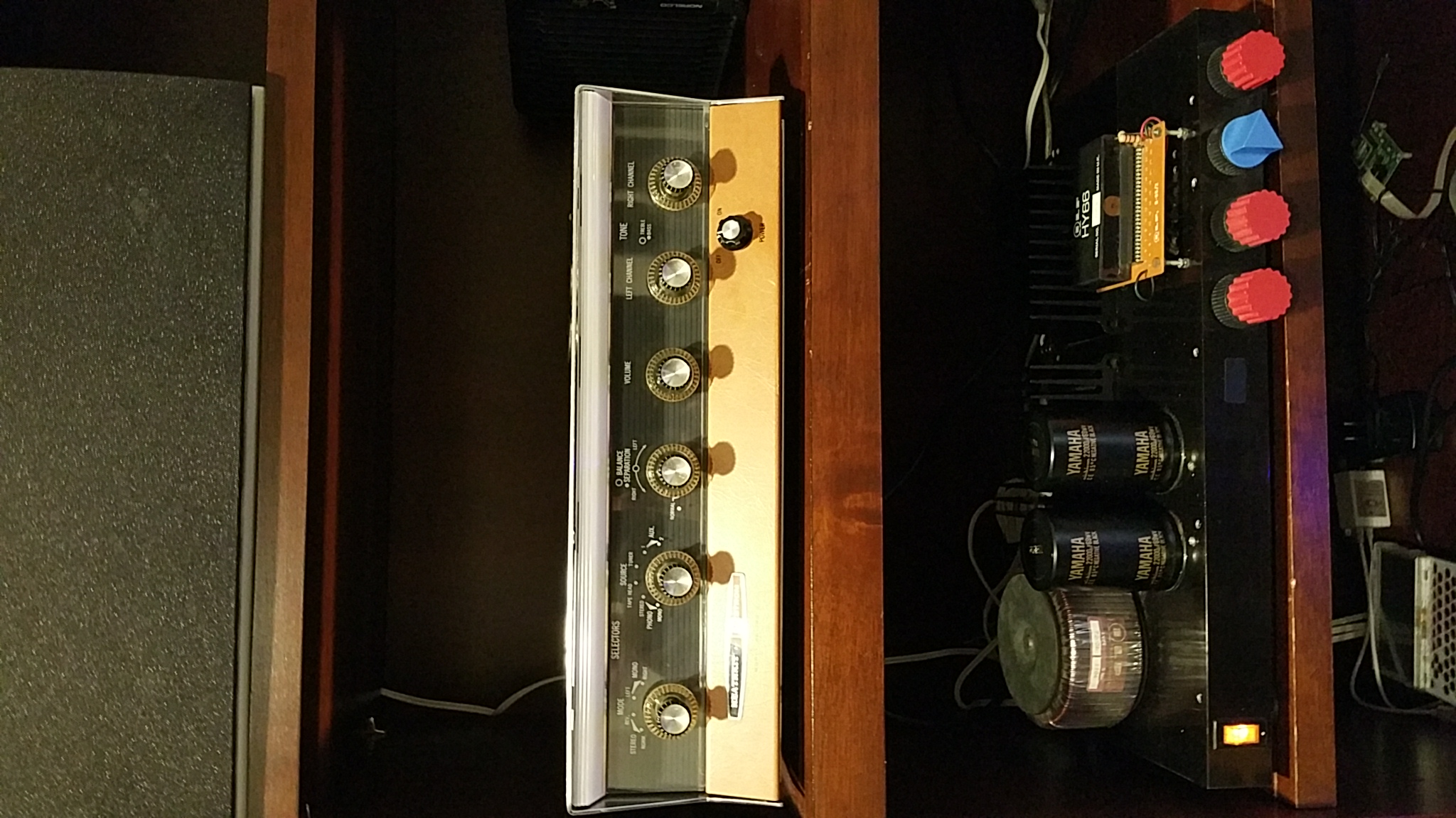

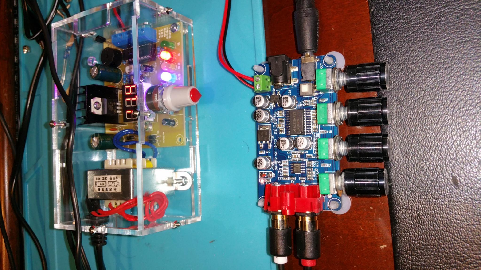

Here is my update.
I disconnected the HY66 preamp.
Then connected the signal from an external USB 5.1 Channel Sound Card Adapter to the new Preamplifier with LM1036 + NE5532. (This arrangement works well with the Heathkit-DAYSTORM Model AA100 Tube Amplifier), but this was not good for the ILP MOS 248 Module. It was distorting too much.
So I removed the Preamplifier and fed audio the signal directly from the external USB sound card to the ILP MOS 248 input. This produced very clean audio output -there was no hiss or hum. There is no listening fatigue.
Bottom line I did not need any pre-amplifier! I will look into adding a tone control using LM1036.

Keep in mind that the ILP modules are extremely fussy about signals and grounding. If your LM1036 preamp has any issues in that area, expect the ILPs to complain and generally be unhappy. Your less complicated hookup from the USB sound card would have less chance for those types of problems. Your existing "preamp" should work perfectly once you have the signal and grounding issues resolved. Only you can do that because you have your stuff in front of you.

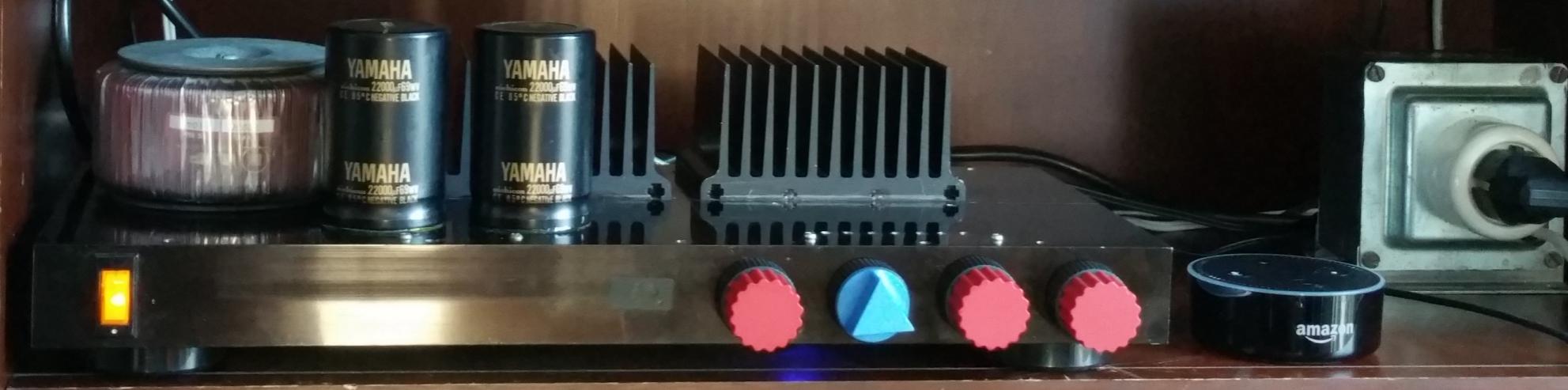

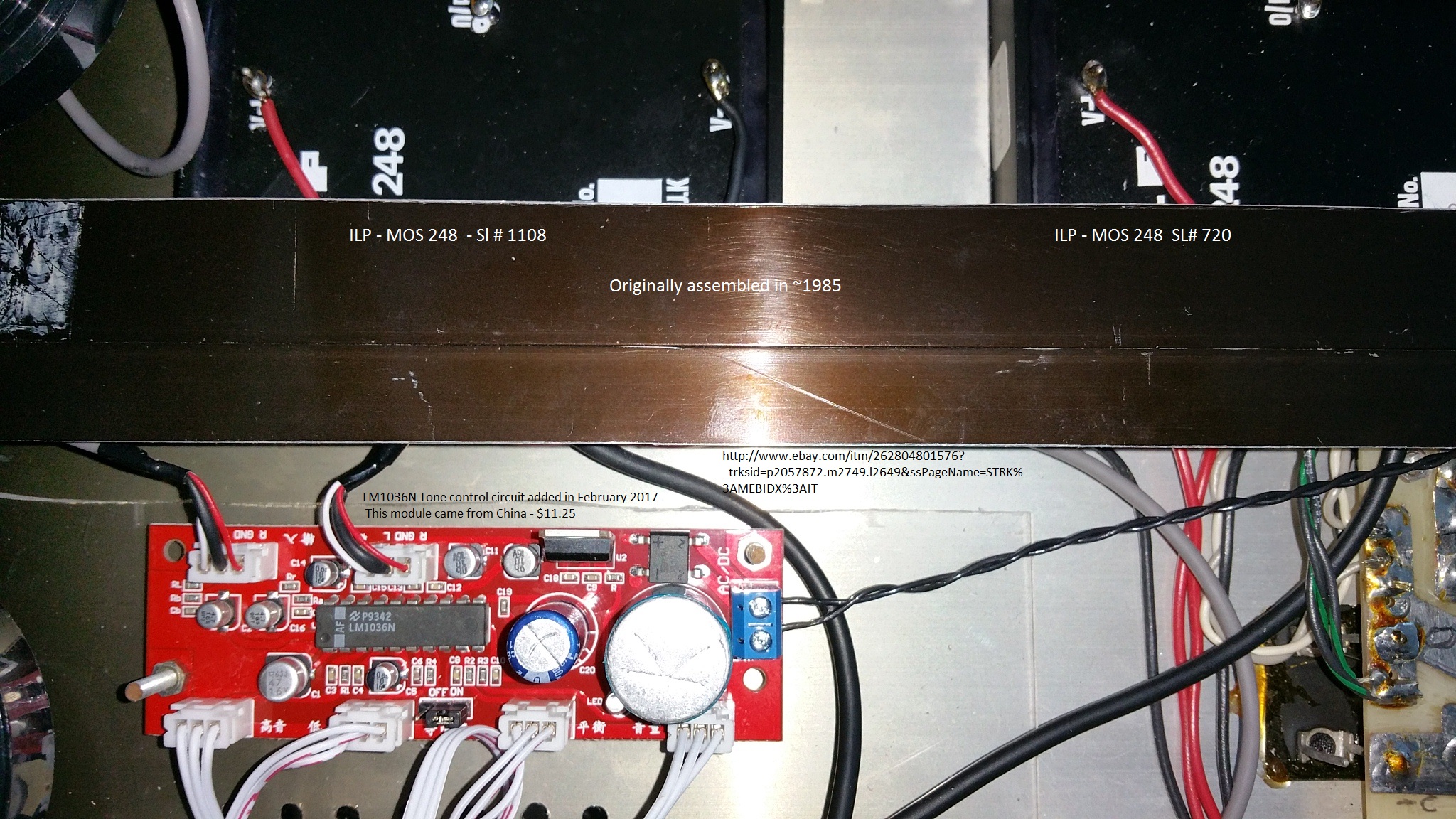

The LM1036N based Tone control module works well with the ILP MOS 248 Modules. I was able to find one with the potentiometers not mounted directly on the tone control board.

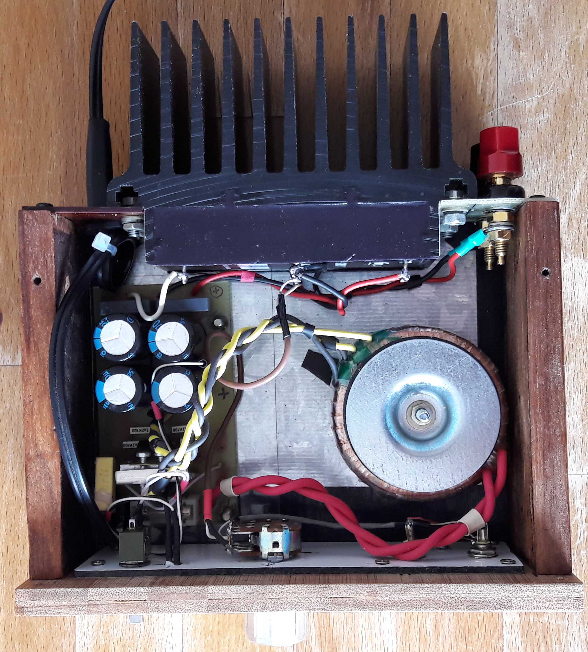

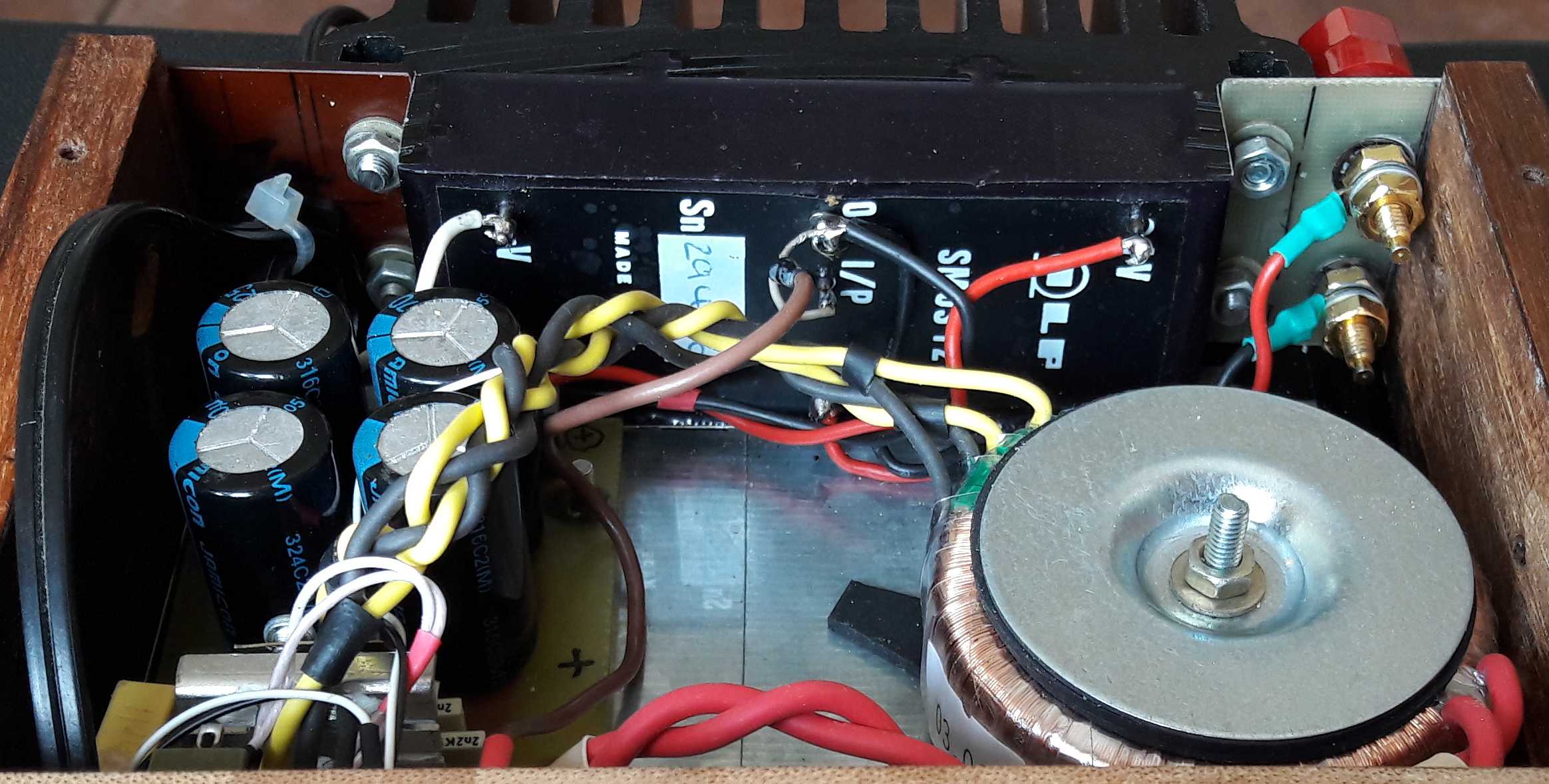

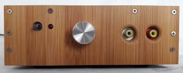

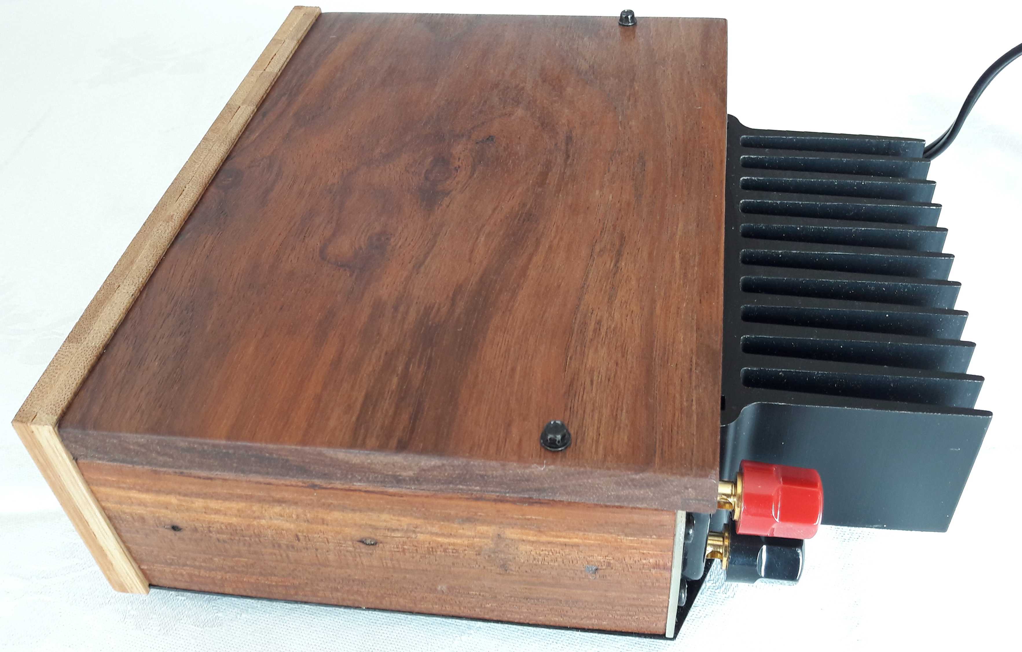

Recently I've took some inside pics...
I'm using it in a small office for background jazz and the sound is surprisingly good for a 20 years old design amp.

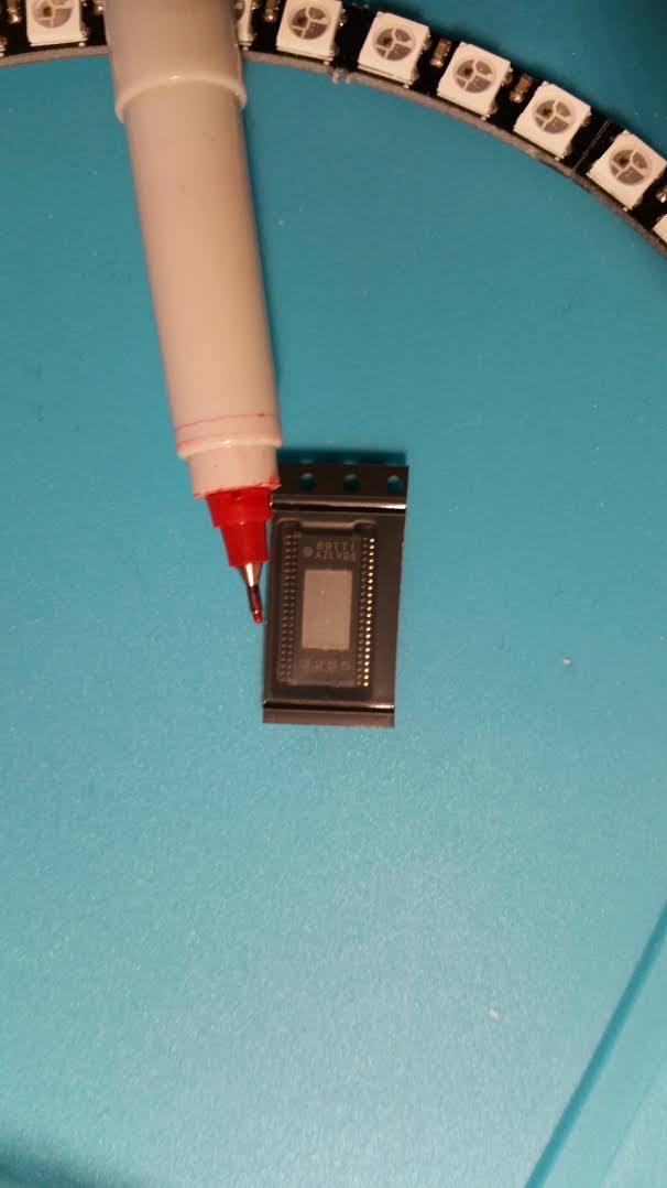

Nice Thanks for sharing the pictures. These modules last long if treated well. Sad they are no longer available. National Semiconductors used to have Linear power Amps chips ~120W. After Texas Instruments bought them, the linear Power Amp modules were eliminated. Now only class D amplifier chips are available. They are so small, it is hard to work with them.
