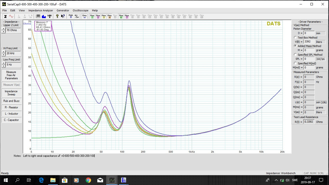

I have a bunch of 100 microfarad caps made in West-Germany! I will try adding those as the drivers start to flap about probably due to signals below where the port is loading the driver say sub 60 Hz or so.

Well if I look at it from a strictly electrical point of view the 600 uF does nothing above 30 Hz and the cone flaps just as much as with no cap. At the other end 100 uF cuts in at 100 Hz or so.
Judging from the impedance graphs it looks like something in the order of 200-300 uF should work out. I have to measure accoustic response and listen as well. The cap also adds phase changes and that should change how the driver and port interact.

I looked at the nearfield response of the cone. The ideal would be that the cap does not affect the cone output above the port dip or the port dip just cut away cone motions below the cone dip.
Below are the graphs the first is the original the second has the responses normalized to the capless response.
The 100 uF (Blue) cuts away to much. The brown-red-orange (600-500-400) has small effect on the cone output above 50 Hz but not much protection below that either.
The green at 200uF looks like a resonable compromise. I think I will try to measure and listen to 200 and 150uF to balance reduced cone flapping vs bass output.
Just to complicate matters, should I test an even smaller cap for cutting out deep bass then need to have the baffle step filter and peak trap reinstalled...

I got a good lesson with filter design that graphs are useful but they do not tell the whole story by far. In the loudness range that they reside most of the time they sound better without the peak trap and baffle step. So I let them sound more strident the few times I play them loud. I have other speakers for that😀
