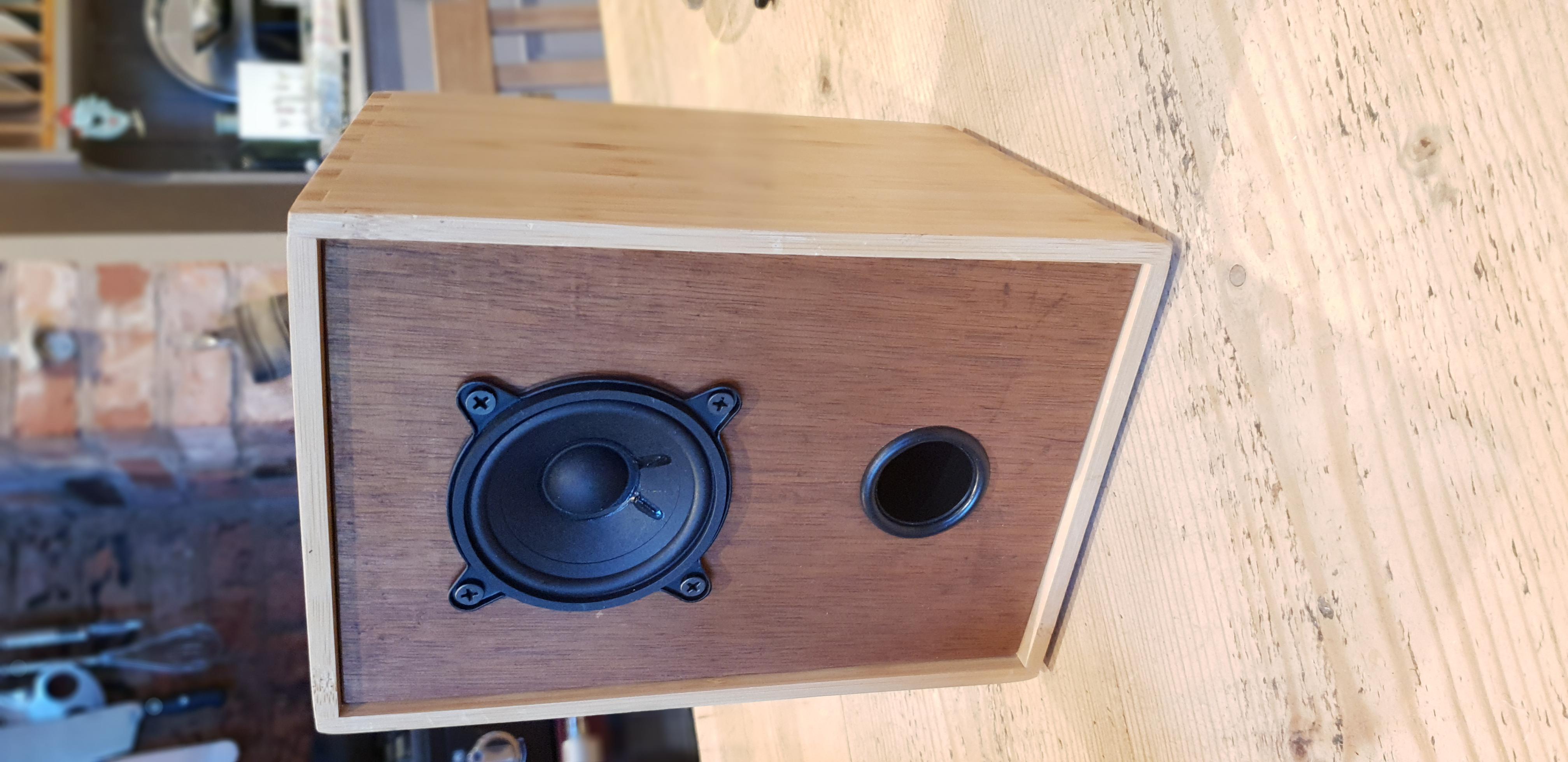

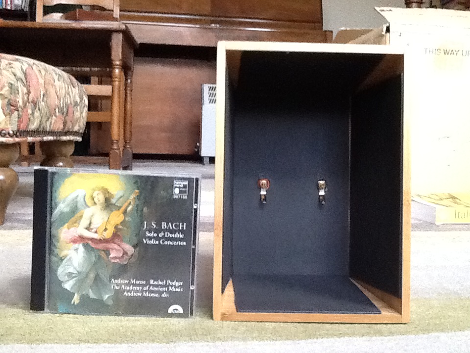

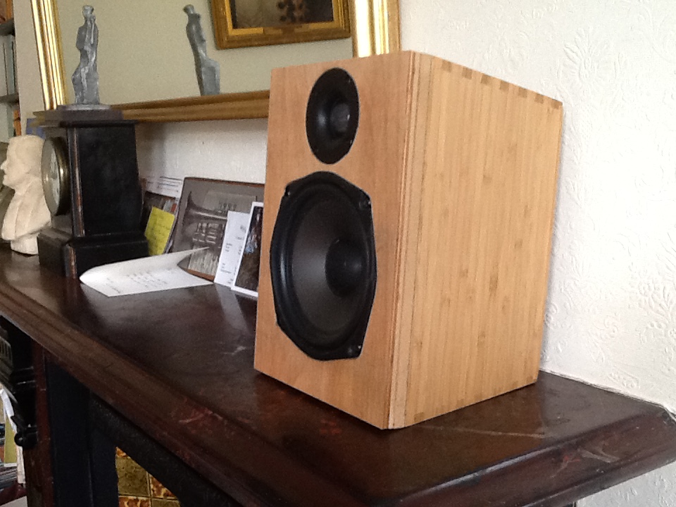

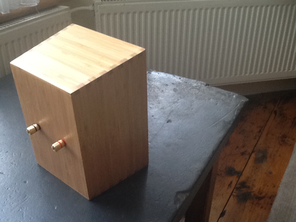

Nice project. I use the small variara with Faital pro 3fe22. They sound incredible for the money.
Initially I lined with plywood but they started to rattle loose. They are lacquered so you have to remove this to glue to the bamboo.
Now I just have them lined with bitumen and wool and a bit of polyfil.

They work particularly well as a desk top, because of the backward tilt when you put them on a flat surface.
I just managed to make a very small 2 way with the smaller box.
Thanks for the tip! Will sand the insides to remove the laquer.
