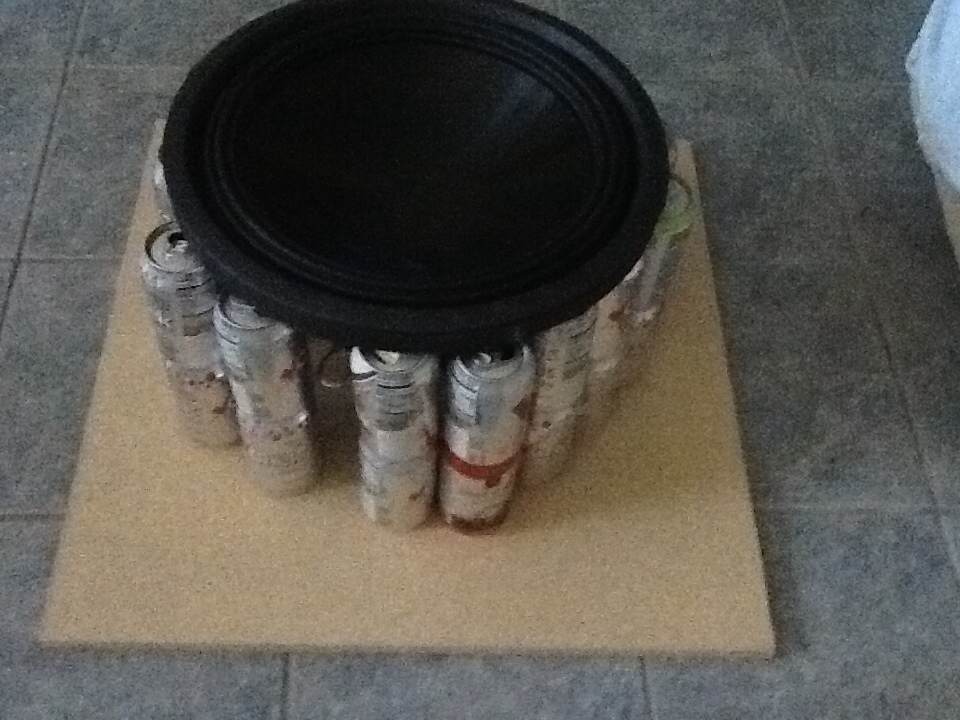

Perhaps we can make a product that is mostly air core but gives the end user an option to fill the voids with sand. Would probaby negate the low-weight aspect 🙁
I am experimenting with other ideas. Here is a mock-up using soda cans glued together. Perhaps the rest of a cabinet can be cardboard but pretty sure the heavy driver will need to be mounted on a piece of board like the current base shown.
Even more amazing is that of three cats, no one has knocked it down in twelve hours !

I found a product similar to Greebster's in #25. I got "Soft Linking Mats" at Lowe's. I am experimenting with making a CLD (constrained layer). Many other builders do it by using (say) two sheets of birch and/or MDF between the viscoelastic layer. I've seen everything from Green Glue (Goo?), Titebond II, regular silicone, etc. promoted. I made a test join of the "Soft Linking mat" between a piece of plywood and a ceramic tile, using Gorilla Glue. Sticks fast. Also used is bitumen (asphalt roofing?) sheets or pads. I think these just add mass, for damping. BBC promoted the use of those in their speakers.
The above methods are well adapted to DIY because so far as I can tell, you can custom cut all the pieces as needed for size, openings, etc. I think it is important that each panel be not tightly joined to the next. I am unclear on how stuff is joined, in that case, maybe just the outer layer?
For testing purposes, I am wondering thus: for a CLD, must both panels be full sized, or could it be a mosaic of smaller pieces (say, smaller tiles or scrap wood?) I recently built a 24" cube sub using normal materials (so far): MDF and ply. I'm wondering if I can test a single panel of "composite" at a time to see how it works?
This stuff is all confusing: for a subwoofer the goal is to push the resonances up out of the low bass. For a normal woofer the goal is to push the resonances down below the passband. Somes times I regret giving up drinking
