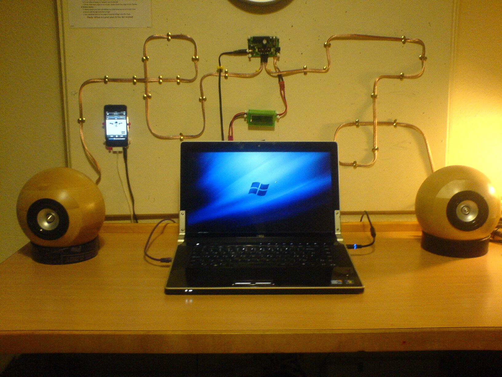

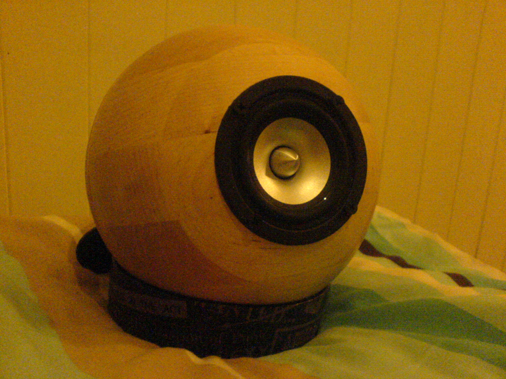

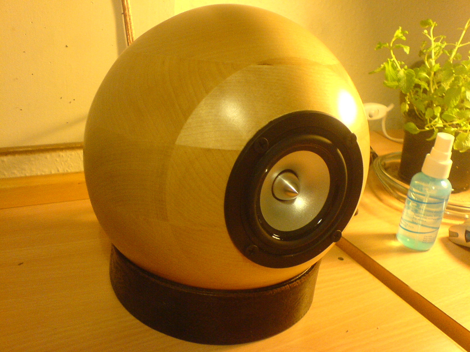

Hello there all. I have built the ikea bowl speakers (see below). They sound very nice indeed (aswell as looking very sexy compared to normal box designs).
now I am willing to look into adding some strength to the bottom end. but being in a student room, I am looking at subwoofers from an incredibly reserved way (i.e. i would only be interested in low power compact subwoofers)
The route that I am looking to take at the moment is to use a PA type driver, and maybe a subwoofer amplifier from a car (as i have a high power 12v supply avaliable and it would keep costs down.) Idealy i would like to avoid car amplifiers as i am so happy with my amp 6 from 41hz.com for the mains. What is the standard way round adding the channels together and cutting the high frequencies before inputting into a diy-type amplifier.
How much difference will choice of amplifiers make to the quality of the music? as far as i am aware it is less of a problem at low powers and low frequencies.
so hypothetical system as it stands:
-tangband / ikea bowl speakers driven by amp 6 (finished already)
-8 inch PA speaker (undecided)
-sealed enclosure (perhaps the larger ikea bowls ?)
-driven by a low power car amplifier (for the low cut and bridgeing ability)
any suggestions to improve that, driver suggestions, amp suggestions, enclosure suggestions.

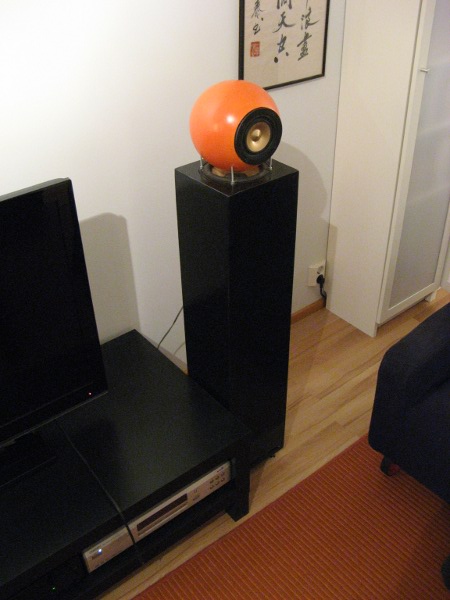

Markaudio CHR-70s in medium sized ikea bowls accompanied with Focal 6k4411 stereo MLTL "subs". Xover is around 100hz.
Sound quite sweet, but there is lots of tinkering left with subs. Subs are omnidirectional (bowls are diffusors) and that creates some problems with stereo image. Still, doing and tinkering with them is great fun 😀

Your spot on right. Lows are omnidirectional but as you said xover isnt steep enough to cut out all the mids. Some omnidirectivity in mids definitely increases the spatial imaging of speakers. Downside is that highs have slightly different character and that is the problem. So fiddling with these will continue until I get it right 🙂
