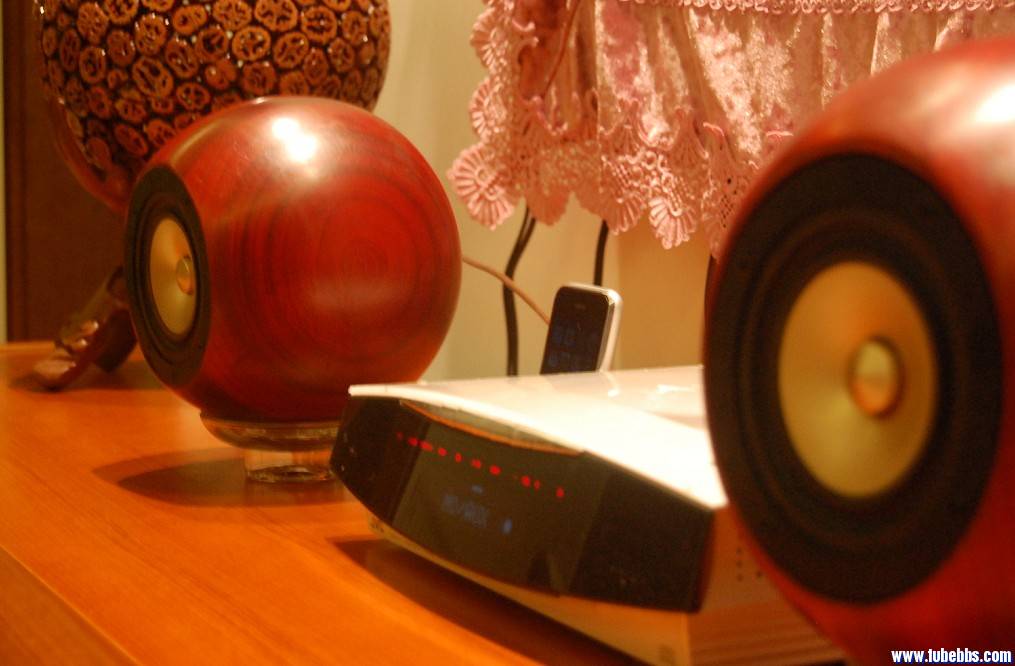

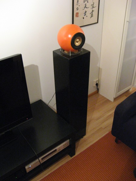

My take on the IKEA speaker:
The missile nose cone (true!) in the back is the (sub)woofer. Just finished it, haven't had a chance to do more than casual listening though.
jan didden
Hoi Jan,
WOW this is really cute 😎
What's the sensitivity of that unit?
And that sub woofer 😱 I wonder what came to mind when you where drawing that missile 🙄
Cute 😛
Groet,
José Audiofanatic 🙂

Hi José,
I haven't done any measurements yet, but the driver (a ScanSpeak) was recommended to me by Joachim Gerhard. I only had a 10 minutes listen before I left home for a looong trip....
I saved those nose cones from destruction after the system was decommisioned. You know, swords to plowshares 😉
jan

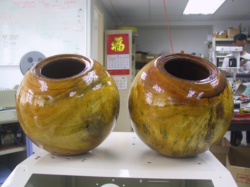

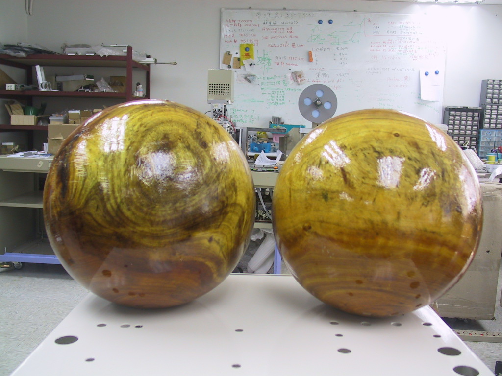

One piece spherical CHR-70.3 cabinets were made by a diyer in China.
One piece? Wow, that's what I call woodworking!
jan

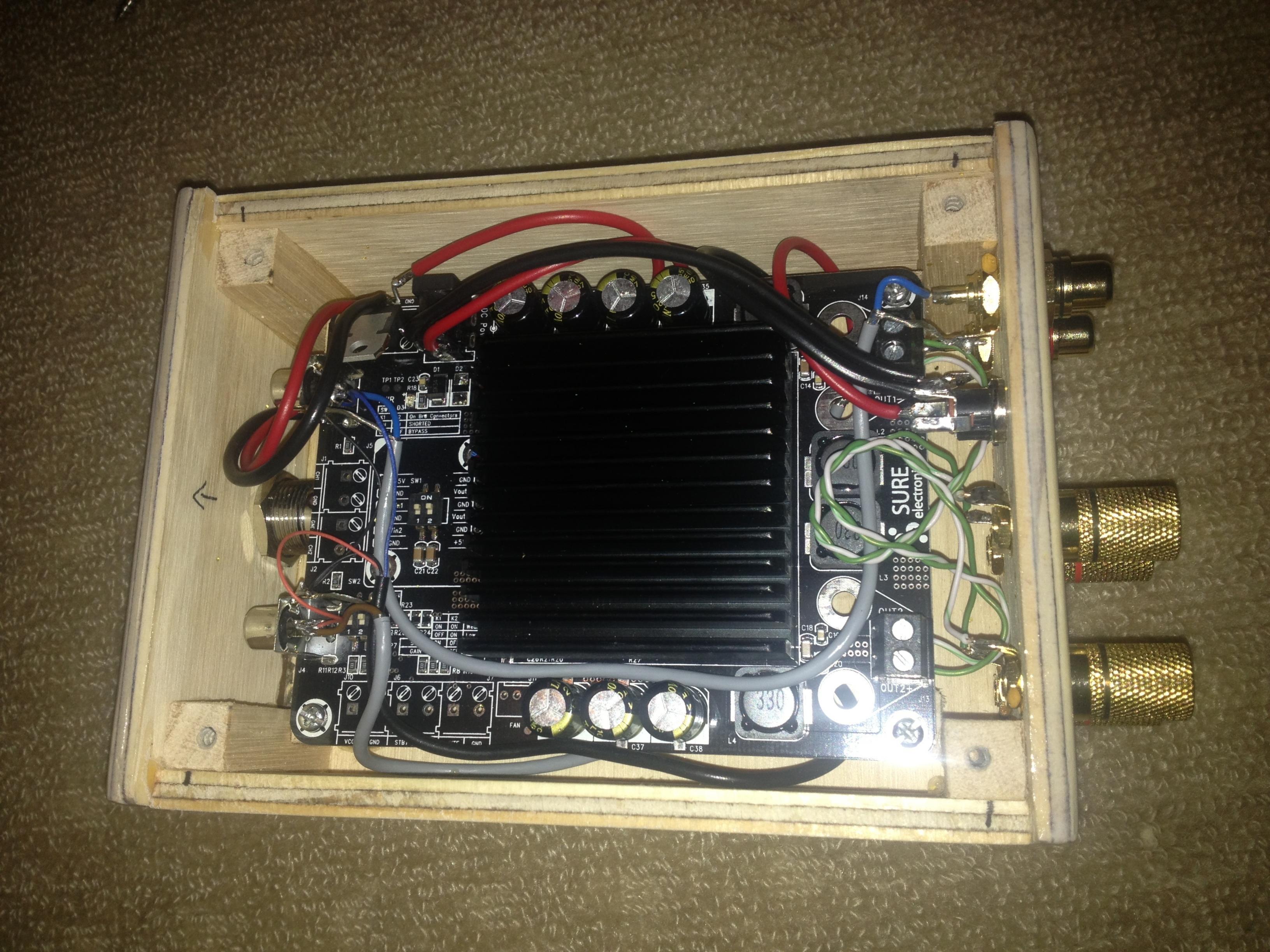

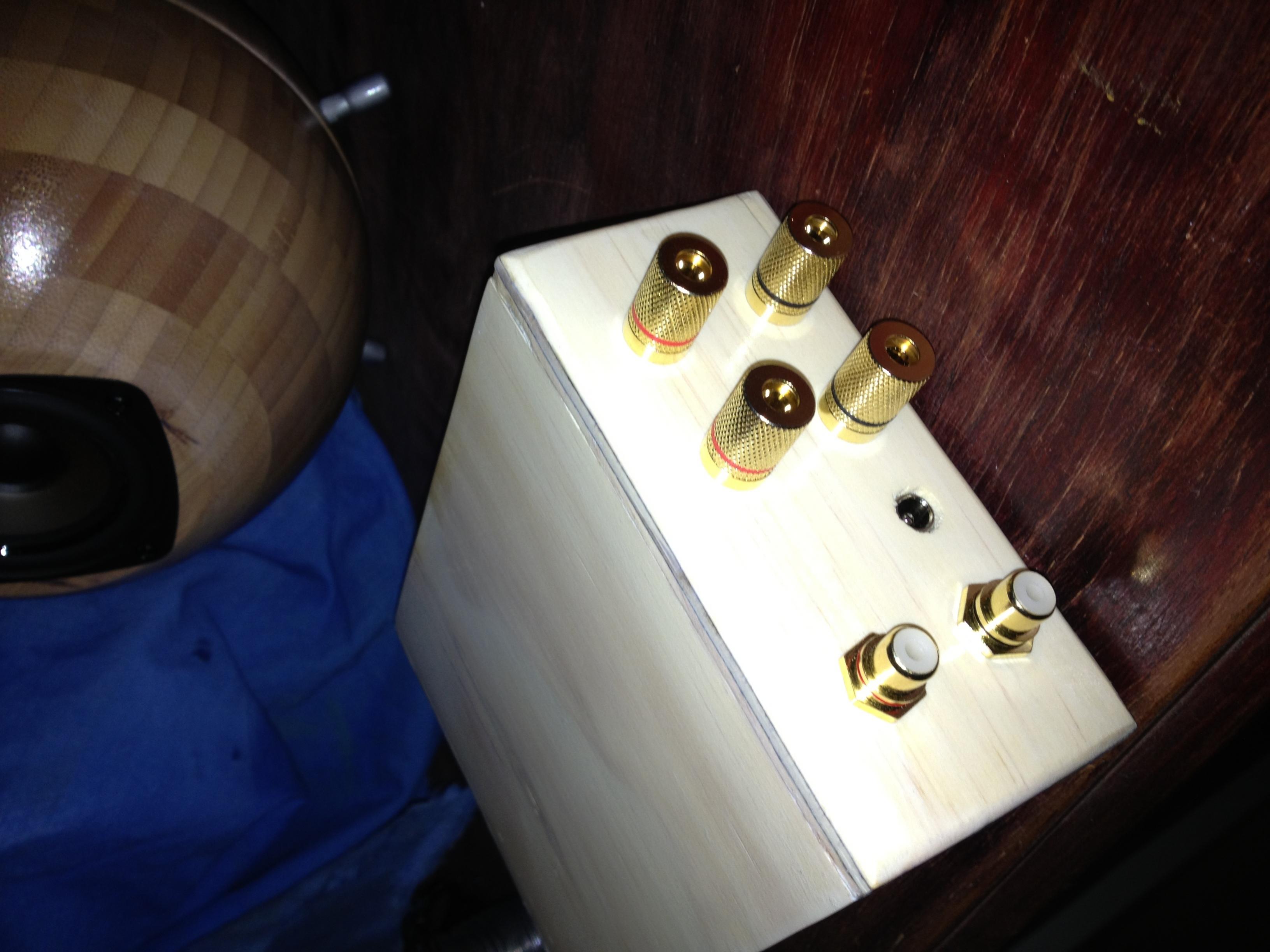

My take on the ikea bowl
Used a sure 2x 25 w a blutooth reciver
