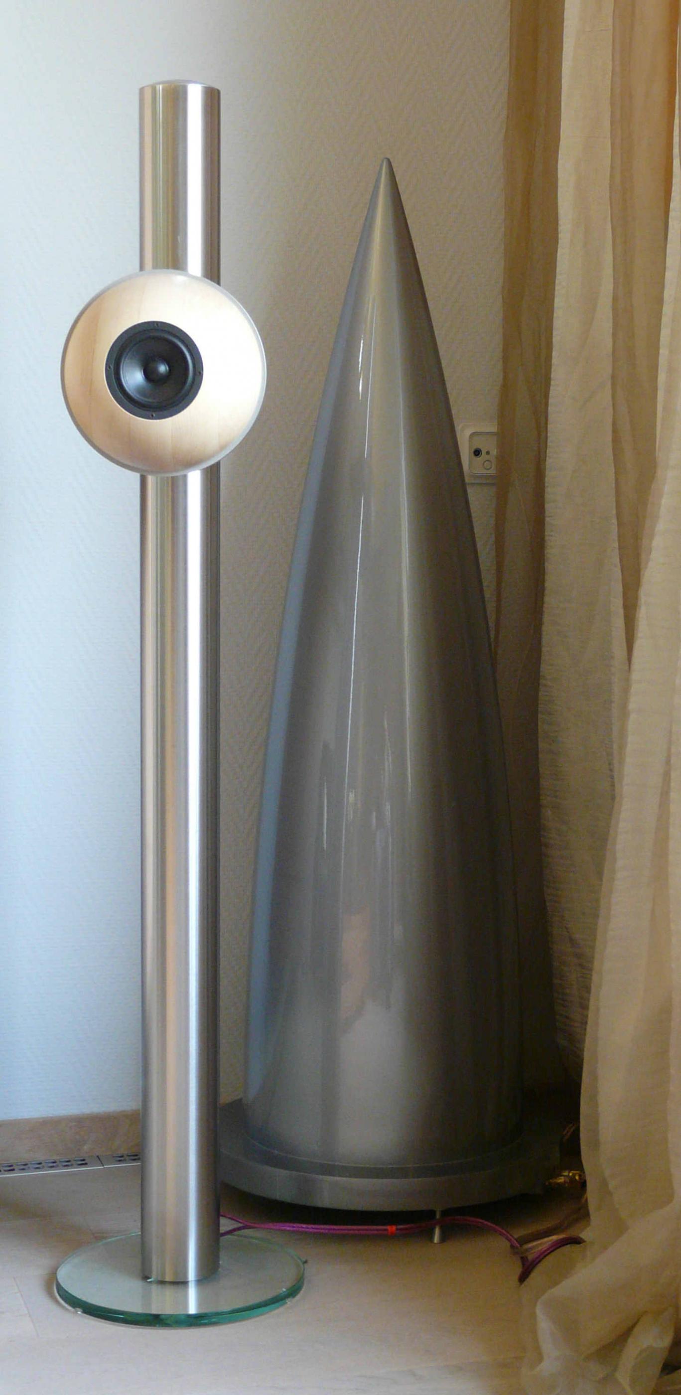

Here's something to motivate your inspiration.
http://www.stereophile.com/images/archivesart/608cabasse.jpg

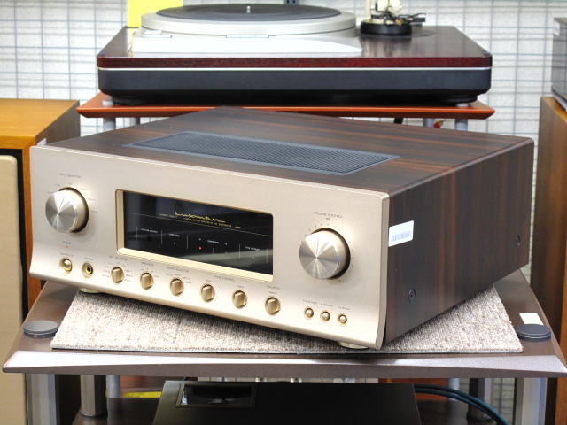

If you can get the Yam for a nice price and its in good condition, could be a good buy. Talking of amps, I'm hunting for an all-Japan Luxman 503S this during the coming week in Tokyo - see pic. I've gotta a bit of the "love thing" for vintage Japanese Moffys.

The finish on that Luxman 503S looks gorgeous!!
This Lux gained a reputation for smoooooth, possibly due to it's lower power output. I'll use with my home Pensil 7's while I upgrade the 300b's transformers.
