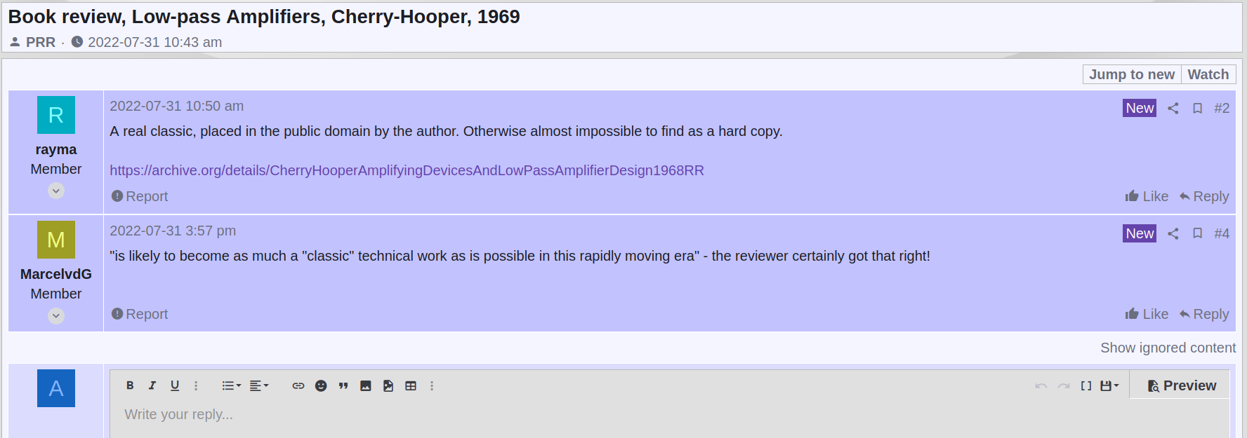

It was reported to me that ignored content was showing during certain posting operations.
On testing I was able to force the situation by simply linking to the post. Shown here, the content is already showing and so are the 'show' buttons.

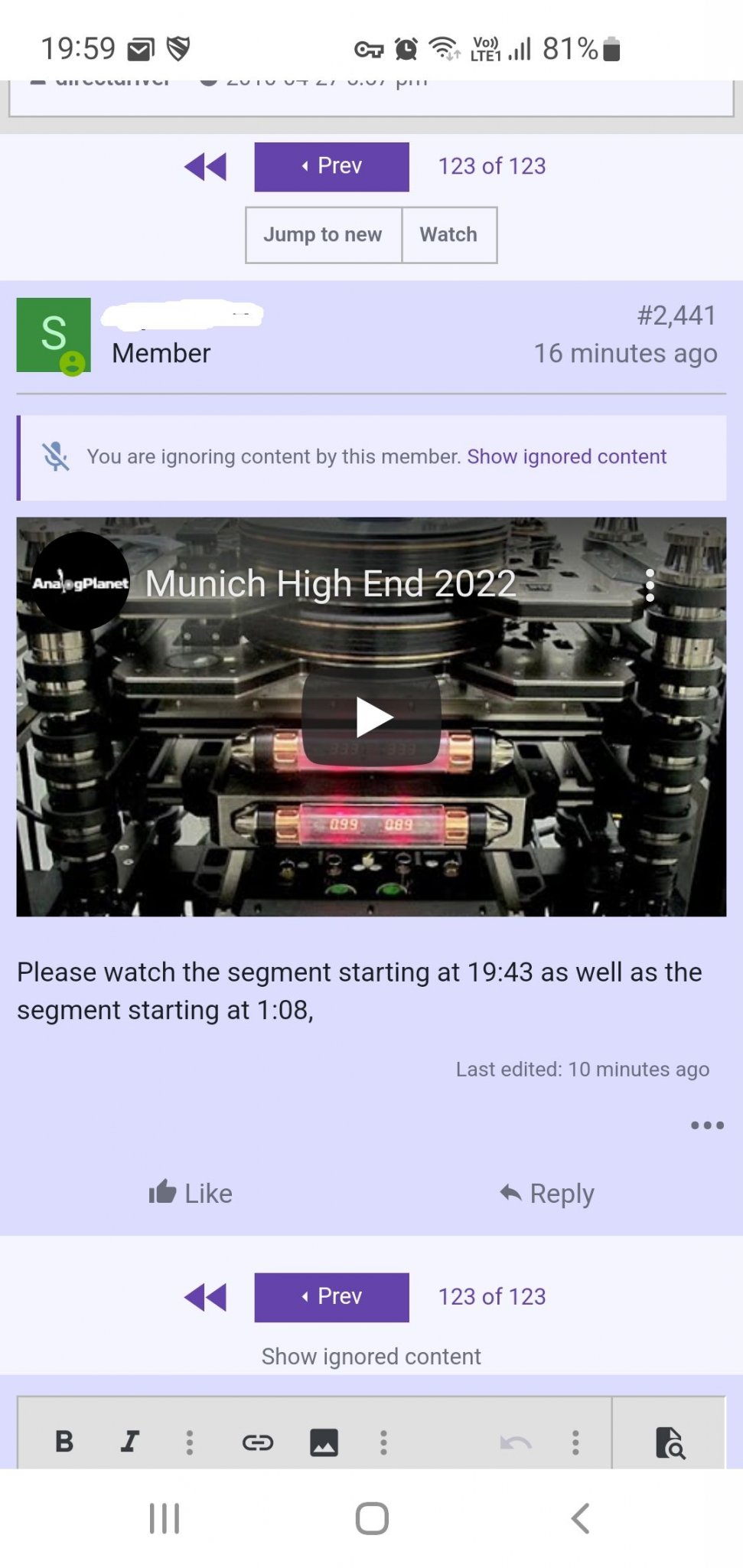

I have looked at the testing thread, and based on what was posted there and my own testing, I see what is apparently one bug and one behaviour change. Let's detail exactly what the scope of the issue is, and I will get it resolved.
Bug 1 - Direct links to ignored user posts show the post content
  • Current behaviour: Clicking a direct link to an ignored member (eg: https://www.diyaudio.com/community/...ot-for-general-discussion.386750/post-7034915 ) will show " You are ignoring content by this member. Show ignored content" at the top of the post but then also show the content below.
  • Expected behaviour: The post will contain " You are ignoring content by this member. Show ignored content" but not show the content.
