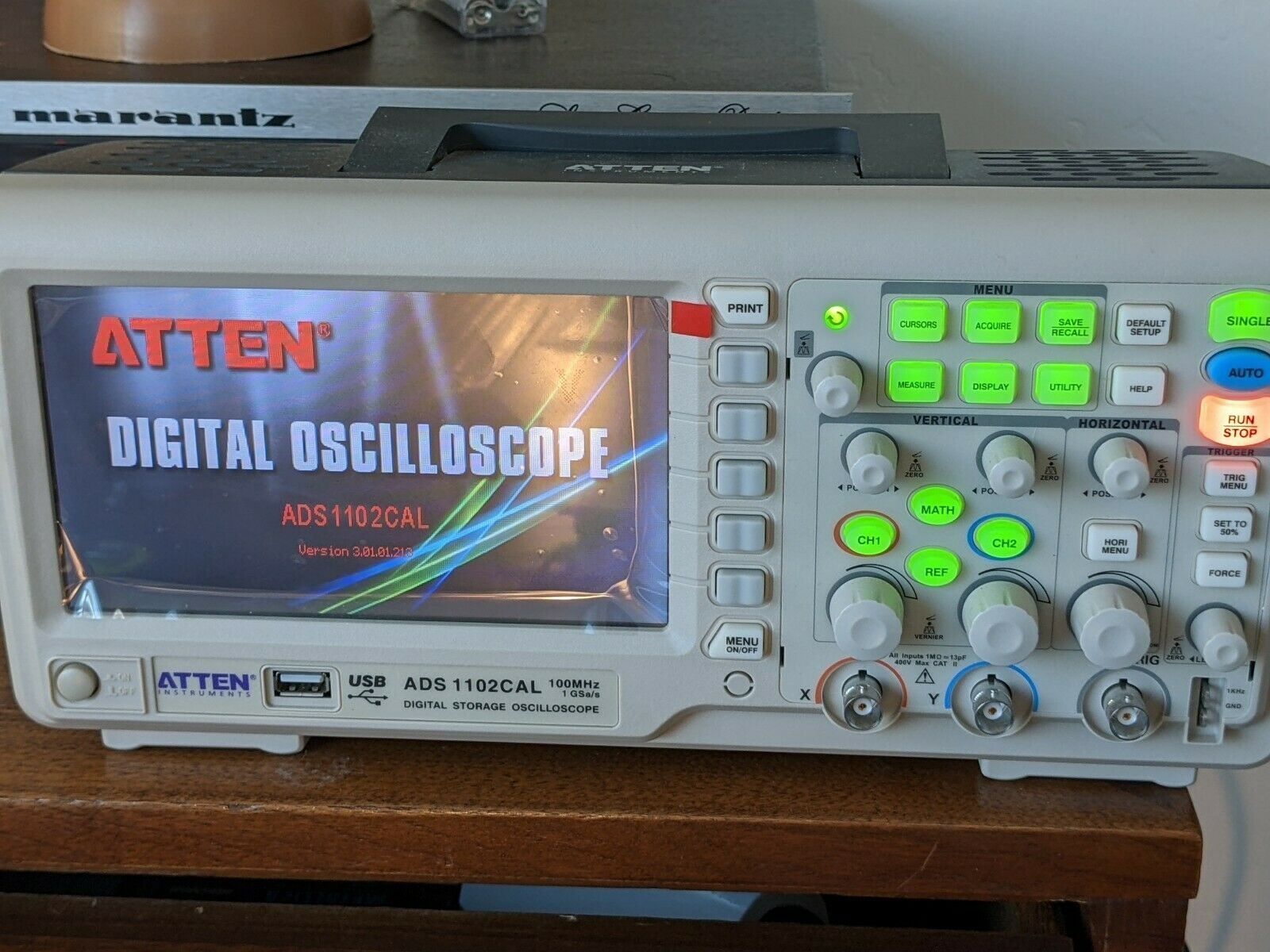

I got a strong nod towards the Exicon MOSFETs today from a helpful contributor today. The Vishay IRFP9140PBF still looks promising. Found a used oscilloscope that should get me started down this road with some real data.

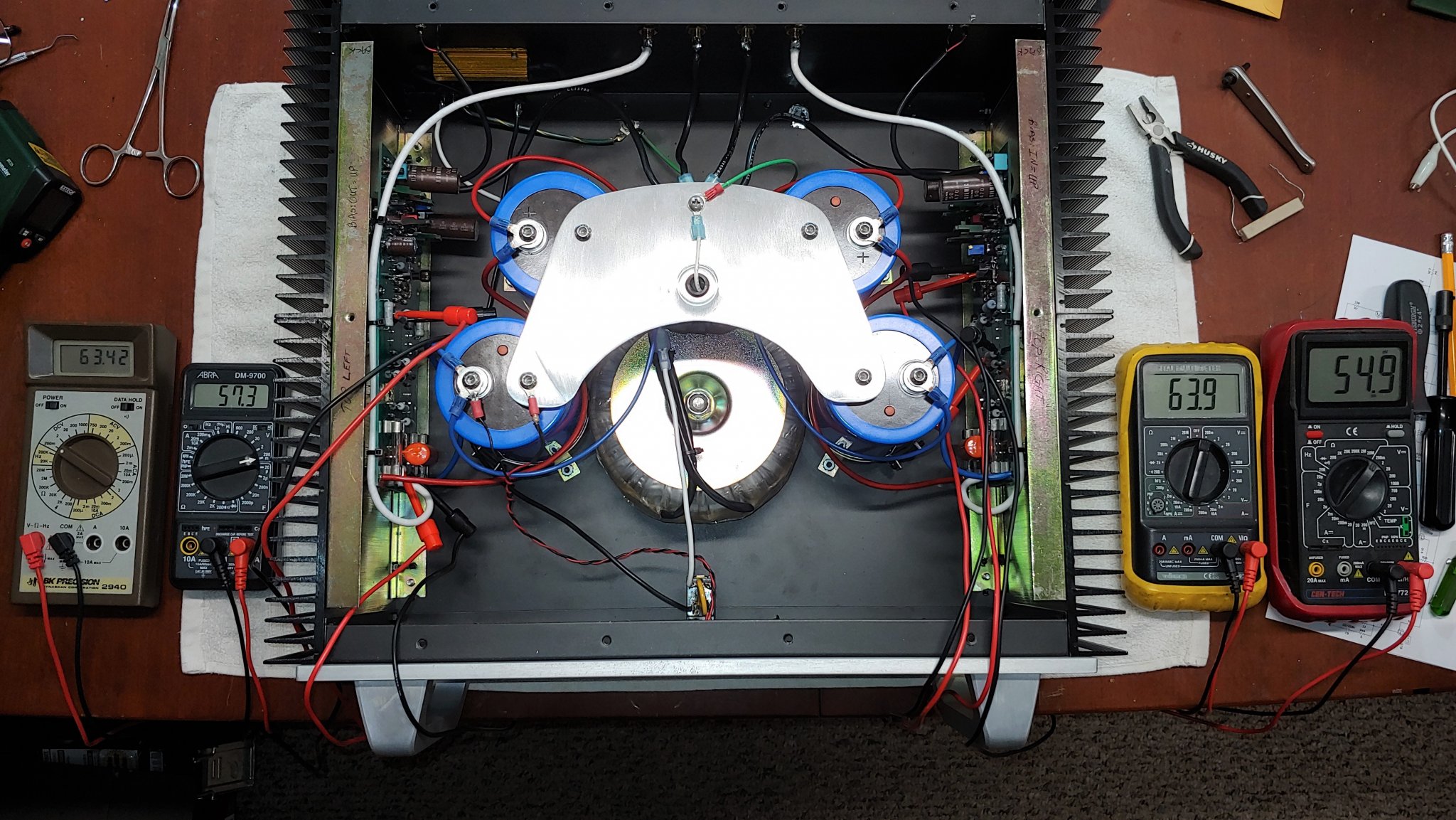

So that's what spawned this new line of questions. I removed those boards after a few days of listening (and keeping them running on 6 ohm resistors overnight, just in case the new Silmics needed to "burn in") and pulled every IGBT out of every board I had. I was able to get a near perfect match-up for both Model 6 boards, except for that one transistor... (there's always one in every crowd, isn't there... 🙄) which brought us to this point.
An assortment of 3W carbon film resistors should be arriving today, so we'll plug it in and give it a try. I would rather have that silky sound back, with less volume. It'll help me concentrate on the MOSFET project. 😉🙂

I installed the newly transistorized Model 6 boards (not 6A) back in the FrankenAmp and biased the hot spots on the heat sinks up to about 25 degrees (C) above ambient (It's about 10 degrees cooler in the house right now than it will be in 4 months).
Magic. It really is amazing how much difference a circuit can make. And the lesson is, when you find something you like, stay with it! 🤗
