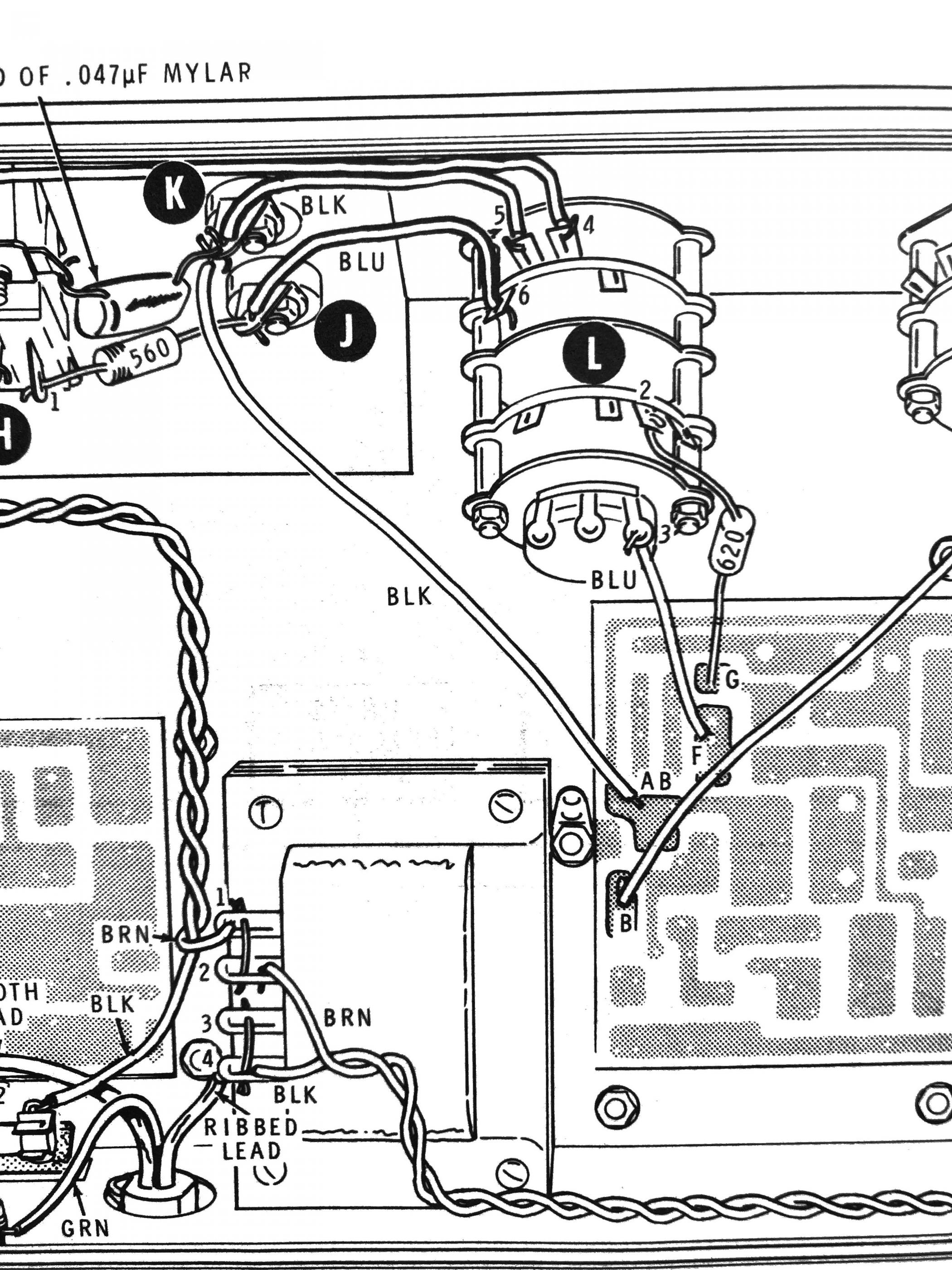

Here is the relevant instruction from page 32 of the manual.
Connect a 5-1/4" black wire from solder lug K (S-3) to location AB (not screened) on the circuit board. Solder this wire directly to the foil of the circuit board.
Use Pictorial 18 to locate AB on the circuit board. It is not screened, meaning it is not marked in silk screen so you need to use the pictorial to find it. Do as the manual says. The original owner did this connection wrong.

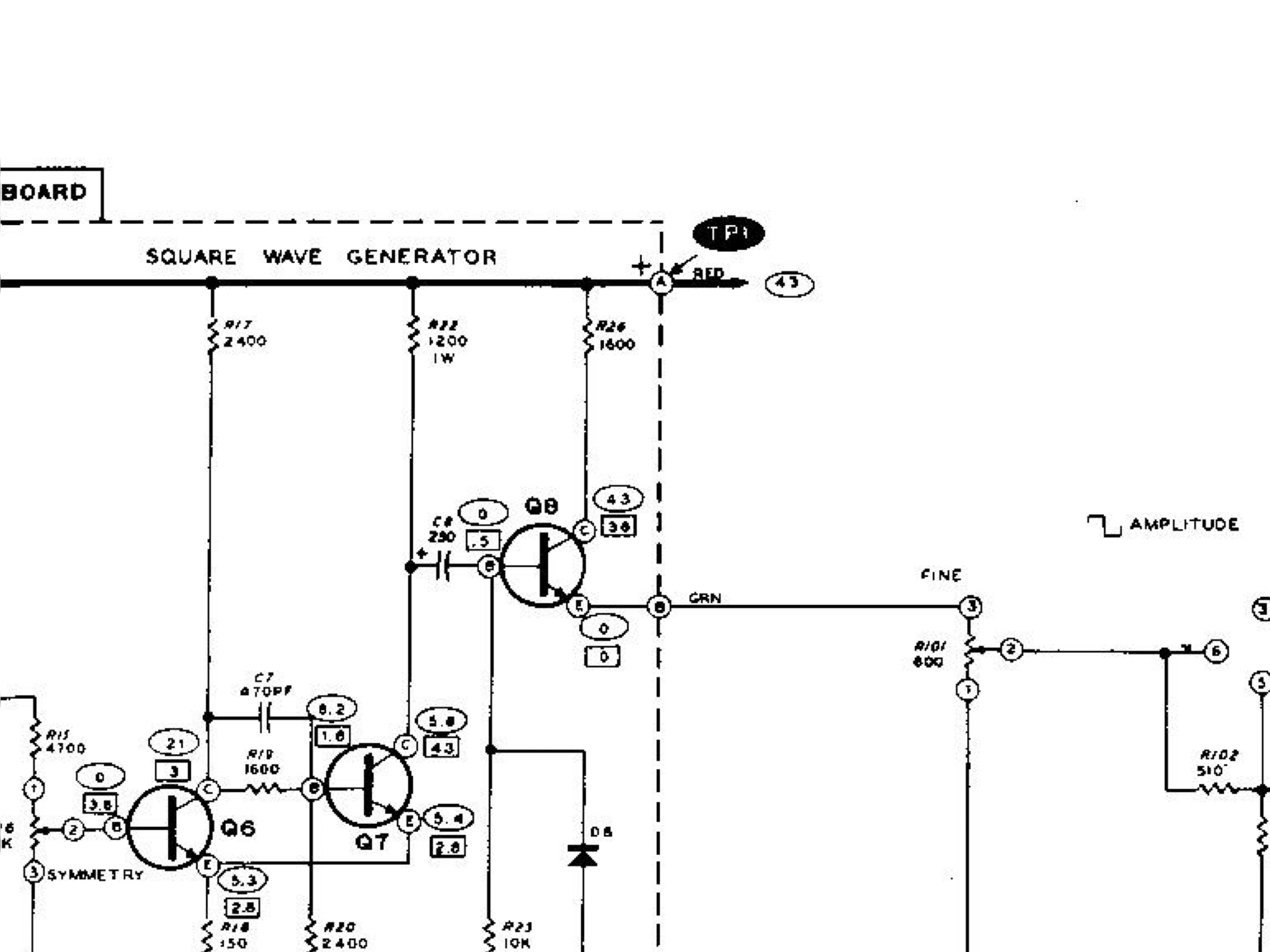

Hi Jeff
I'm operating from the schematic only--- is test point A shown on the schematic? Would you coach me re its location in case it's not shown or I'm just overlooking it?
Would you report voltages at emitters of Q1,Q2,Q4,and Q5 and all terminals of pots R7 and R9? The pot wipers should be about 21V if all is well.

IG-5218 Schem
Test point A, also known as TP1 Is on the schematic. I attached the screen shot.
Reporting my voltages won’t help you as mine are off. I have found one resistor Which should be 2400 ohms and it is 1600, so when I get it and install I’ll check voltages again. But if you have the schematic, appropriate voltages are shown in the ovals next to each Q lead as shown in the screen shot.

Hi Jeff,
Thanks for helping me find the test point--- I knew I was probably overlooking it.
Exchange of hot and neutral shouldn't cause any damage.
Sorry I was't very clear with what I was trying to recommend. I'm suggesting that actual voltages observed be used to help locate the fault.
You mentioned earlier some base voltages were near B+; Q1 and Q2? What is TP H voltage? Its value may lend insight. If pots R7 and R9 are working as intended, their wiper voltage and the base of Q2 should be in the vicinity of 21V irrespective of other faults. I suggest initial scrutiny there.

K lug and AB
The K lug is the lug connected to the backside of the black sine wave output post. Point AB on the PCB is not labeled. Attached is the graphic from the IG-5218 assembly manual. Hope this helps.
Jeff
The IG-5218 is the same as the IG-18. I can not find solder lug K or spot AB. Post a schematic with what you got. E

Here’s some insight.
Haven’t scoped the rail but during wild bouncing there is no discernable change on 43v supply by DMM. I will scope that later.
But here’s an interesting smoking gun. The square wave is pulsed DC, all positive, no negative. Or, there is a positive 3-4 volt DC component, I can’t tell which. Still new to digital scopes and I’m still on the learning curve. Confirmed by DMM. I’ll send pictures of the scope to show that and how at low frequencies, the square pulses are not square either, they are fast rise spikes then rapidly declining to near 0 before the “negative” spike which really just goes to 0. Pictures will show this anomaly better than I can describe it.
Earlier I meant to suggest turning off the square wave circuit just to ensure it wasn't involved in the misbehavior or adding to uncertainty--- but I failed to offer that suggestion. I believe if you turn the Symmetry pot to the ground end that will disable square wave generation.
Square wave signal is strictly unipolar--- positive level switching to ground. To view square wave signals use dc coupling on your scope; ac coupling will add strange-looking (differentiating) transients.
