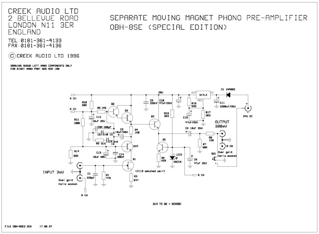

Also, I think I would have drawn the MC stage a little different. I would move R22/R38/R55/R37 and C44/C24/C52/C39, from the PSU schematic to the MC schematic.
The MC stage is similar to the one QUAD used and is typically drawn with these components together with the rest of the curcuit.
The capacitor and resistor from base to emitter pusle me a bit. The resistors might be an option for trimming the difference in base current of the two transistors.

yes, the place of the resistors R45/79 and R78/83 is unused - the SMD-caps are very small values, so I think (to prevent oscillation), unfortunately SMD chip caps without marking code in most cases.
Back to the output stage. According the previous URL resp. second image in this post the schematic from previous post is still wrong and should actually look like in the first image of this post. But according the PCB of "micro iphono 2", ser.-No 2042002252 the schematic looks definitely like the correction in my previous post.
Such a version I don't find online anywhere - have a look to the other schematics in the additional attachments.

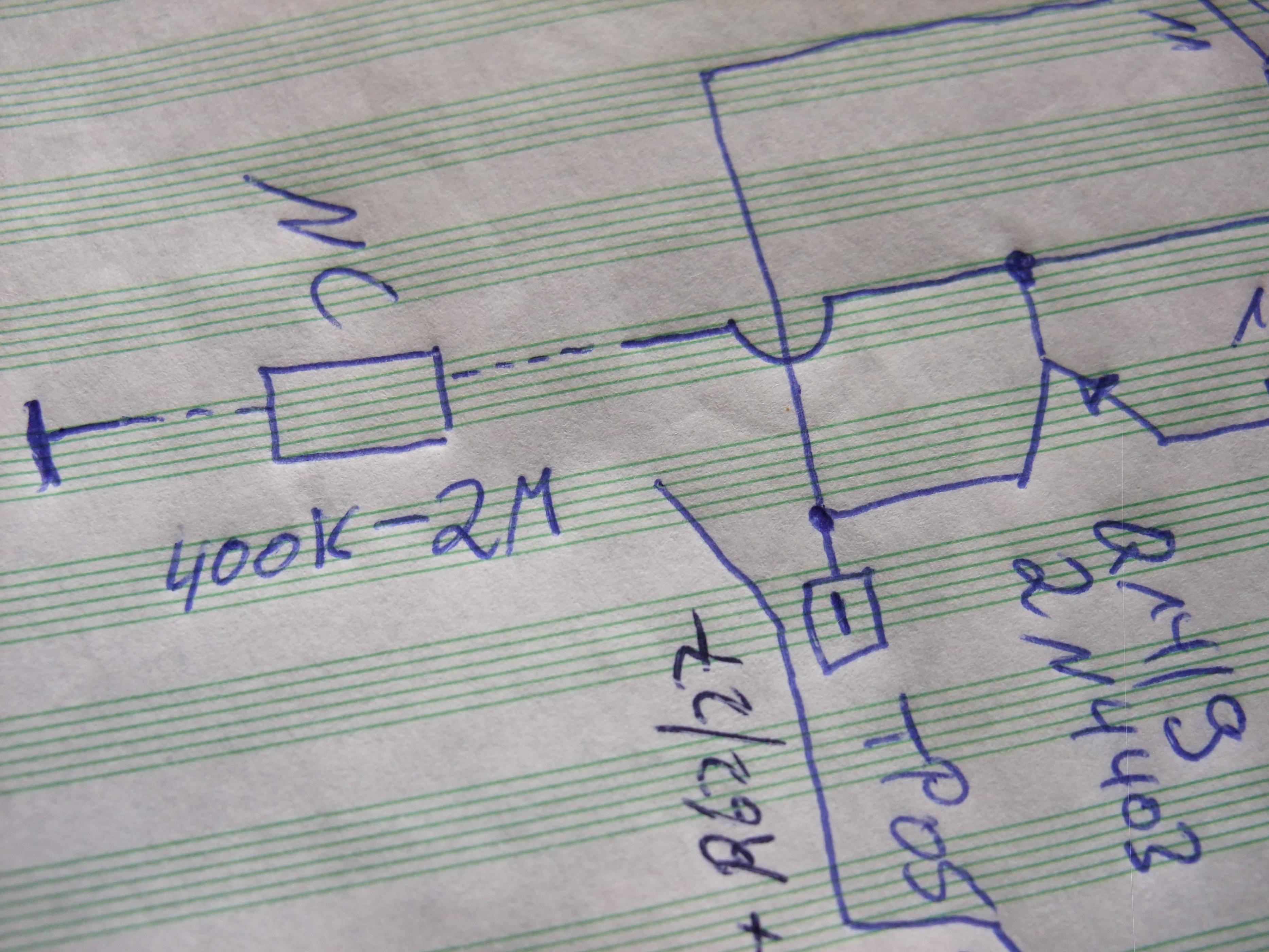

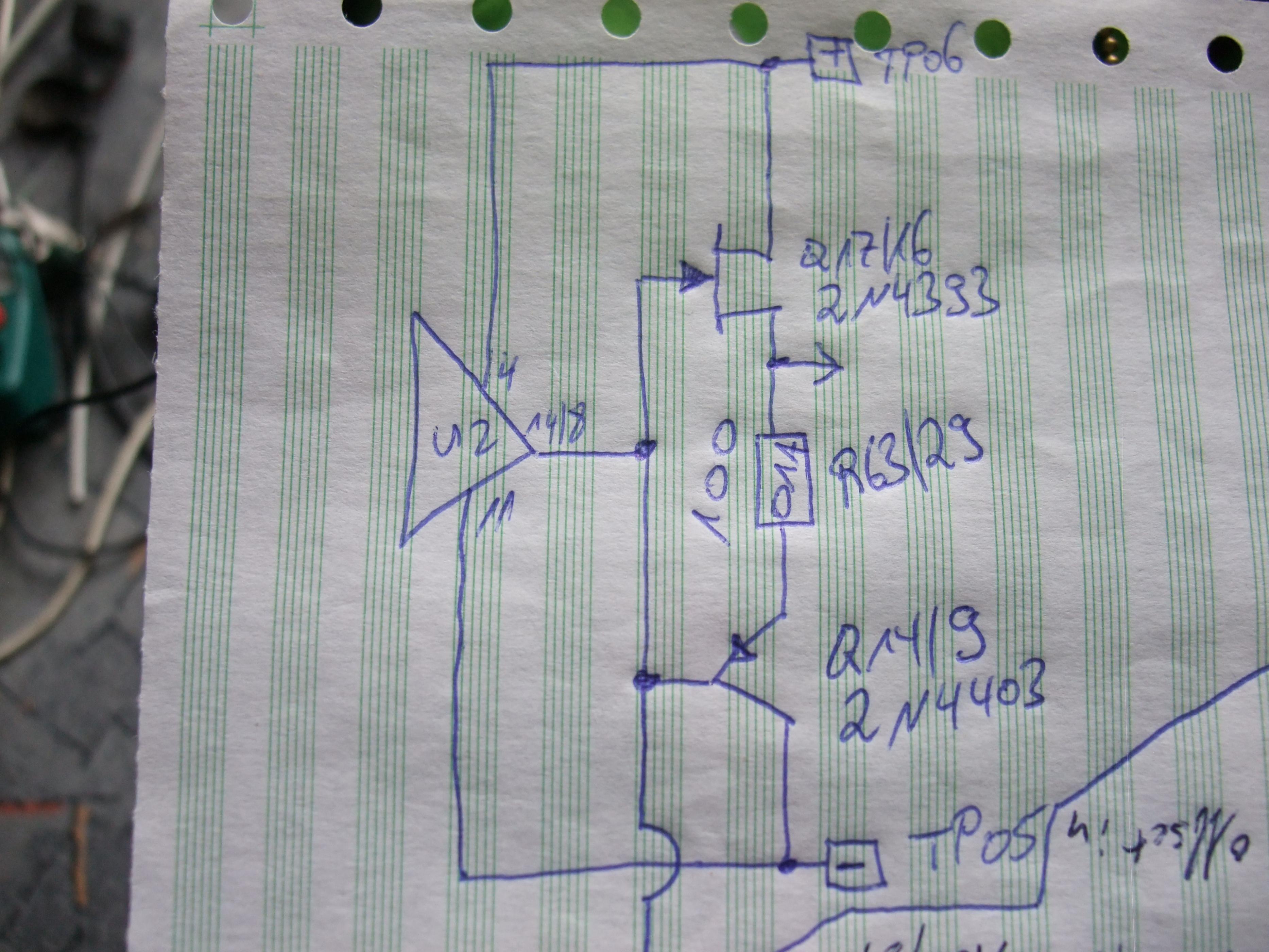

Either it really is a design flaw that has crept in between the prototype and mass production stages (the fact, that the device works, does not mean automatically, that everything was done right) or it's a special version for a special sound character.
The measured resistance between Gate/Base of the output stage and GND is 400 K in one polarity and 2000 K (2 M) in the other polarity.
That means, that no external resistor was overlooked and the measured values are defined by the internal circuit structure of U2.

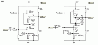

This URLs don't provide the right advices:

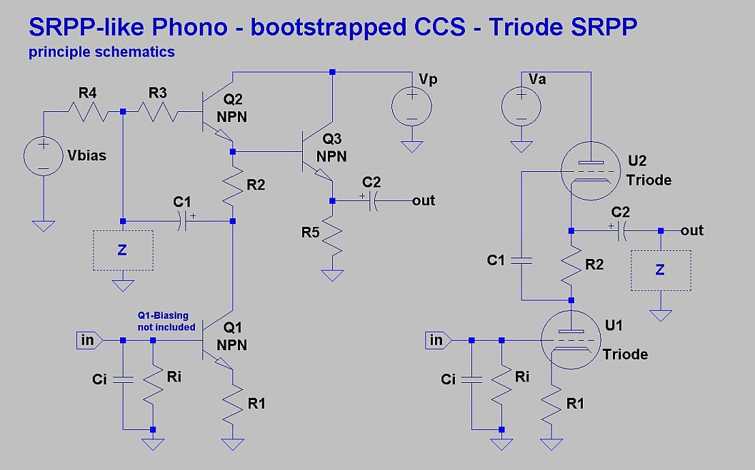

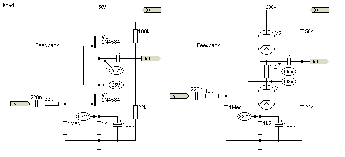

The Good Old Days & More SRPP
Fertige Phono-Vorstufen mit SRPP-Schaltung von Alex Nikitin (wie Creek OBH-8) - Phonovorstufen und Ubertrager - Analogue Audio Association
No, I don't think your original drawing with the resistor R63/29 is in the base of Q14/9 only is necessarily wrong. As I previously said, as I don't have the board myself I can't determine which side of the resistor the gate is tied to. But, it's fine if it's just in the base of Q14/9. The resistor doesn't need to be between source and emitter, like the circuit used in the cross-over. That's just if you want a larger Gate-source voltage in order to reduce the current of the JFet further than the VBE of 0.6V from the PNP transistor alone.
So I think you circuit from post #18 is correct.

The schematic by post 11 under
https://www.diyaudio.com/forums/ana...preamplifier-2006-edition-11.html#post5548073
is very close to the version here (except MC head amp, offset servo and output buffer stage).

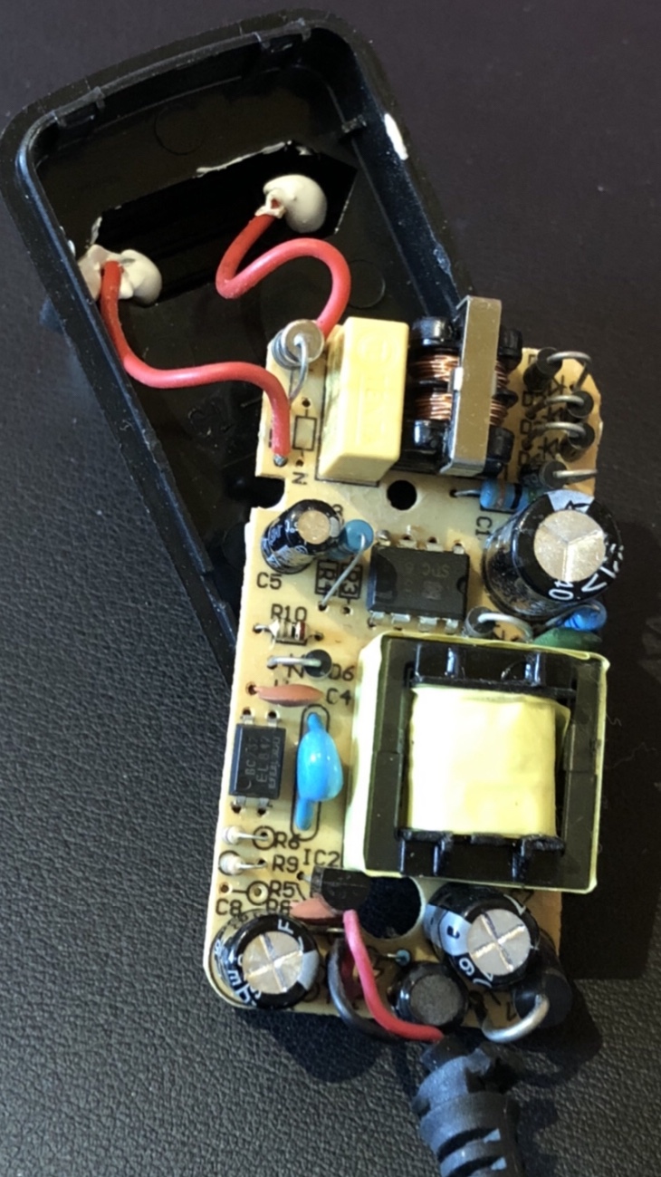

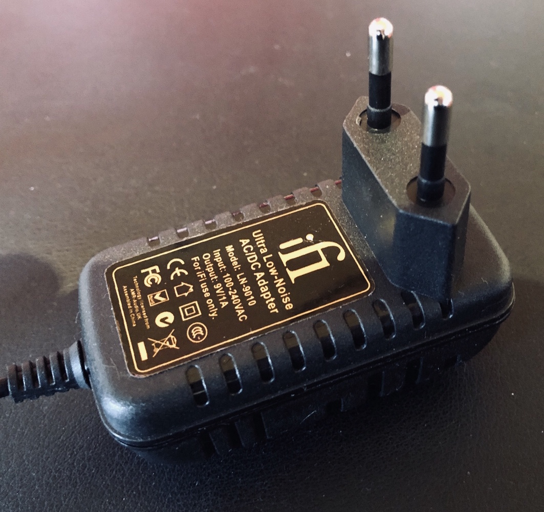

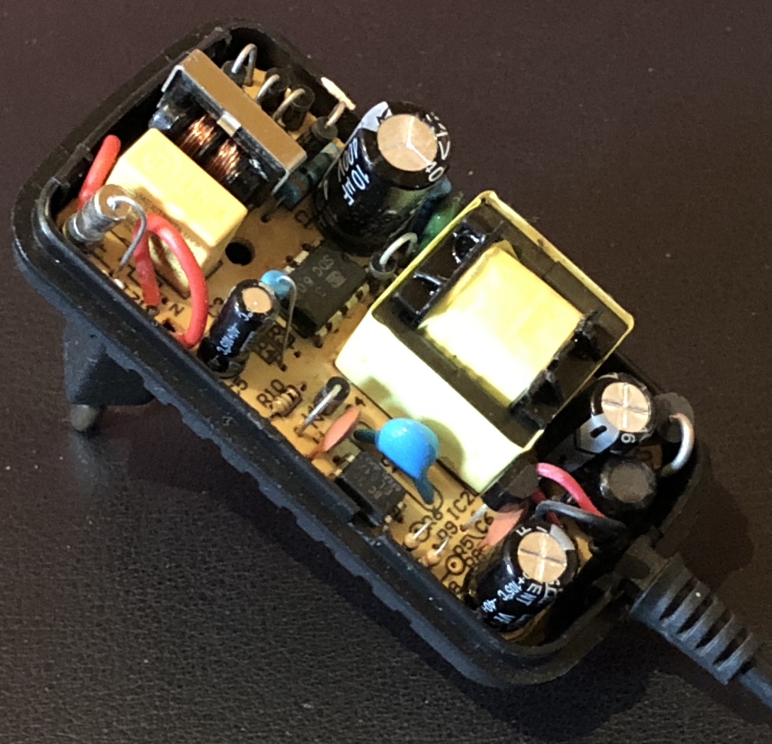

- With the included, slightly too weak in-wall power supply from AMR Audio model "LN-1530" sometimes rises up an undesirable 50Hz hum (by use of an enhanced power supply, where are better parts in use, this issue disappears).
- Despite the fact that 3 pieces 51 ohm resistors were connected in serial mode to distribute the thermal load, some parts become seriously hot, particularly the electrolytic capacitor C4 and the others arround it.

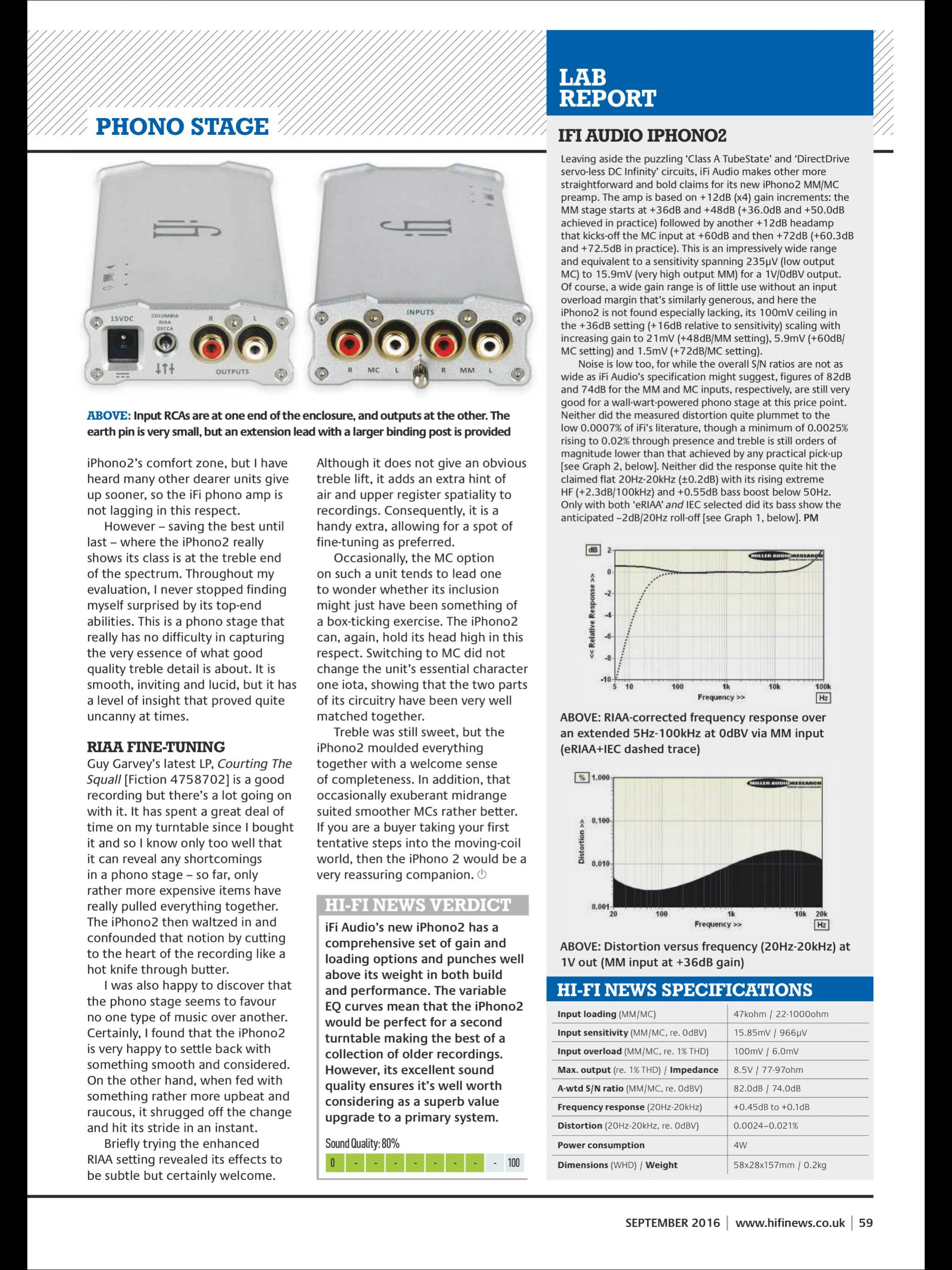

Review and LabReport in HiFi News
three pages include RIAA Error (RIAA Response) and UserGuide PDF
Where is the difference between "eRIAA" and "RIAA" - I see only the difference between shorted (black line) and not shorted subsonic filter capacitors (blue line) ? - go to the second image under "LAB REPORT". There should actually be a difference at the raised area above 18 KHz.three pages include RIAA Error (RIAA Response) and UserGuide PDF
Strange is also the raised area below 100 Hz without subsonic capacitors at the outpout (bass boost). What is therefore the reason (in the schematic there is no such function to discover)?

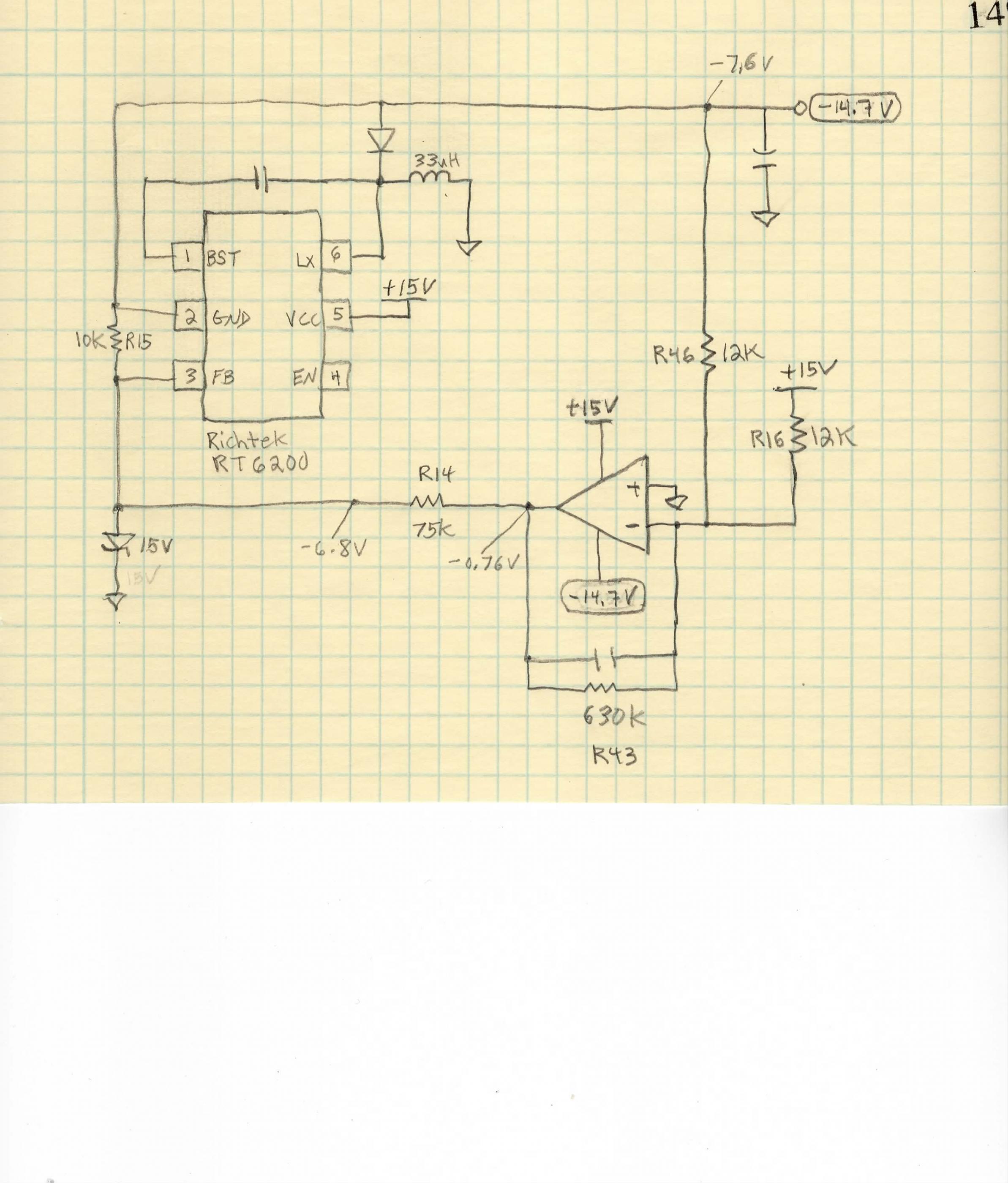

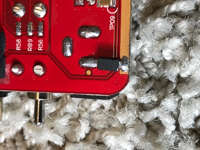

Help with broken iPhono2
I purchased a used iPhono2 that I would like to fix. The most apparent issue is almost 14V on one of the output channels. The main circuit deviation I've found is the negative supply generation circuit is outputting -7.6V instead of something close to -15V.
I believe I have fully reproduced the negative rail circuit (attached). I have tried replacing both the buck converter (RT6200) and the op-amp, but no change. I have removed an inductor and isolated the circuit from the rest of the board with no change, so it doesn't appear to be a loading issue.
My questions are:
Could the very un-symmetrical supply be the cause of the +14V on one output channel?
Any suggestions on what might be happening with the negative rail circuit?

Thank you for posting this schematic. In the meantime, I also had various devices of this model with similar errors, but I have never done a repair in this sps section just to preserve the genuine condition - check out in this case post #26, C) 1)
Instead, I did the following:
1) All parts removed up to the input of positive and negative rail (TP01/TP02, sixth image post #12)
2) Add of zener diodes between the input of positive and negative rail and GND (ZPY10-ZPY15)
3) Add of an current source with LM317
check out therefore the PS schematic of NAD's phono preamp model "PP2" - go to second PDF in post #5 under

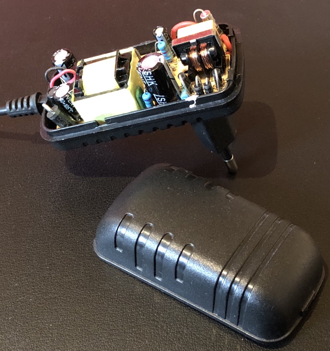

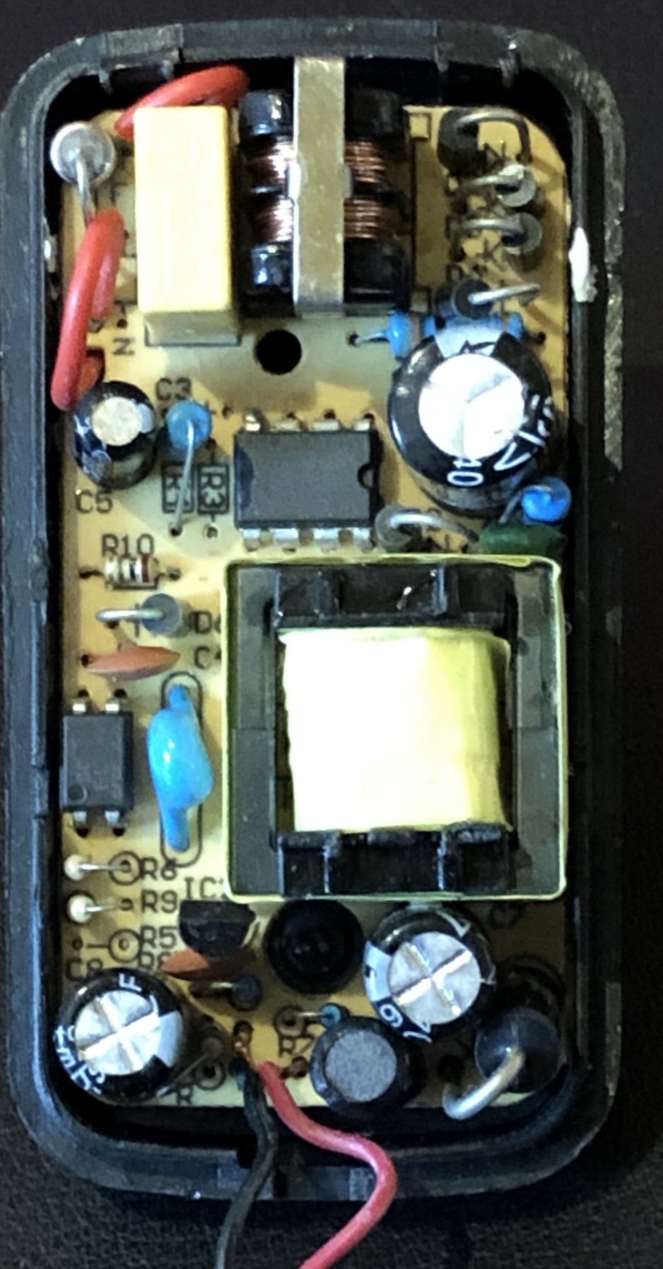

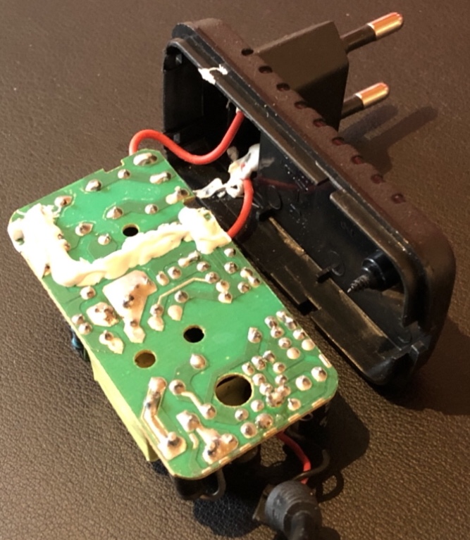

4) use not the genuine in wall power supply, but a version with 34VDC-38VDC similar to those under
Original Netzteil SNG-D / FW 3289/H – 10,5V / 34V / 49V – Adapter, Power Supply | eBay
Even in cases where there were no faults, I have done this several times to get a better sound.
In all cases you will get in all respects a better sonic quality, particularly, if one add additional capacitors in parallel to the zeners.

I believe I solved the low negative rail voltage by replacing R15 with a 4.22k resistor. According to the RT6200 this value should provide 15V output with R14 set at 75k. I did this and now have -15V. So I'm not sure if the 10k was a manufacturing error or what.
The voltage appearing on one of the output channels seems to be due to the audio op-amp IC. I ordered a replacement and will report when it is test.

Yes, I did fix this. I think the main issue with this unit is ESD susceptibility. I added a TVS diode between the chassis-ground and the signal ground, and I have not had an issue since.
I had to replace a transistor that is used as a pass transistor for a voltage regulator circuit, that is part of the negative supply rail. This fixed things until I touched the case and zapped it with a static discharge. So I had to replace that transistor again. That's when I added the TVS.
I power my iPhono2 with a linear 15V power supply and prefer it to the wall-wart. In addition I changed out the OPA1654 with an OPA1644 (quad Op-Amp IC) which lowered the noise and made the sound even better.
Overall I believe the sound punches way above its price-point. From what I can tell the early quality issues were addressed at some point. But if you get an early version, like mine, there may be susceptibility issues.
Thanks for the feedback. Did you used bidirectional TVS diode?
In original version those two grounds are already connected?
Do you have any pics of the mod/fix?
I used a unidirectional TVS (SMAJ30A). There are clear traces on the outside of the pcb that make contact with the case. I just soldered the TVS between that and the ground input from the power supply -see pic. I believe the two grounds are connected with an inductor; I measure ~100 ohms between them.
in then attachement the included SMPS (switch mode power supply) in a wall envelope. Schematic and data sheet of the used control-IC is here
http://www.sdc-semi.com/e/UploadFile/SDC608_EN.pdf
not good reliability - mainly through the cheap electrolytic caps and thermal stress - and no screws for disassembly (post #28 shows a better solution).
