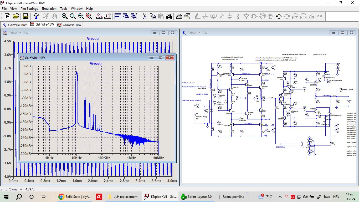

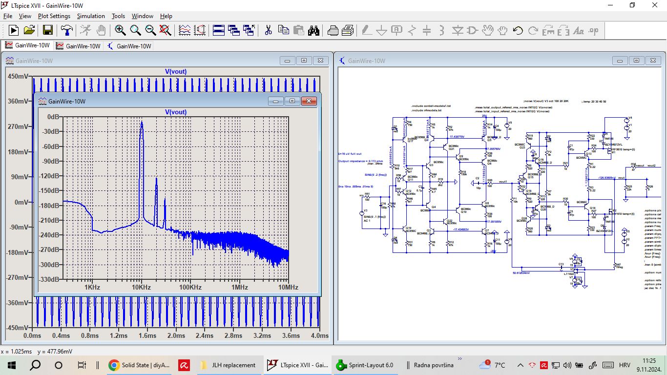

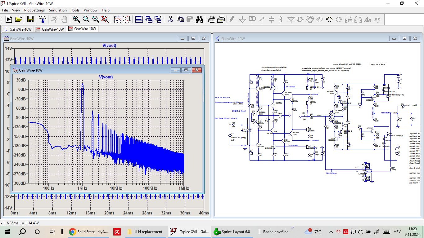

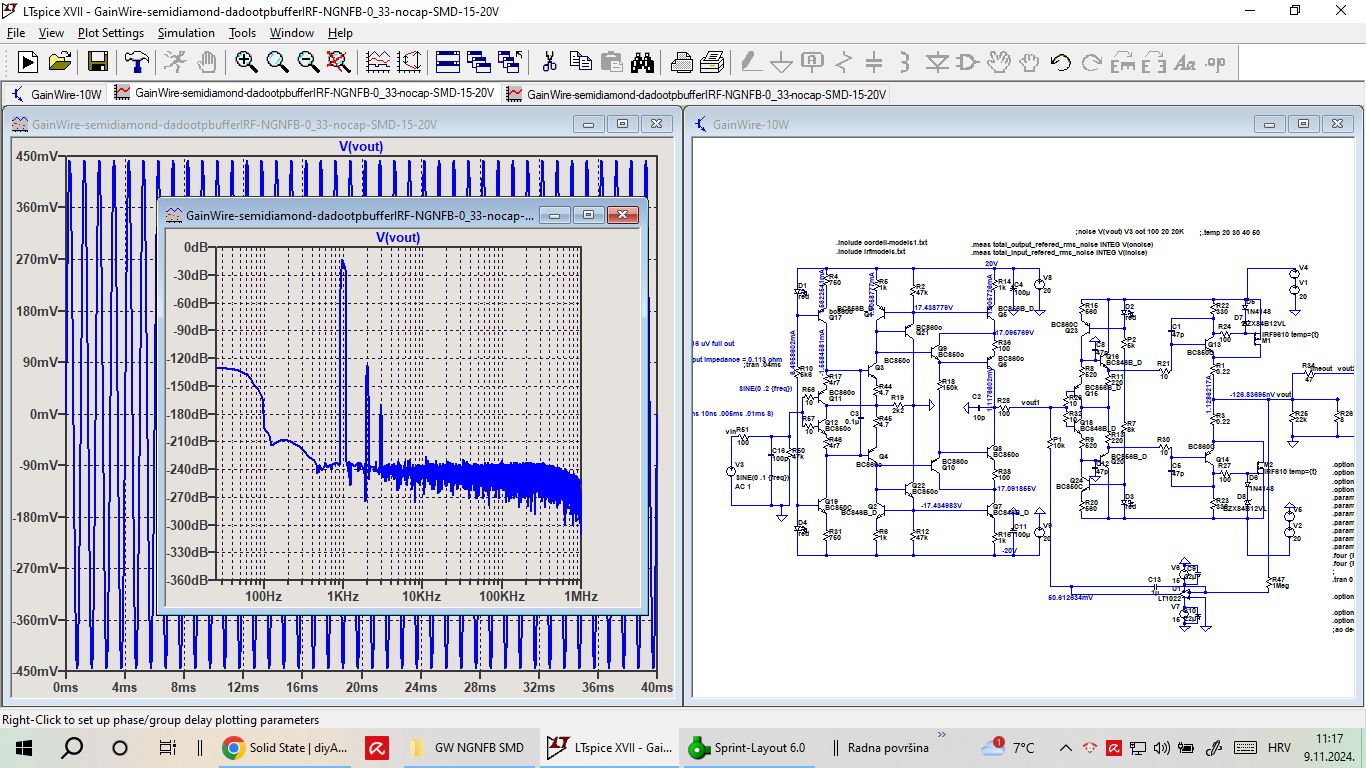

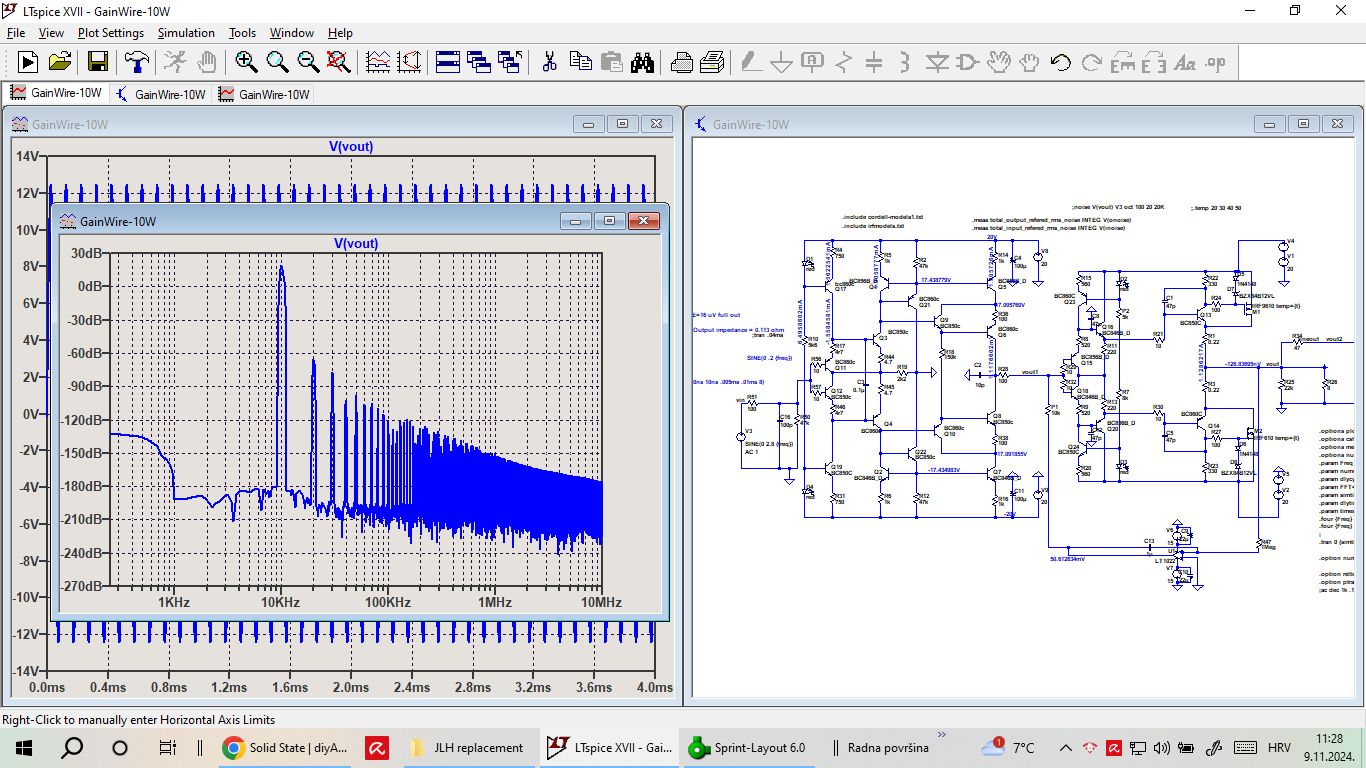

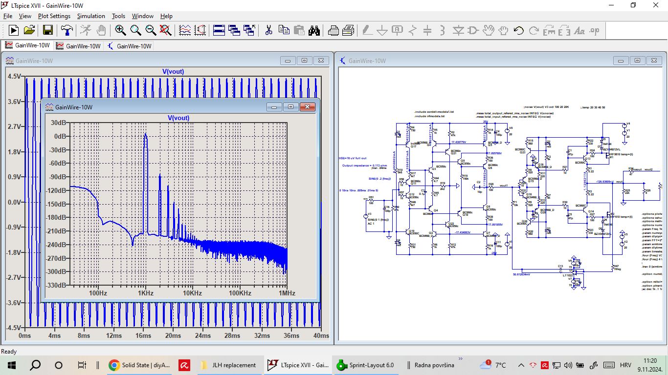

This is GW preamp with no global NFB used, in SMD technic and increased output power to drive even low impedance hedphones.
It is dual mono, used separate power supplay per channel.
Output amplifier uses CFP with mosfet transistors and it's powered by capacitanse multiplier incorporating overcurrent and DC offset protection.
Gain block is a current conveyor and it's powered with shunt regulator one per channel.
Damir
Damir

Thanks for this Damir. But I don't think your amp quite has the Distortion profile of JLH 10W Class A.You can look here, it is easy to design an transistor amp with distortion profile you like. Here is a preamp but just change OPS and you are there.

Got any THD vs frequency plots at different power levels?
