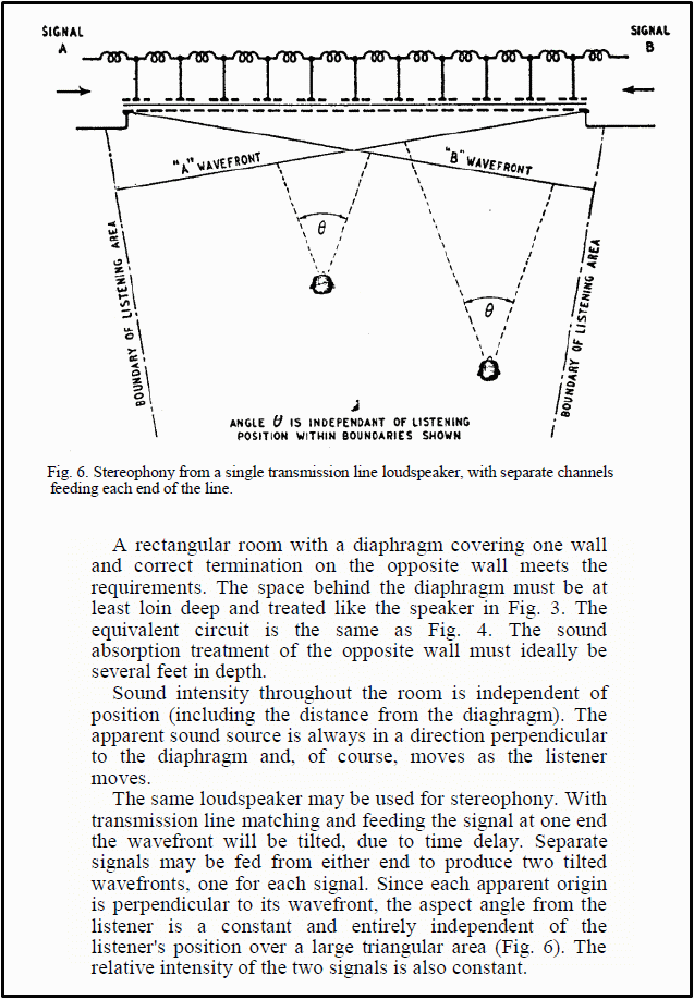

But as you move off to the left, isn't L getting louder and earlier? Isn't the delay (and distances) making things exactly worse? (Isn't that what "toe-in" of speaker boxes tries to over-come?)
Short version:
getting louder = no
getting earlier = yes
Long version:
Sound intensity will be independent of distance from the diaphragm and always in a direction perpendicular to the wave front. Basically you are in the near field of the ESL at all positions. Having never build a full-wall ESL I haven’t experienced it. But I do know that a floor-to-ceiling line source provides a near uniform sound when my head is moved above and below the middle of the panel, and the image stays right in front of me(perpendicular to the panel) as I move my head up and down. If the panel is tipped forward or backward, the image shifts by the same angle. Yes, moving away from a line source and the sound intensity falls by -3dB for doubling of distance. But this is only because sound is spreading out to the left and right rather than being contained as it is top to bottom in a floor to ceiling beam. If the width of the ESL line source is expanded wall to wall as well, the wave front will not spread out in that direction either and intensity will be independent of listening distance.
NOW, concerning distances to left & right wave fronts when you move away from the center position:
Ooh! Excellent point! Apologies for being slow on the uptake. In a worst case situation with the listener positioned on the right hand edge of the right wave front and at a close 2m listening distance, the left wave front would arrive on the order of 1mS after the right wave front. So, while direction and intensity are properly retained at off center positions(as Walker states), timing between the channels is not(which Walker doesn't discuss).Certainly less than optimal for the top-shelf imaging you probably have in mind, except on axis.
Soooo why did we build this wall sized ESL? Move along, nothing to see here…

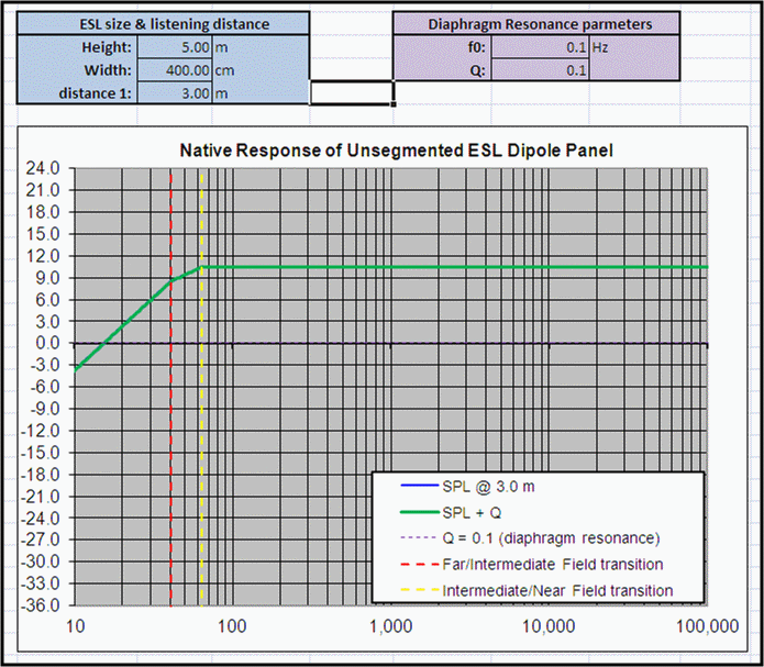

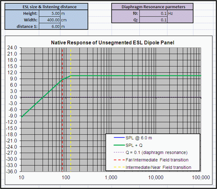

But one thing you said seems to defy the Laws of Physics, at least those laws known to earthlings with high school physics: "Sound intensity will be independent of distance from the diaphragm."
I guess there are two ways to look at this:
1) From Walker's perspective the wall ESL at one end of a room could be thought of as a piston connected to the end of a pipe. Sound waves travel down pipes with very little loss. Granted the room is a very short pipe, and as Walker mentions requires a large amount of damping at the end to avoid reflection and standing waves. But, there will be very little loss traveling down the "tube" from one end of the room to the other.
2) Looking at the ESL alone without any walls around it, you would still have a flat response independent of distance as long as you are in the near field.
The formula for determining near/far field transition relative to a panel dimension is:
F = c * r / d^2
where:
c = speed of sound
r = listening distance
d = panel dimension
The calculated frequency is where the wavelength of sound is getting long enough relative to the panel dimension for the sound wave to start spreading out rather than being beamed perpendicular to the panel. So, the further you moved from the panel, the sooner the low frequencies start rolling off at 6dB/oct.
More information along with a calculator here:
http://www.diyaudio.com/forums/plan...r-esl-simulator-esl_seg_ui-2.html#post2913884
As an example, suppose we had a wall-sized ESL (4m x 5m) and hung it out in free space. If we compared response at listening positions of 3m and 6m distant from the ESL, the response above 100Hz would be flat and identical in level. The only difference would be that at 6m the roll off in the bass would start sooner as discussed above.

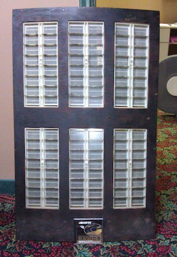

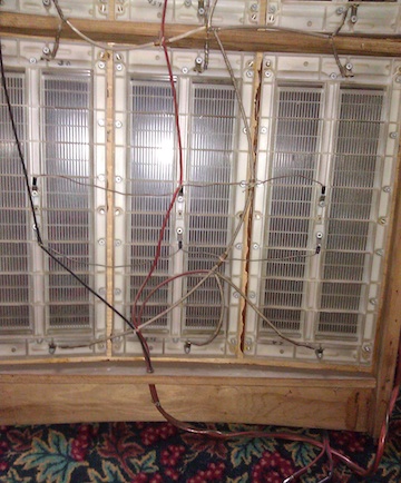

Here are the front and back pictures, as requested by Andersonix. Sorry pictures not better. CD jewel case shown for scale.
Pair of panels built around 1976 (if you are fooling with speakers and save your experiments, very good to have a house with 21 rooms). Originally powered by an oil furnace ignition transformer and two Dynaco Stereo 70 output transformers. Later, by custom HV supply and 2400 v B+ direct-drive Sanders-like amp.
These are XG8 cells, packed as closely as I could (see the back). Dayton-Wright gear is like "MIL-SPEC" construction quality among HiFi manufacturers and some other brands look like they were made in a garage. Of course, I made the crude wiring... only the cells are DW.
Each cell is 6.5 x 15.5 inches at the opening (16 cm x 40 cm). I've never measured these cells with good test equipment but they sound absolutely great to beyond my hearing range. Possibly best home audio I've ever made and possibly, ever heard, exemplifying ESL virtues like transparency and clean treble. For sure, no bass like the intact gas-filled DW XG8 or XG10 speakers (my current mid-ranges).
Ben

Gerald and Bolserst -
Pardon my obtuseness, I think I finally have it now. But let me begin by dropping that disinformative marketing name "AMT" and just saying "accordion-folded" or just "folded" or "pleated... like a filter."
Yes, a guy with a lot of cells can make an ESL woofer if they are folded to save room. The construction of a folded ESL is vastly more complicated than mounting plane films flat because of the number of edges to be sealed and their meandering shape.
For my Dayton-Wright cell shape, I think I could put twice the cells per inch of width. Twice more than plane but that's vastly less than the way pleated air-filters for car engines are packaged, or the imaginative patent drawings for AMTs.
Anybody ever heard such a thing? I wonder what the treble would sound like since the folded package has to be contained in a box or frame and the diaphragms are bouncing the treble off one another.....
Now a guy with a lot of cells AND a lot of wall AND a few 39-lb Dayton-Wright 1:100 transformers, might make one swell plane ESL sub-woofer (without needing to pleat them). Hmmmm.
Footnote: the bass from a pair of the gas-filled one-meter-square 8-cell Dayton-Wright ESLs is quite satisfying although far from profound. And more so, I would suppose, in the double-pair that Mike Wright advocated for theatres and that some owners use. BTW, that good bass also makes you wonder about the OB theory that predicts bass ought to be missing.

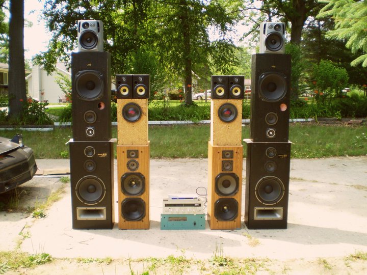

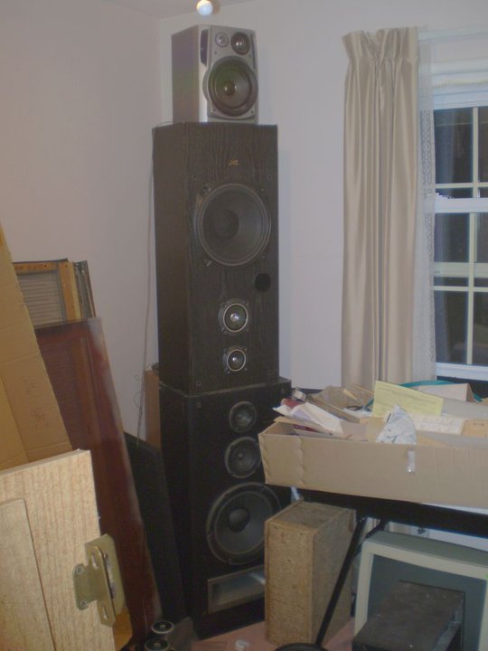

I am using 2 X 10's facing into each corner right now behind my main stack of cabinets with a 250Hz passive crossover and this works very good for me.
Although they are monopole and are in phase and parallel with the corresponding stack (see picture).
I will know more too if this is going to work once I start building some larger panels.
This about to change anyhow because 3 of the 12's are now burn't.
