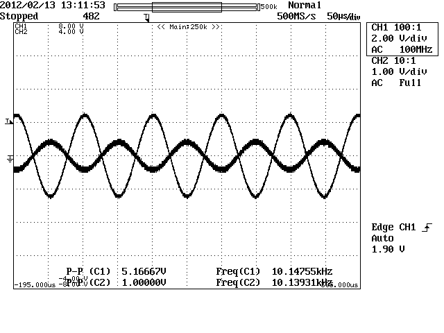

The little bird that occasionally whispers in my ear was right on, as substituting a J175 for the 2SJ74 at the input totally cleaned up the linear square wave response. It's now overdamped with no ringing (and a little slow, if you ask me). Check out the attached waveforms to see what I mean. The trace with the square sides is the input, and the one with the slightly sloped sides is the output. Right now I'm using a 2.7pF NPO disc for compensation, and it looks like a smaller cap would be more optimal. If I can find a regulation cap. I'll use that, otherwise, it's gimmick time...

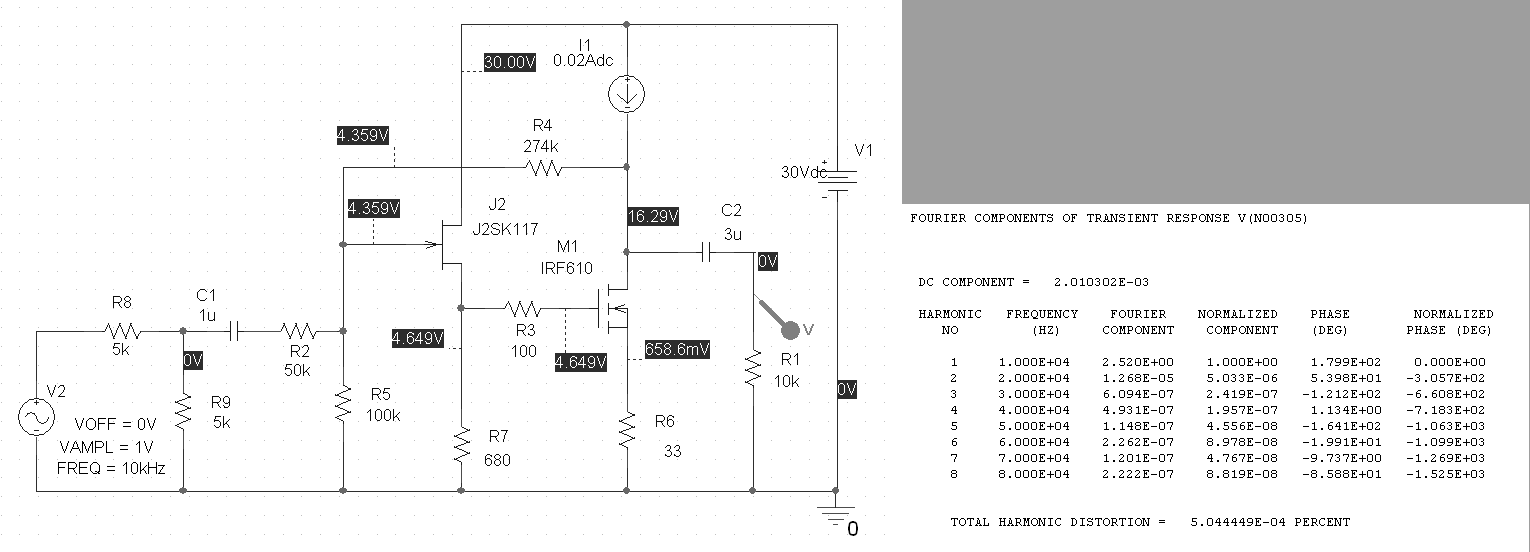

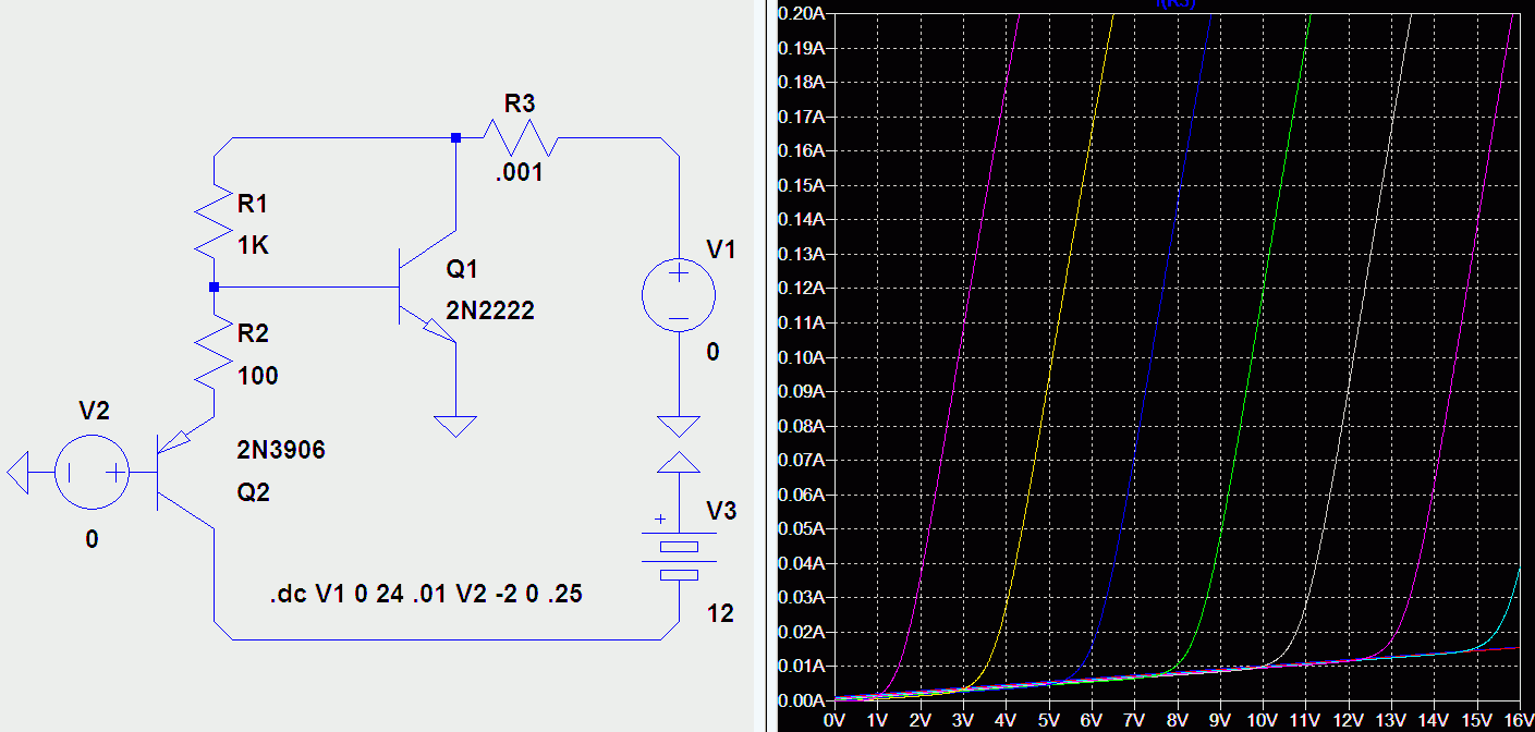

here is my take on "turning a (MOS)FET into a SIT/triode". Fair Zin, low Zout, BW(-3dB)=1MHz, rail-to-rail swing (almost), high PSRR, Id about 15mA, sounds wonderfull - what more could a man want ? 😀
Built, tested, measured (except for THD) - here is the schematics:
Hi Wrench,
Hm..very interesting 😎 What is the gain of this circuit?
Already explained in posts #57, 63, 68, 76...
Pics are nice, but reading is still essential 😉

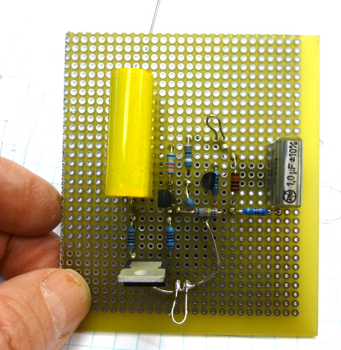

Taking this thread a little further, here's a circuit that uses a "fetfakesit" as an element in a feedback amp for line stage duty. I just finished bread boarding this circuit using a DN2530N3 current source instead of the perfect one used in the simulator, and a GaAsP deep red LED (~1.6 Vf) in the source of the ZVP3306A (simulated via a voltage source and a 1.5 ohm resistor). Voltage levels are very similar to those of the simulation shown. Distortion? Sound? We'll see, as soon as I build up the rest of the board, as it's the stripped carcass of one of my early RIAA/lineamp "preamp-on-a-board" efforts.
This is the setup I'll be testing, as soon as I can throw the rest of it together. I'll probably throw things together into a box and change sources by shifting patch cords around, instead of having to do all the baroque wiring needed for the usual rotary source selector switch. At present. all the various elements have the proper quiescent voltages. What remains is to populate the shunt regulator and mount the board in a box with the right connectors.
