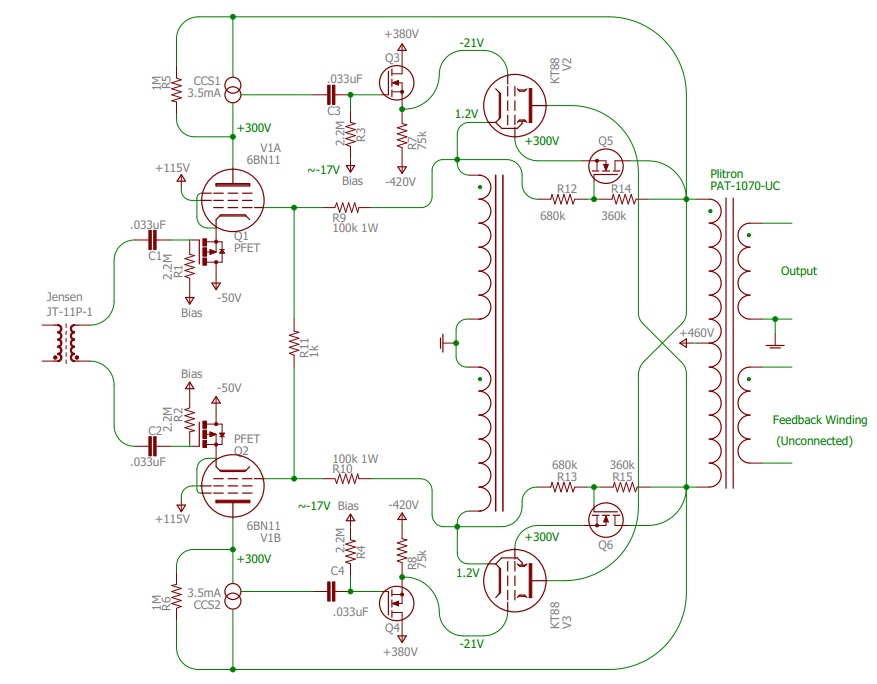

If UNSET and the RCA50W Had a Baby
What's UNSET? See here. It's a clever way of wrapping series-applied voltage feedback around an output stage and sharing some of the idle dissipation in the output stage between a mosfet follower and the output tube (which can get you more power if you increase B+ accordingly), apparently recently discovered by Mr. Tubelab and Mr. Smoking-Amp nearly simultaneously.
What's the RCA 50W amp? See attached schematic.
It's a 50W push-pull amp with three nested feedback loops that apparently can do 50W@0.1% THD, which ain't too shabby. The innermost loop is parallel-applied voltage feedback from plate to grid of the output tube. Surrounding that is series-applied voltage feedback from plate of output tube to driver cathode. And then there is the global loop that goes from amplifier output to input tube.
I've always had mixed feelings about this amp. It has a lot done right, but my back-of-the-envelope calculations show that the ouput tube plate to driver cathode feedback can't be very effective due to the fact that the low impedance load at the plate of the driver spoils a lot of the potential driver gain. Driver cathode degeneration lowers gain further. I'm not even totally sure that it has more gain than the gain that is trying to be set with the resistor ratio that is there.
Anyway, I've been playing with output tube plate to driver cathode feedback and have been having exceptional results with high gain drivers. It makes me wonder what would happen if we fixed the RCA amp a bit and used series-applied voltage feedback around the output tube instead of parallel-applied feedback, so I decided to run with that idea and I have attached a simplified conceptual schematic.
I made the output tubes two KT88 UNSETs (UNPPTs?), which frees up the driver to use a very high impedance load and develop some serious gain. Oh yeah.
This is pretty similar to my driver for my recent 826 SE amp experiments, only I reversed the input and feedback connections to make the phasing correct for negative feedback. Bias on the 6BN11 stage is not very stable over time due to absurdly-high gain, so a bias servo is probably mandatory on that stage. Open-loop gain of that stage is ~2600. This provides a lot of feedback and I expect resulting driving impedance on the primary of the transformer will be somewhere between 10 and 20 Ohms. Using a Hammond 1650R (or something with similar low copper losses) will result in a Zout of ~0.5 Ohms or so. Distortion will be extremely low.
In my mind, at that point, global feedback is optional, so I have omitted it. It could be added back in with another gain stage. I also like input transformers for the immunity to ground loops that they offer so I included one. Obviously, I have omitted some necessary components such as stoppers, protection diodes, and something to tie input transformer secondary to some level other than what the leakage currents pull it to.
The UNSET output configuration offers the opportunity to share some of the idle dissipation between the mosfet and the power tube, so I have increased B+ to 530V. This still puts 450V across the output tubes like in the RCA amp, but now we can hit over 75W with the same class of output tube, and have plenty of idle current to keep idle output tube transconductance high.
I decided to pull the output tube plate to driver grid feedback network down near GND with a CCS. My intuition tells me that having a high AC impedance at this node would have a balancing effect on the amplifier. I'm not sure how well this would work (haven't simmed it or anything). The other option would be to ground the center point (maybe with a trim pot in the center to adjust out AC imbalances in the two halves).
Anyway, I think it would make a good amp that could make your ears bleed with low distortion.
As always, comments/criticisms welcome.

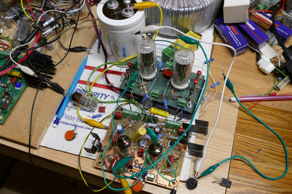

I have been working on this off and on for nearly 10 years. There have been several versions, but the UNSET is the first to become a Tubelab board. The final production version is being laid out now.
Smoking-Amps version does essentially the same thing through two different paths. His version wraps the feedback around both the driver and output stage via a mosfet in the cathode of the driver stage. This version can offer a lower overall THD and output impedance than the UNSET which has a local plate to grid feedback loop in each stage.

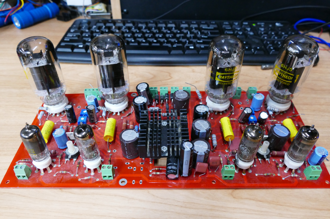

The UNSET is a rather burly amp with big bulging output tubes, the biggest seen in the USA, the 6LW6. It didn't show much interest in a 60 year old RCA amp, but tends to prefer pretty redheads. It chose a younger mate to have a baby, a direct descendant of that old RCA, a much younger "Engineers Amp."
The baby is still with some rather childish looking output tubes, actually the smallest known in the USA, the 6GF5. Still developing, the input stage is rather immature, but the childish output stage can crank out 80 WPC for hours without whining......I can't wait to see how this child grows up.

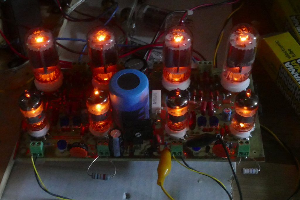

Actually the "child" is in surgery now. I'm performing an input stage transplant. The version currently implemented on the board also suffers from operating point shift particularly when the line voltage changes. I'm now implementing a separate phase splitter, and I may try some of the tricks shown here.
The original breadboard of this design is the combination of the driver PCB and the green perf board output stage on the right of a Tubelab SPP board. The first proto of a complete amp board is above the SPP board. These were built in mid 2018, before the UNSET. I have never been happy with the driver / phase splitter in this design, so it got shelved for the UNSET, which does not need a phase splitter.

Did I miss something? I thought he was describing essentially what you did, and I was the one who thought of the output to driver cathode mosfet. There's too much thinking going on here!
I love watching your projects unfold.
I'd like to build this amp here but realistically it will be years before I can get around to it. The problem is I build a breadboard version and I can't stop trying new things! Next thing I know, another year has gone by.
Sorry, you are correct. That's what I get for trying to think late at night after spending the day outside in the serious heat. I got confused as to who did what.
After a night's sleep and some searching through old threads I know that smoking-amp and I came up with the idea of driving both G1 and G2 at roughly the same time. I called it dual drive, he called it crazy drive.

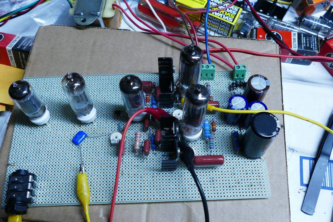

The UNSET concept allows for the elimination of the negative voltage power supply allowing for some real cheap HiFi grade amps running off a single cheap power transformer.

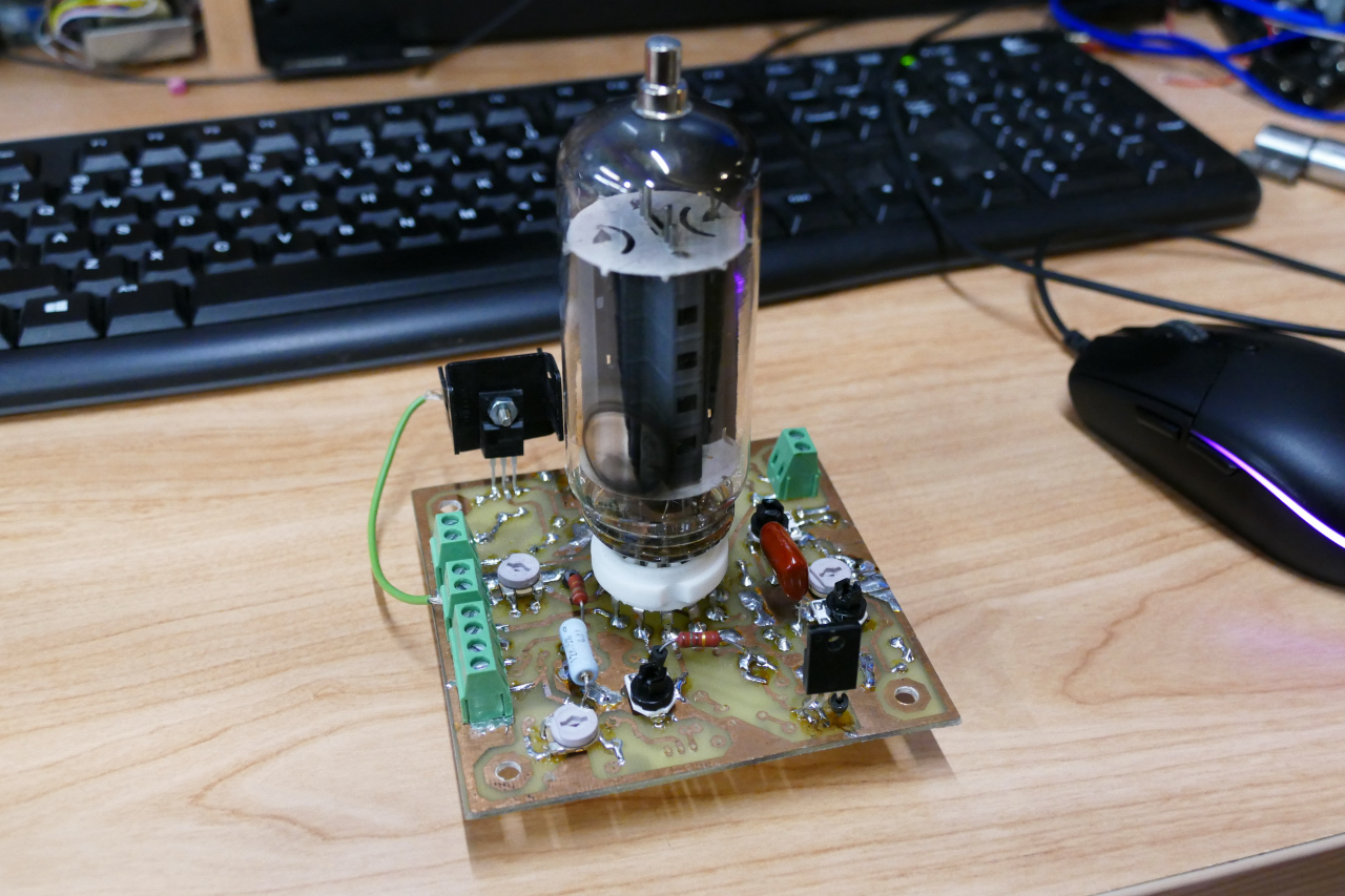

Here is a single channel amp running a pair of 50C5 radio tubes. It could be built for under $50 and makes 20 watts. It did so for 14 hours straight. Only the three tubes on the right are being used. The other two would be the guitar preamp, but are needed to complete the series heater string. It runs from a Traid N-68X isolation transformer.
I had plans for making a ultra cheap series string guitar amp using 50B5's since ESRC had over 10,000 of them and I could get them cheap. That's not going to happen now.

Well, I certainly love how in the UNSET output stage, part of the B+ is eaten by the fet at idle but is given back to the tube as it drives toward saturation. It's a beautiful thing.
Otherwise, this approach is very similar in effect to the KT88 amp I built for my brother with the shunt network driven from a p-channel FET follower. It just never occurred to me to drive the cathode in a series feedback arrangement when I was building that.
I put -50V on the mosfet drain to keep Crss low. Do you find that isn't necessary? I haven't reviewed the datasheet for the part you used (I forgot what part it is).

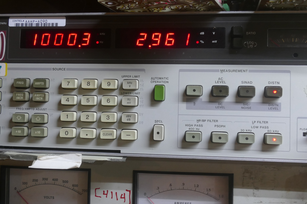

I'm really loving the results I am getting with series feedback to the driver stage, but the problem for many would be that it works so well that the amp has kind of lost its "tube character". Damping factor is high and distortion very low.
As I ran through experiments that led me here, I went from ~1% THD at 1W down to 0.027% and I definitely could hear the timbre of plucked strings change. The high distortion, high Zout early experiments sounded really cool with Norah Jones-type music, but they fell apart playing loud "workout music," which is what this amp mostly plays right now since it is in the garage with all of the weightlifting equipment. It really rocks in that application.

I just had another idea. I'm thinking there could be a switch-selectable plate load for the driver tube in my 826 amp. CCS load for when I want low distortion, resistor for when I want an effects box. Keeping the feedback divider constant would keep overall gain similar in the two positions, but gain inside the loop would vary. I don't think I'd hot switch it or anything but it could be like having two kinds of amps in one box.
I compared the FQPF5P20 and the FQPF9P25 to the fet I normally use (FQP3P50) and while it doesn't have the isolated case it does have significantly more SOA margin over the other two and the capacitance stays low to ~15V, whereas the other two start rising steeply at ~20V.
It seems like with any of these, though, a -15V supply for the drain could be beneficial for keeping out of the high capacitance zone at all signal levels, and wouldn't add too much to the dissipation. I'd probably use a cheap AC-DC brick to do it.
The RCA 50 Watt-er has been a mystery to me too for some time. As you said, the driver gain gets eaten up by the "shunt Schade" (low impedance) around the output tube grid. Spoiling the middle driver cathode loop effectiveness. I can only guess they wanted something fool-proof (no instability) for at-home constructions.
Still, to get 0.1% distortion, there must be some kind of curious synergy going on there. Maybe one feedback loop left a slight transfer curvature one way and the other loop left some curvature the other way, and they balanced the two against each other? The Citation II has got something similar going on too, I suspect.
One further twist could be to use "Crazy drive" configured grids for the output N Fdbks, with the new cathode driving Mosfet for input drive. I need to set this up on the curve tracer to see if it works well, and to see if an extra Mosfet follower is needed to isolate the screen grid current.
Theoretically, with linear operation, the screen grid would be operating at some constant V fraction of the plate V, due to this Crazy N Fdbk, so would be drawing a proportional current. That would make it intercept a constant fraction of plate current, so would look like a resistive load to the feedback divider (so could be integrated into the R divider then without a Mosfet follower, or wishful thinking anyway) Load current may mess this up though, not sure yet.
A curve trace plot should illuminate the operating range. Hopefully I can run a plot off tomorrow. "Crazy feedback" should then give "triode" curves with tilted straight lines, if that can still be called a triode.

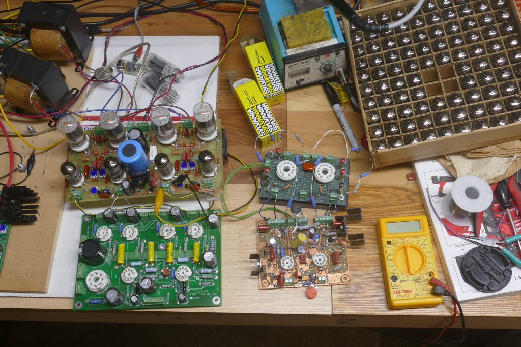

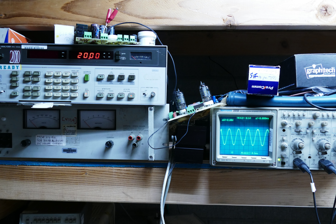

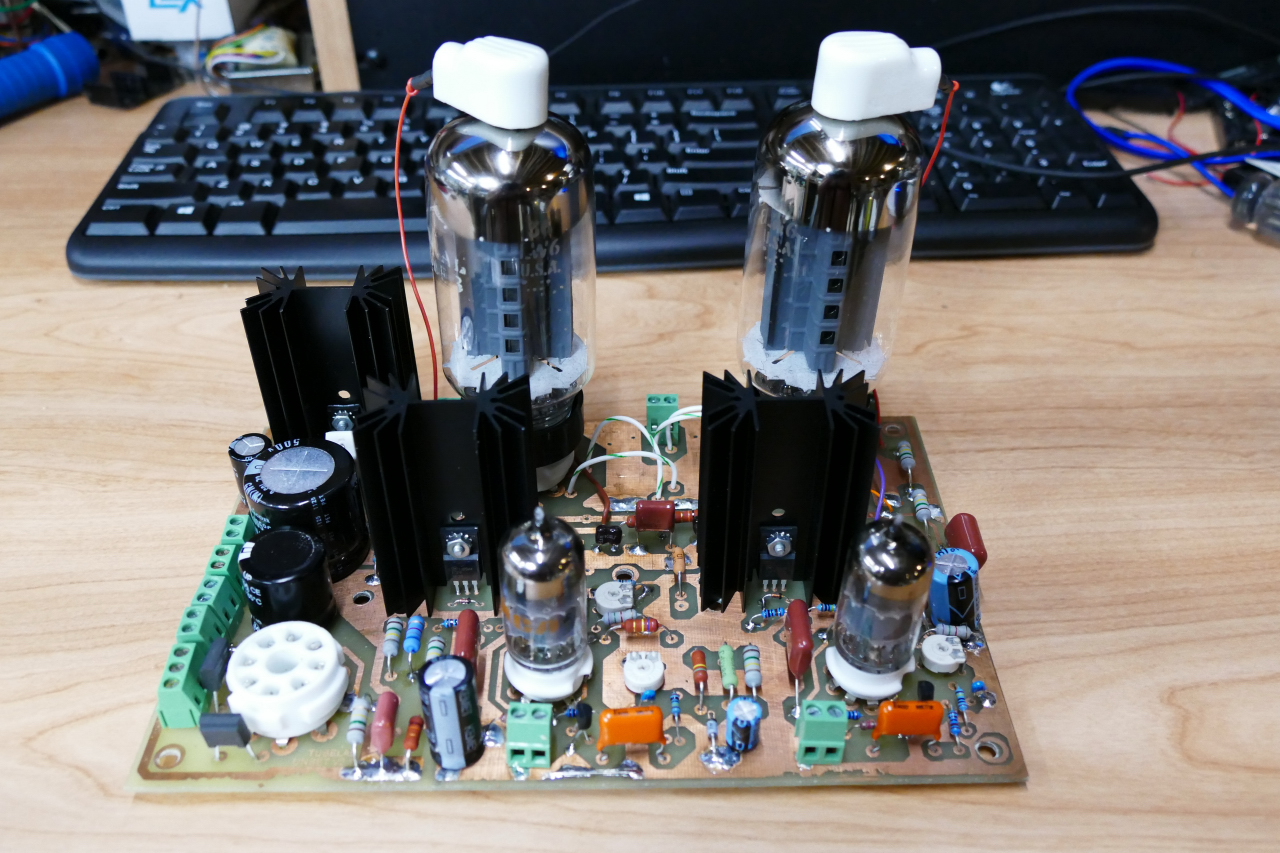

Here is a picture of the test setup that led to the "offspring" board. There is a dead fet in the picture. I don't know the number because it went into the trash when I cleaned up the bench. It has an isolated case, so it is not a FQP3P50. The picture was taken in June of 2018. My box of fets has a bag of 10 FQP3P50's with 4 parts missing. Obviously I moved on for a reason. Much of my testing was done with 6HJ5's which are capable of a lot of plate current. After one cracked and another exploded due to shorted fets, I switched to the 6GF5's they are smaller and cost $1 each. The offspring board is actually laid out to accept either tube (hence the funny schematic around the output tube), but I have not tried 6HJ5's in it yet.
I had the offspring board on my bench to take some pictures a couple days ago before ripping up the driver. I noticed a bunch of circuit modifications done some time ago. The third picture in post# 2 was taken Thursday. The fourth picture was taken about 2 years ago. The schematic of the board as originally built is included here. I took the feedback from the plate of the output tube to the screen grid of the driver instead of the control grid as you have done. I am using driver tubes from the $1 list which are TV IF amp tubes, and some have undocumented semi-remote cutoff characteristics (verified with a hammer). I am also using the driver as a LTP phase inverter, so there is a CCS in the tail, with input to the control grid. This works great for a narrow range of operating points, and I find myself turning the CCS pot every time I fire this up, or whenever the heat pump kicks on (line voltage variations).
The little 20 watt 50C5 board used two copies of the UNSET in push pull driven by a split load phase inverter made with a mosfet, so that's where I'm going here.
Once that's working, I'll try moving the feedback to G1 and adding a CCS in the plate. I have a small guitar amp with a CCS in the plate load of a pentode for stupid amounts of gain in a single stage. Running a $1 pentode at a stage gain well over 1000 makes for a very microphonic amp.

I don’t see any reason why you couldn’t drive the cathodes with a big rugged bipolar. Doing a darlington or CFP with a smaller low capacitance mosfet would certainly beat the high input and reverse capacitances you’d have to deal with to get a mosfet that can take as much abuse in the linear region as an MJL 4281. The first time I saw anything like this it was in a Peavey guitar amp - they used TIP3055’s to drive the cathodes oh 6L6’s. G1’s were grounded, so no local NFB - which meant a Hiiiiiiigh output impedance. They did clamp the output with diodes, to keep from arcing over or ruining output transformers.
I've sketched up an attempt at this approach (output plate to driver cathode feedback) on a Unity-Coupled amp and I have to say it works out beautifully. Instead of having the feedback resistor attached to output tube plate, it can be attached to output tube cathode and there is no huge DC offset heating the feedback resistor all the time.
The feedback network can also be set up like the input stage of an instrumentation amp, like I tried to do up above, but there is no CCS required to pull the network down to the level of the input tubes. It is already sitting at just over a volt, which works fine.
Very simple and elegant.
I'm almost tempted to do surgery on my Unity-Coupled amp right now, but I'll enjoy the glow of the 841s a year or two more while I build my SE amp.

I am using two different fets now, one is 13 pF and the other is 27 pF so for now the OPT is the main bandwidth bottleneck.
If I stick any silicon in the signal path of a tube amp it is a follower, either mosfet or BJT. I have some older MJW21195's left over from some CFP experiments involving a tube / BJT pair for output stage duty. I could try some of them fed by a small signal mosfet.
