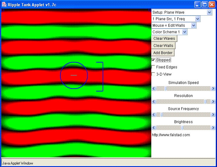

Hi DLR,
You are obviously 100% correct that constrictions--specifically with acoustically significant Z dimensions (say, a thick baffle with straight cut)--display Helmholtz behavior that is easily measured. A constriction without an acoustically significant Z dimension would present mostly flow resistance. And then there's the coupled air mass behind the cone. What do they equate to? Acoustic analogs of L, R, and C--very useful tools when deliberately tailored to refine the bandpass behavior of a transducer, not things to be avoided like the plague.
As I mentioned, there are a few reasons I don't want get much deeper into this, but I think you see where I'm going. Acoustic solutions for acoustic problems.
Yes, tweeter pole vents do make themselves known, but you're again referring to a port structure here with Helmholtz behavior in the passband, not as I was to an individual obstruction (basket leg) in the cone's pressure zone. Also, basket windows are far less likely to act as simple resonators. Their geometry is usually very non-uniform and/or their z dimensions are often acoustically insignificant.
Getting back to the question of basket leg reflections, here's a Ripple Tank sim of an obstruction approaching 1/4 wavelength in width and about 2 wavelengths from the source. I've drawn a circle around it to highlight it, and I've noted the approx. wavelength beside it. Note that even at ~1/4 wavelength wide, the perturbations (reflections) it causes are very minor.

Most of that's pretty standard
My points were two-fold. First, there may be some specific advantages for a specific driver to incorporate some kind of resonance, but the typical driver has no such need. Past drivers are replete with poorly designed baskets that did indeed introduce resonances that affected the passband, though the true nature was not evident to many.
Your statement here
Specialty driver manufacturers, of which I am unaware so please provide some direct links if you have them, should be able to sufficiently explain specifically why they are designed as they are.
The fact that the majority of drivers would and most did suffer from bad baskets is not flawed thinking. Rather the other specialty driver makers simply have to do a better job of their own marketing to distinguish themselves. There's no flaw involved.
Second, I wasn't thinking in terms of basket reflections, just the comment about the width that seemed to be generalized. The basket legs are made narrow, but strong primarily in order to reduce the Helmholtz resonance so often exhibited in the past. I agree on your reflection point WRT to basket legs, I have found little evidence of reflections on the interior sections of the older, wider legs. There is no disadvantage, however, to making open, narrow-legged baskets that I'm aware of. Acoustic solution to an acoustic problem.
It really doesn't matter that people thought that the problem was reflections off of the leg or the motor rather than a Helmholtz resonance of the air through the openings, they were phenomena related to the basket construction and the baffle cutouts. The problem was real, not imagined. Open baskets pretty much minimize this. Why would a manufacturer NOT advertise this aspect?

Ok, I guess we're basically agreeing here.
I don't at all dispute that poorly designed baskets--ancient and recent--and thoughtlessly done baffle cutouts have caused real problems. It's akin to tossing a few random elements into a electrical crossover network.
And there's nothing wrong with putting a very open basket on your driver products and highlighting the fact that it isn't a horrible design with spurious resonances.
What I don't like is the implicit (sometimes explicit) idea that anything but a wide-open basket is bad. This idea closes people's minds to the possibility of using deliberately designed-in acoustic R, L, and C elements to improve performance in ways that would otherwise require additional electrical crossover elements, and in other ways beyond the reach of electrical networks.
