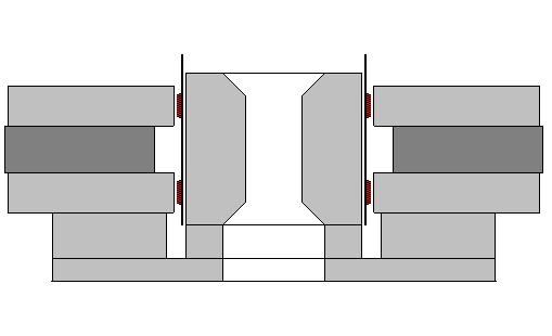

Couple things to note...
Ferrite has a POSITIVE temperature coefficient of coercivity. That means the hotter it is, the harder it is to demagnetize (it gets stiffer in terms of coercivity). This is also the situation where you have large fields, and higher power heating. The harder you run your driver with a ferrite magnet, the better it gets from a sag standpoint.
The BH curves for AlNiCo in the 2nd quandrant for typical blends (AlNiCo 5, 6, and 5CC grades) are considerably softer than Ferrite or Neo. And the knee it as much lower flux levels that Ferrite or Neo (see http://www.arnoldmagnetics.com/products/alnico/alnico_cast_curve_5-800.htm for AlNiCo curves, and http://www.arnoldmagnetics.com/products/ferrite/ferrite_AC-5.htm for typical Ferrite curves). Your droop with AlNiCo from voice coil fields is much greater than Ferrite, and in fact you can permanently demagnetize the AlNiCo magnet at much lower power levels than Ferrite.
For instance, assume a voice-coil induced field of 500 Oersteds. With typical AlNiCo 6, you're down 30% as compared to no voice coil field. For Ferrite (at 20 deg C), you're down ~2% at the same voice coil induced field. In fact, you'd need roughly 5X that field (2500 Oersteds) to get the same loss in Ferrite as the AlNiCo.
Ferrite, when it does drop, does so dramatically and quickly; it reaches its limit and "dies" quickly. AlNiCo drops off at a much slower rate, but starts a lot sooner.
AlNiCo's saving grace is that it can handle high temperatures and has high remenance as compared to Ferrite.
Ferrite gets better as you heat it (up to the Curie point), has extremely strong coercivity, and is low cost.
Neo has extremely high remenance, handles temperature OK (not as good as Ferrite or AlNiCo), and has very high coercivity.
For magnets in dynamic fields, you should be concerned with coercivity first and foremost. AlNiCo simply comes up short in this application. Yes, it can take higher temperatures, but rarely if ever is motor warming a big concern. For high power situations where you would get heating, you have VERY strong field strengths, meaning coercivity is the issue.
It's like BL versus power compression. We all know what power compression is, but it's a long term effect - it takes time to happen. Loss of efficiency due to BL compression (BL drop with excursion) is instantaneous; it happens on every cycle. You can add all the cooling you want to the motor, but you can only cure BL compression by designing a flat BL curve over excursion.
Likewise with magnetic strength. You can cool or heat a motor as much as you want, and over time (minutes of time, taken to heat up a motor structure) that may make a difference. However, on the VERY FIRST big peak of music, we're reaching coercivity modulation - lots of voice coil flux to counter the magnet's own field. AlNiCo simply doesn't match Ferrite or Neo.
In the case you're arguing for - dynamics without power/temperature concerns, AlNiCo is actually a worse performer because of the low coercivity. It is high temperature situations (like PA use) where AlNiCo shines its best (which is, IMHO, still behind Neo and Ferrite).

Yep, definitely hysteresis curves! AlNiCo has very soft curve; Ferrite is quite square. Neo is darn near a perfect square! AlNiCo starts losing strength quite early and easily - it cannot hold up its own field very well at all in the presence of an external magnetic field. Ferrite and Neo do a lot better.RussianBlue said:You're observations on loudspeaker nonlinear behavior are quite fascinating, thank you Dan. I think that Bill was worried to what might happen to the magnetic properties progressively from small signal (small heating) levels on - I presume that there is no "on/off" behavior but a hysteresis curve, which most likely would be different for different magnet materials. Very few of us, I believe, will operate loudspeakers at "close to destruction" amplitude (unless you are a PA professional or dance club owner) - what are your observations as far as magnetic material influence goes, for small to medium level applications?

If you're using an amplifier analogy, you can think of remenance as output power, and coercivity as output conductance (inverse of output impedance). A high remenance would mean a high power amp - you can generate a lot of output! A low coercivity (low conductance - high impedance), though, means that as the load on the amp gets harder (lower impedance), the amp (magnet) has more loss (lower remenance) in output power (flux).
You get more "modulation" of the signal on the load with a high output impedance (low conductance); likewise with a magnet that has a low coercivity - it cannot maintain its field strength, and so the BL of the driver drops (and with it the attendant loss in efficiency, gain in Q, etc).
