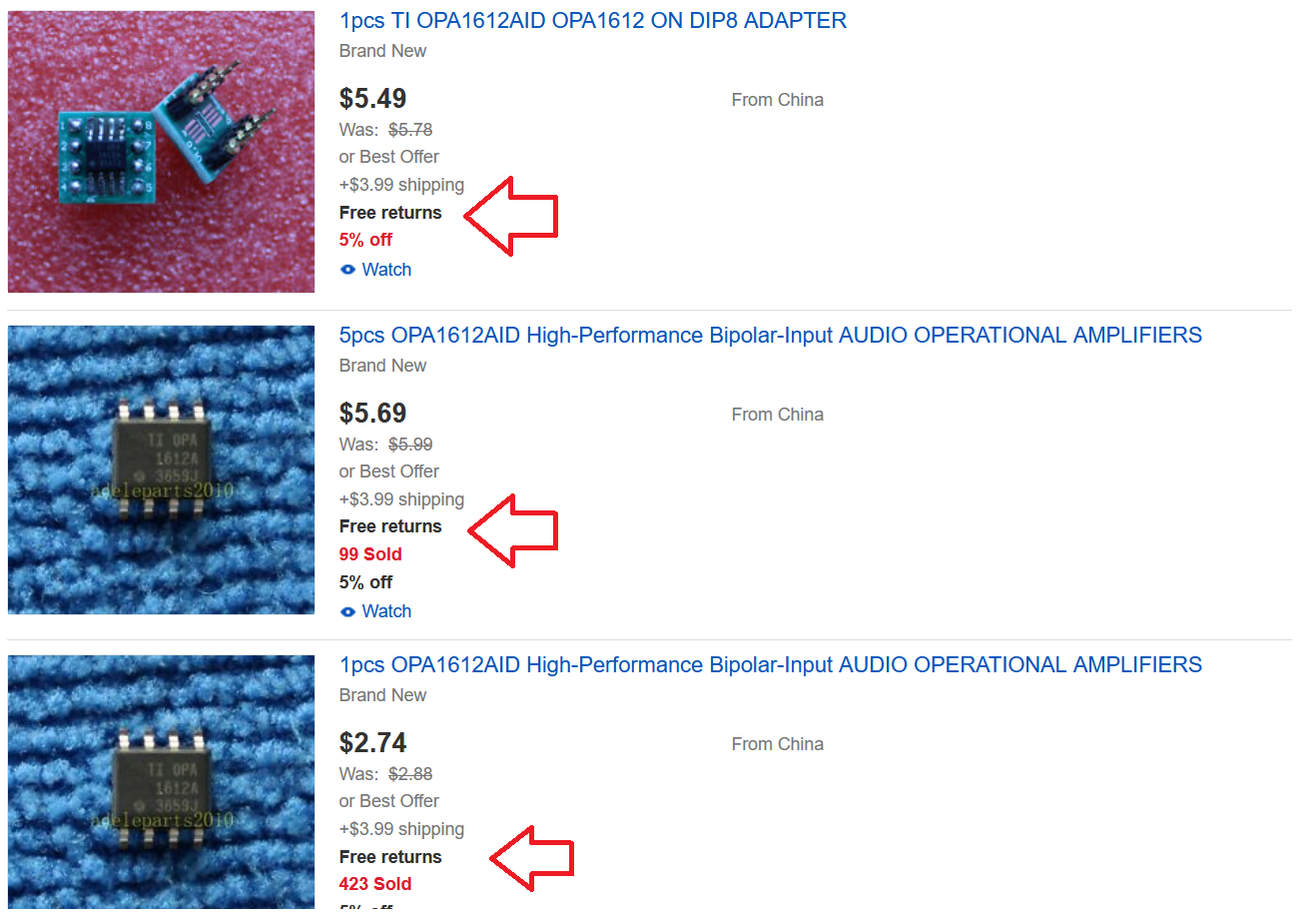

Does your eBay listing say "free returns"? (See attached image.)
It says
Returns:
Free 60 day returns

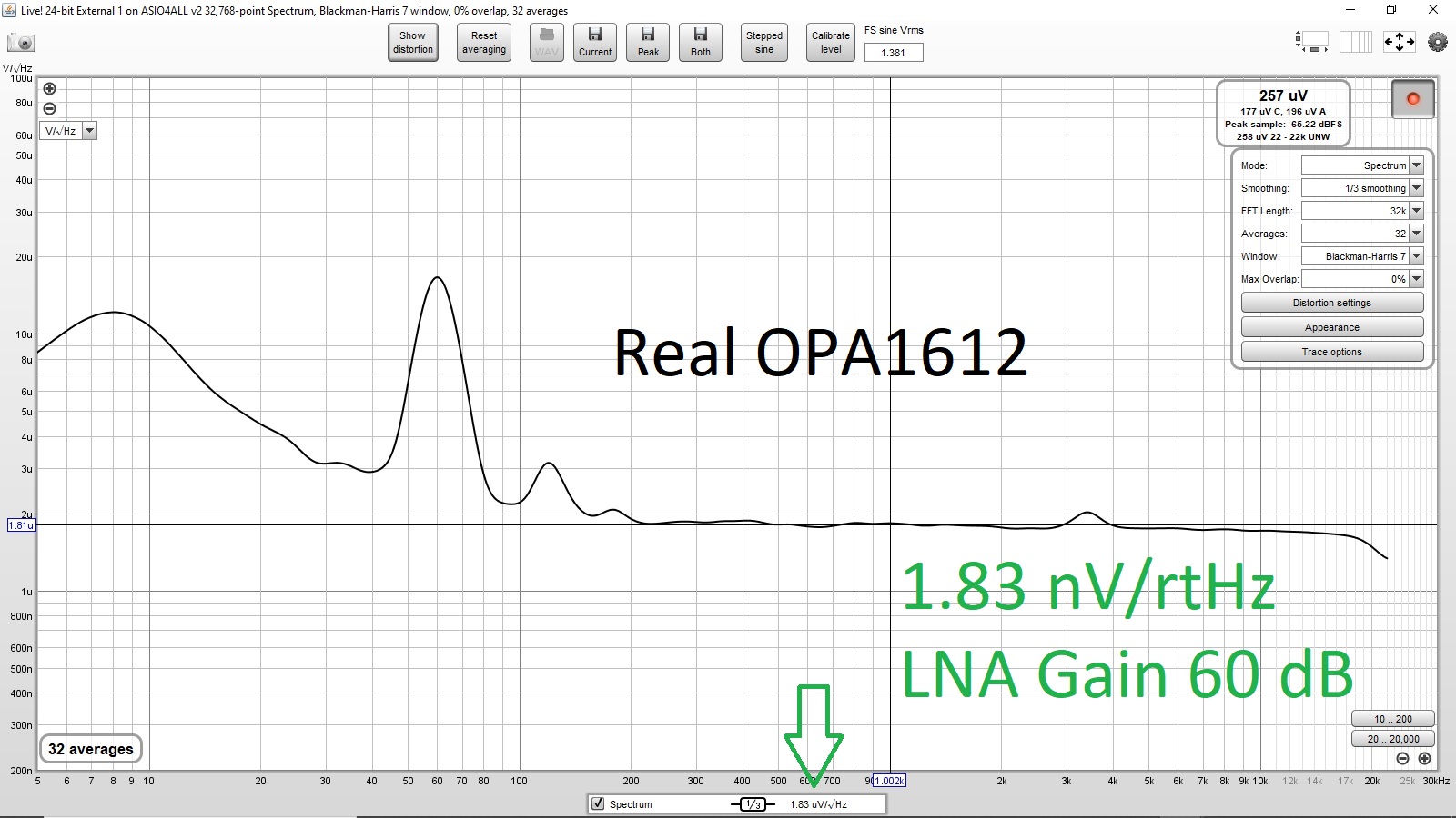

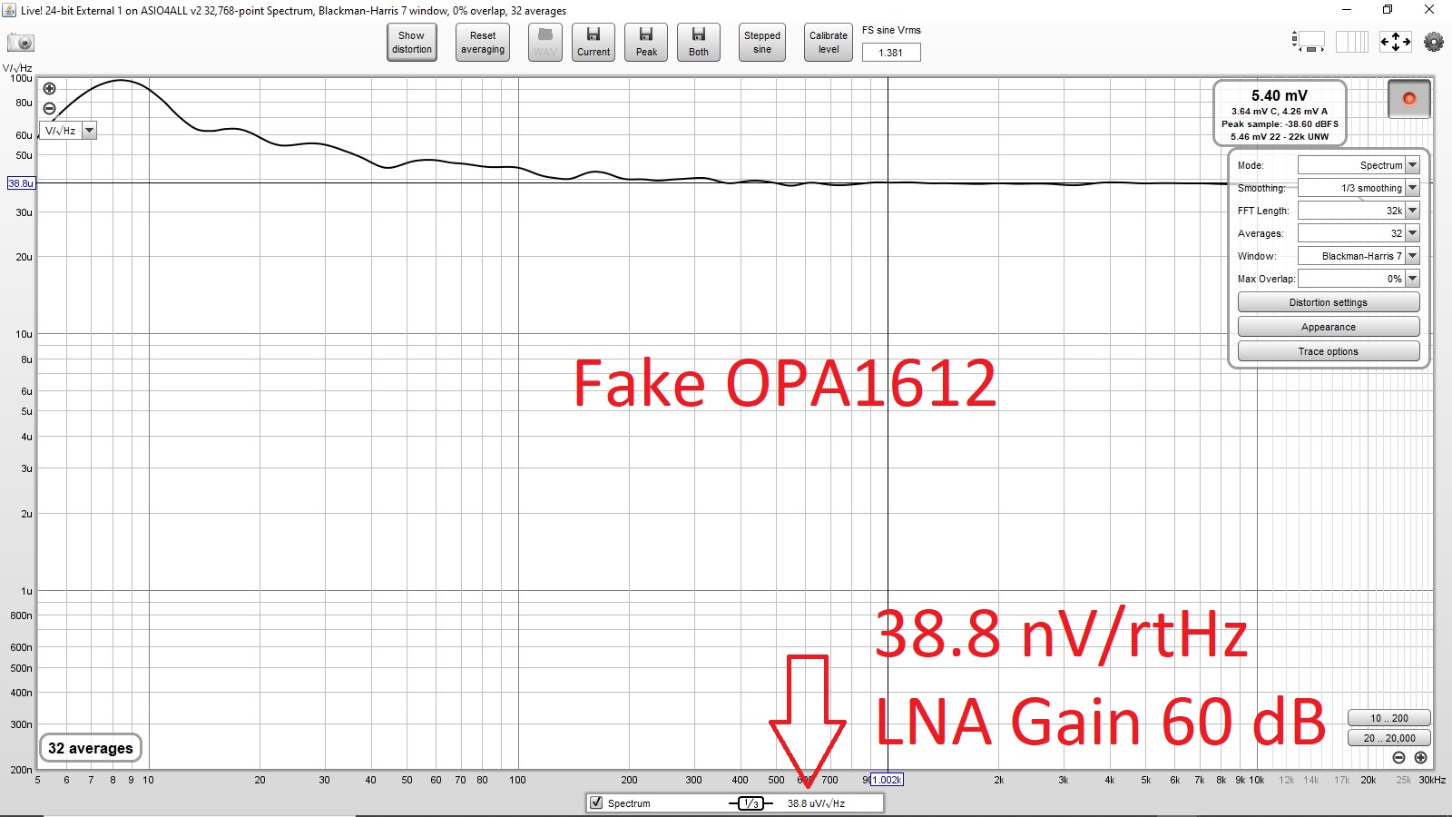

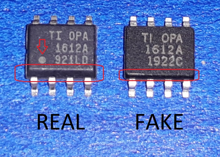

Please see the attached images for your answer. They are totally fake. Noise is terrible and package molding shape does not look like my genuine reference sample.

The photo for the ebay listing looks like a real OPA1612, as usual. Funny how the fake sellers always seem to know what a real one looks like for their listing photo.
Yet when you complain they suddenly know nothing and they are just a trader.
