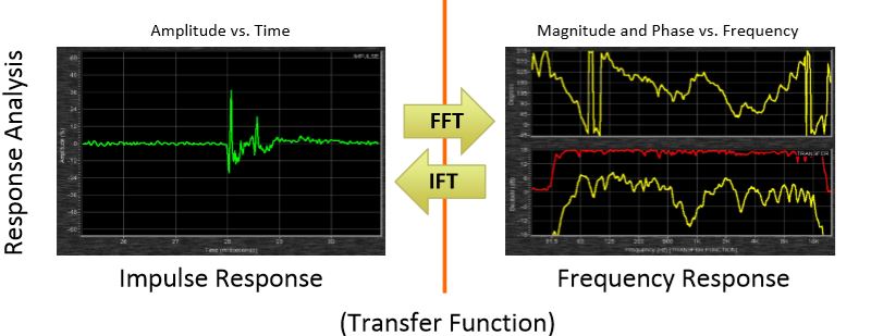

Like soundbloke, i also naturally think of frequency response as including phase, as being complex, being comprised of magnitude and phase vs frequency.
Which automatically brings mathematical equivalency between impulse response and frequency responses as per the chart below ( snipped from Rational Acoustic's manual).
The real beauty of this equivalency imo, is that perfectly flat magnitude and phase = a perfect impulse response, which = a dirac pulse, which also = perfect transient response.
An image of a dirac pulse that I've found very helpful in equating it to transient response goes like this.....
Take every frequency from 20Hz to 20kHz, or whatever you consider the audible range.
Simultaneously and instantly, produce every frequency.
That will mean the initial rise of every frequency's wave, starts at exactly the same time.
That is what perfectly flat mag and phase does.
It time aligns the initial start, the very first sample, of every frequency if simultaneously excited.
And its impulse response will be the summation of all those first samples, a dirac pulse.
So in the end, transient response simply equals FR response, phase included.
Hope that all made sense...
