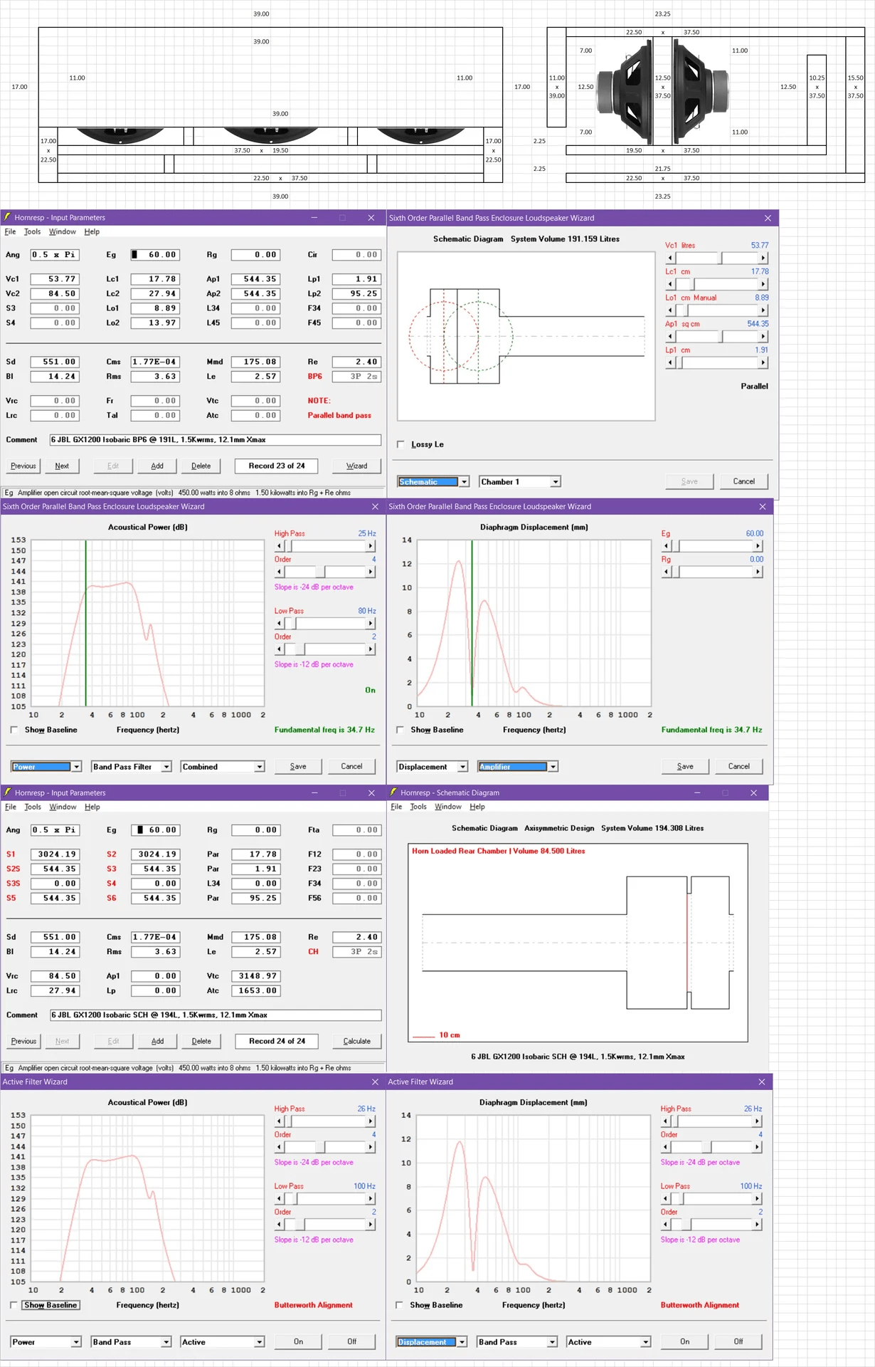

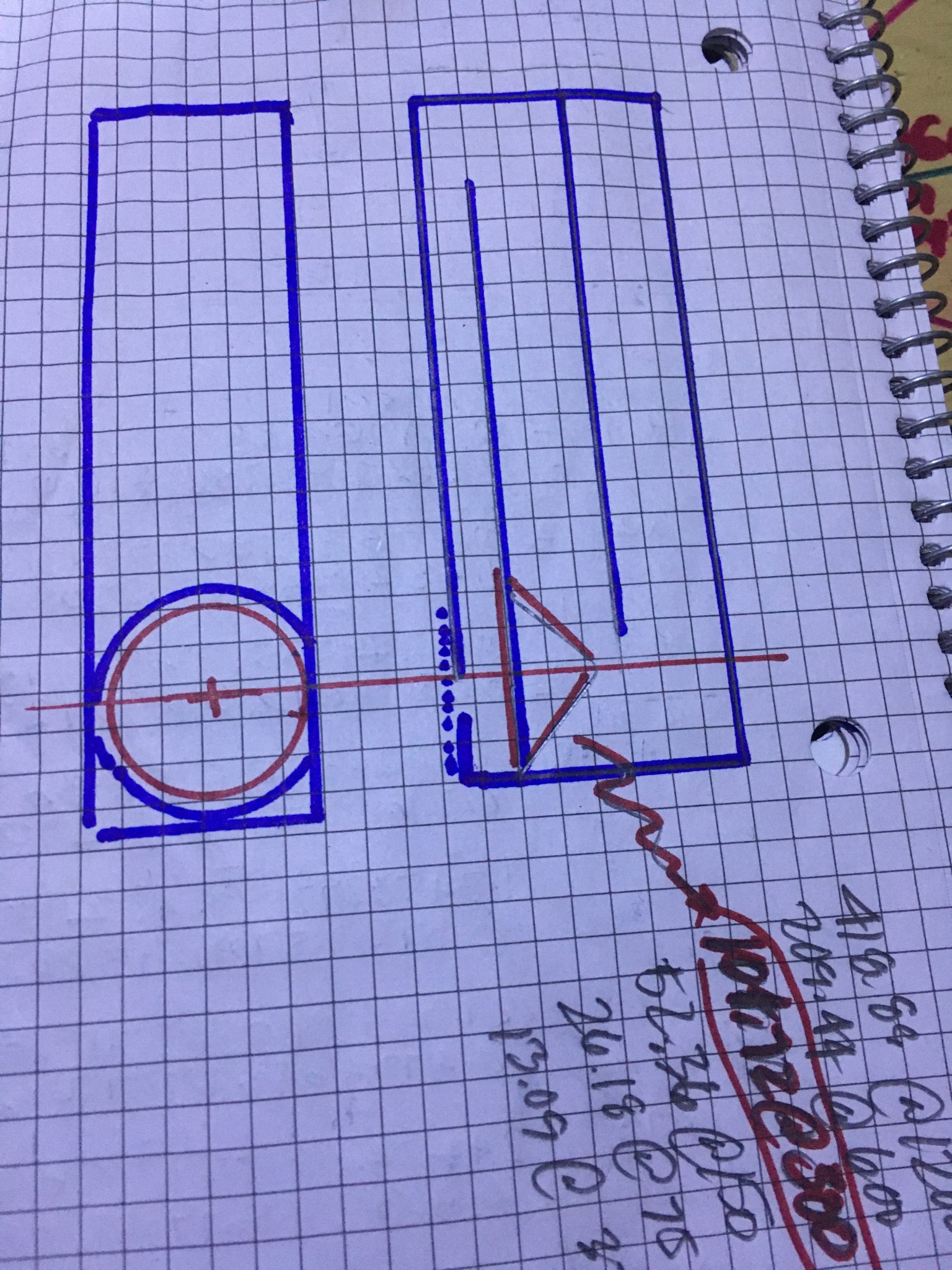

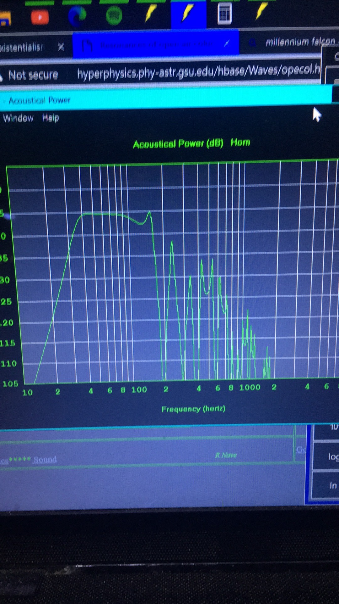

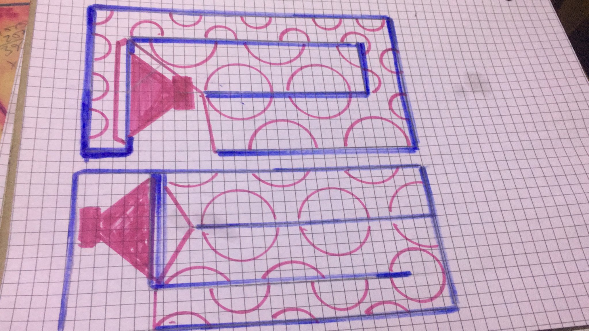

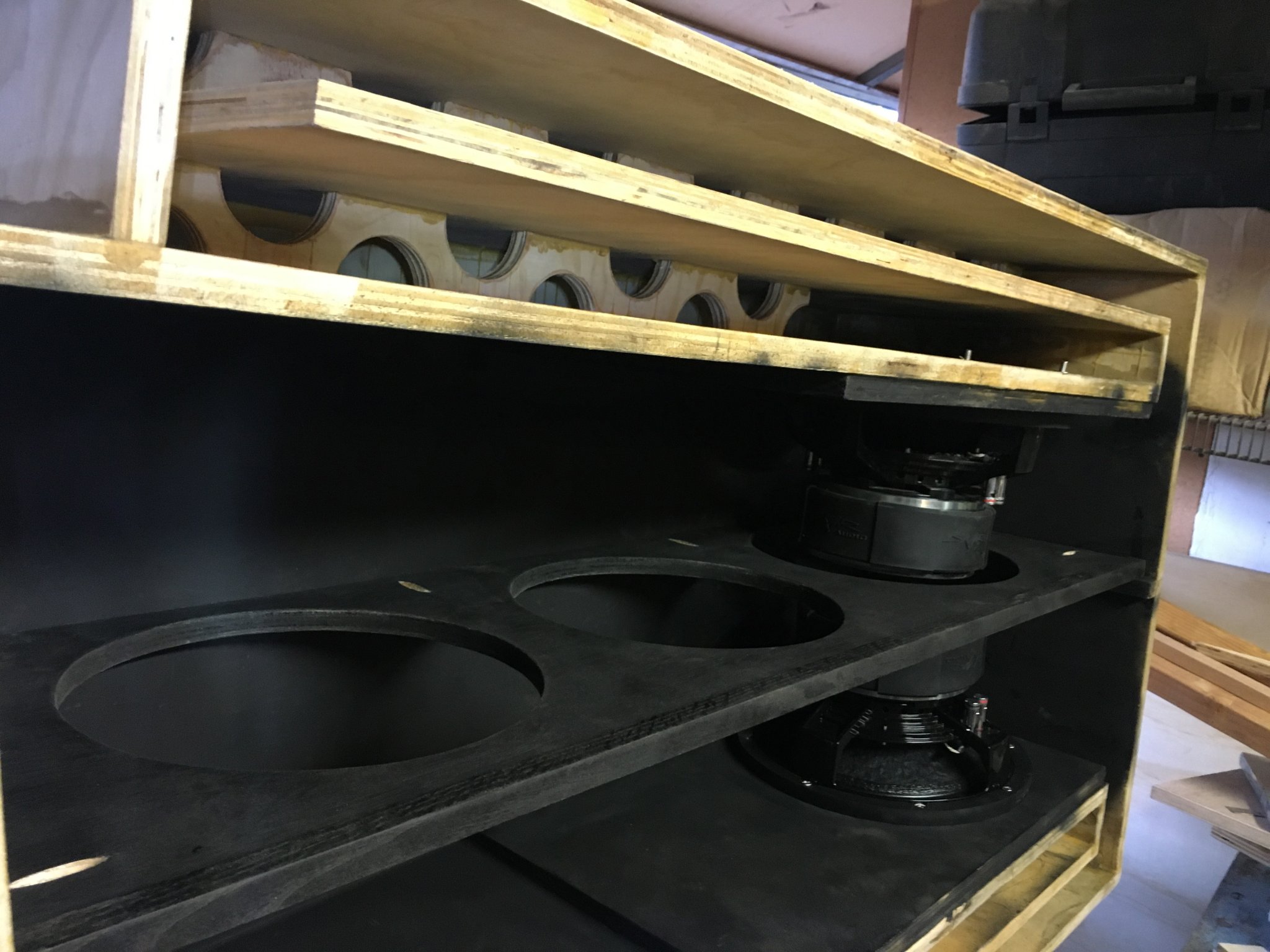

if building for this driver:

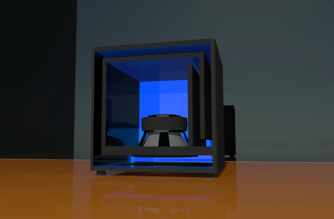

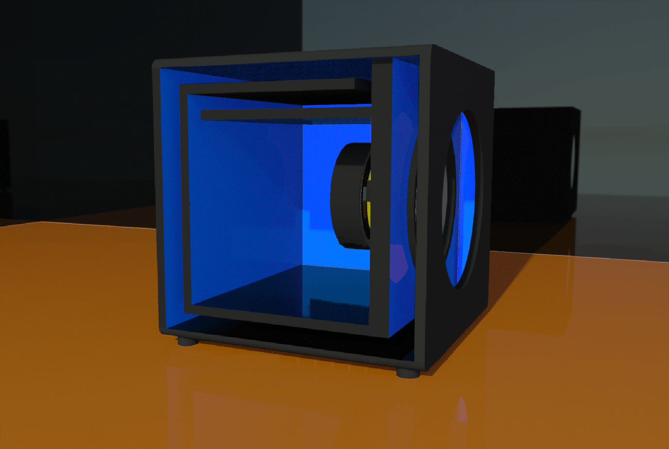

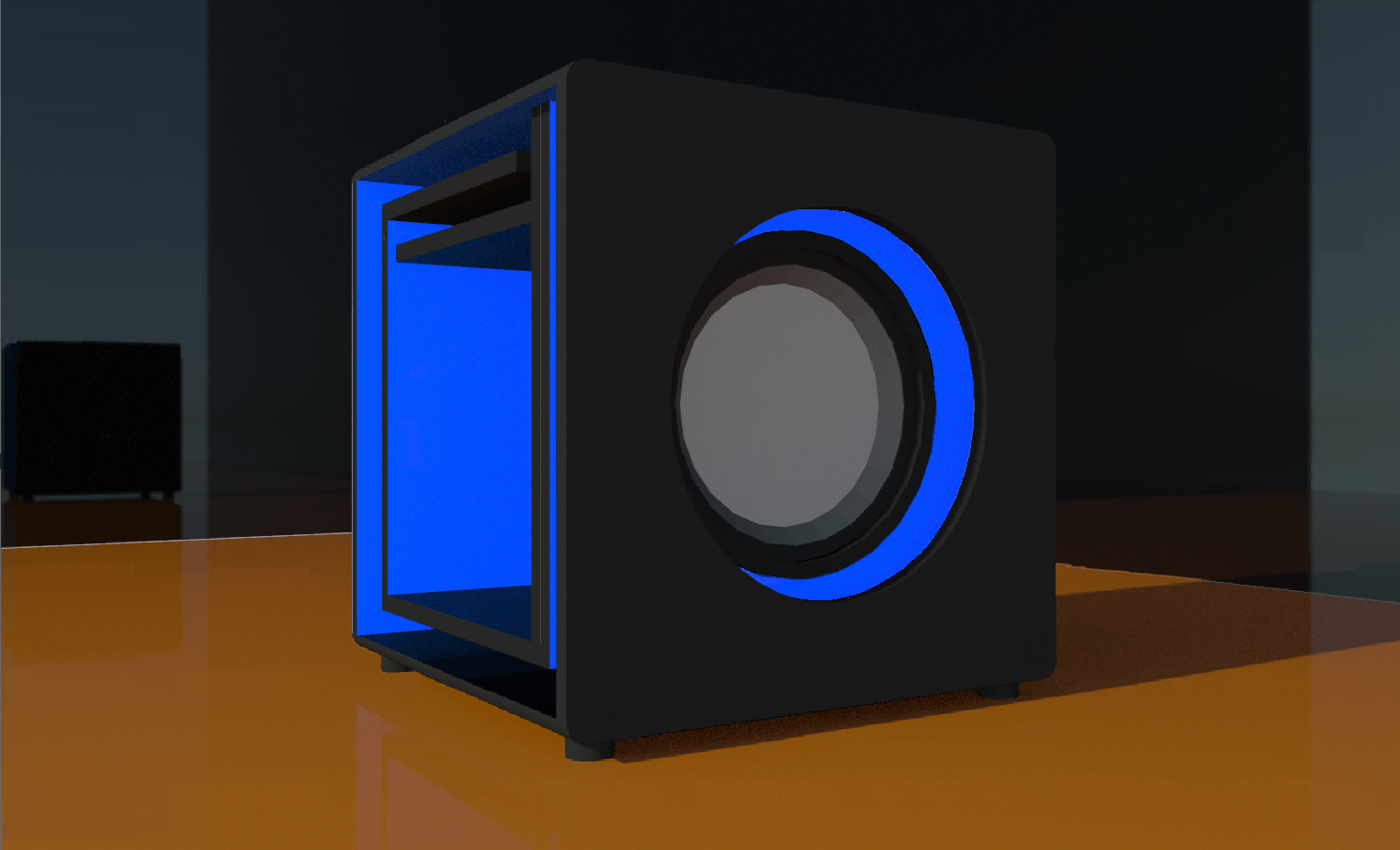

Roar: make two TLs for the drivers (horizontally opposed ) and place driver offset at one if the pressure nodes fit the 5 or 7 1/4 harmonic as seen in HR.(imagine a pendulum swing breakdown of the TL to ‘align these peaked and valleys seen out of band initially
then make a 4x the csa wave guide/ 2/4 resonator(call it whatever you like) built at velocity max for that TL (exit essentially).
and BaNG very hard with a very obvious(loud and brutale) 8th order qw pipe
PS: Dont mess up
your back!!!😝😝

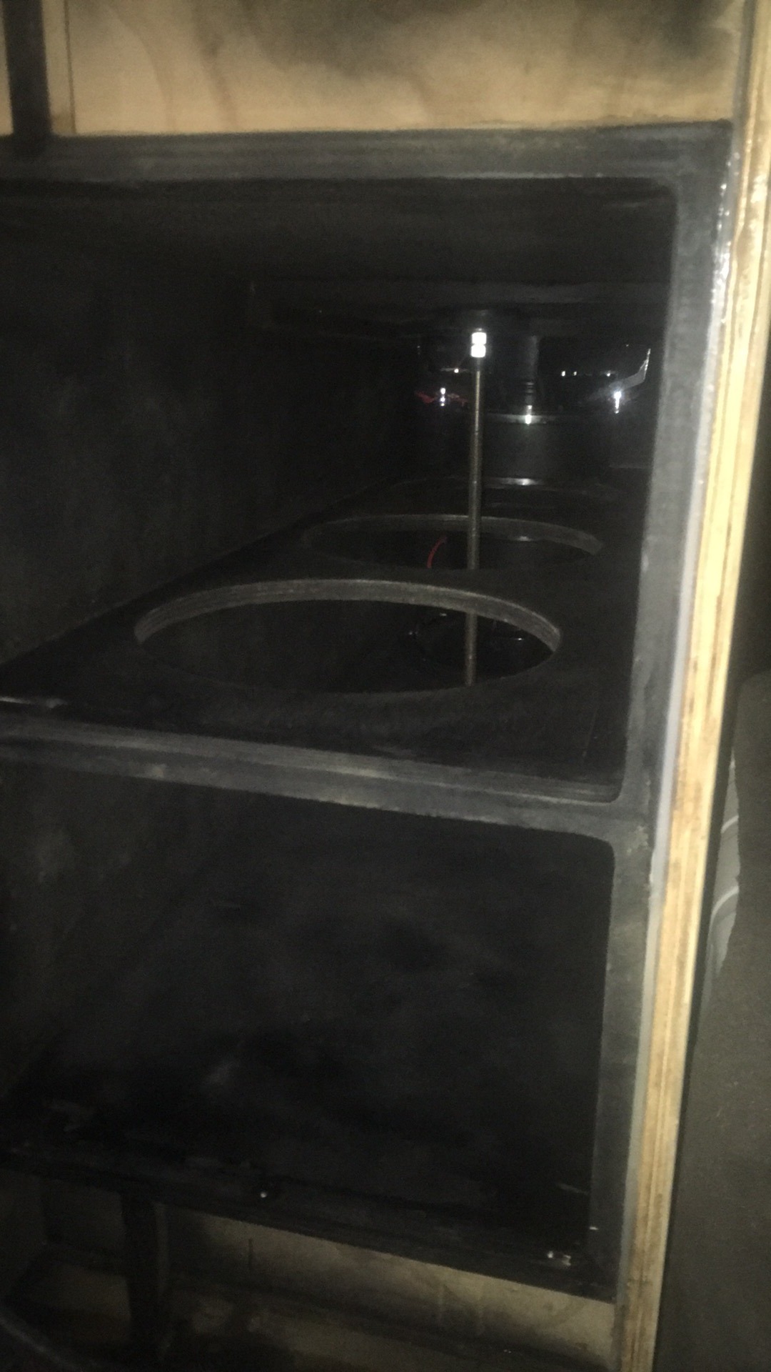

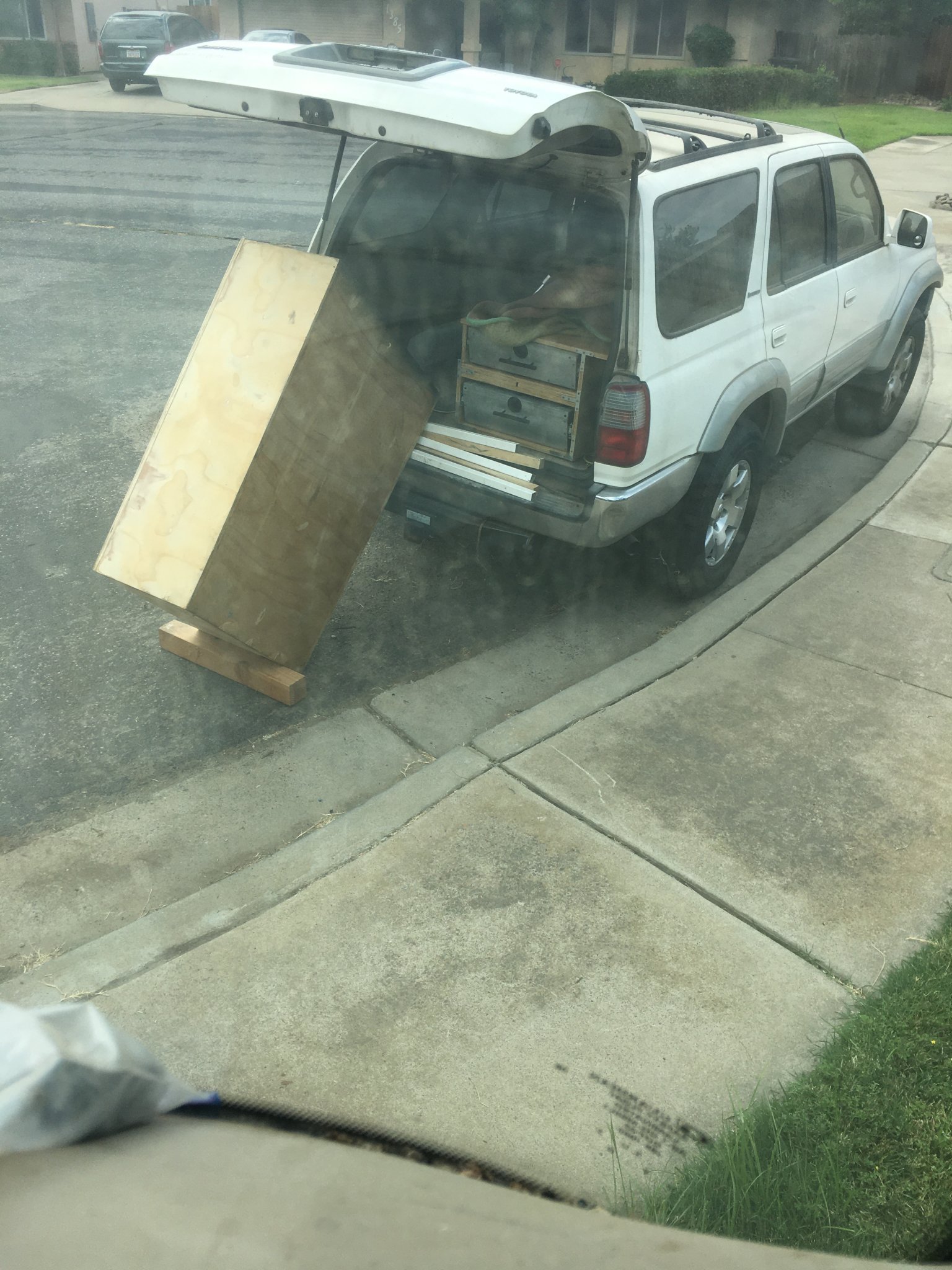

Talk about not messing up...LOL!
Please tell me that enclosure is not falling off the back of that Explorer?!?!?
its in now(But boy are they ridiculously top-heavy and want to tip over like a crocodile does when it twists around its prey what’s clamped on😝😝😝
I don’t ever want to pick one of those up and Fish it in like that again I should’ve took all that toolbox and drawer assembly out
regardless these things rip!!!! The TL with the exit right back onto the driver at vmax to that secondary resonator is something else!
but now we’re already moving on to three Dayton Umax 18s in a parallel arrangement.

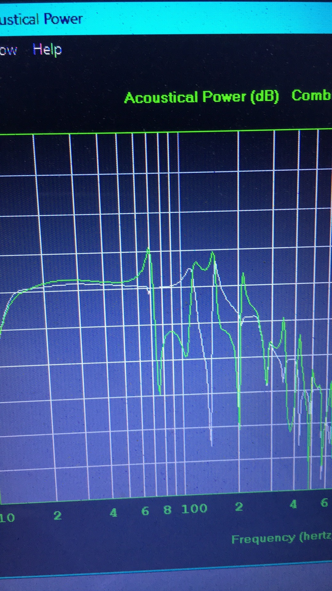

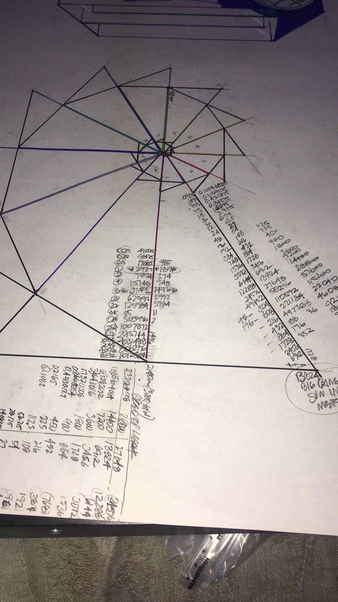

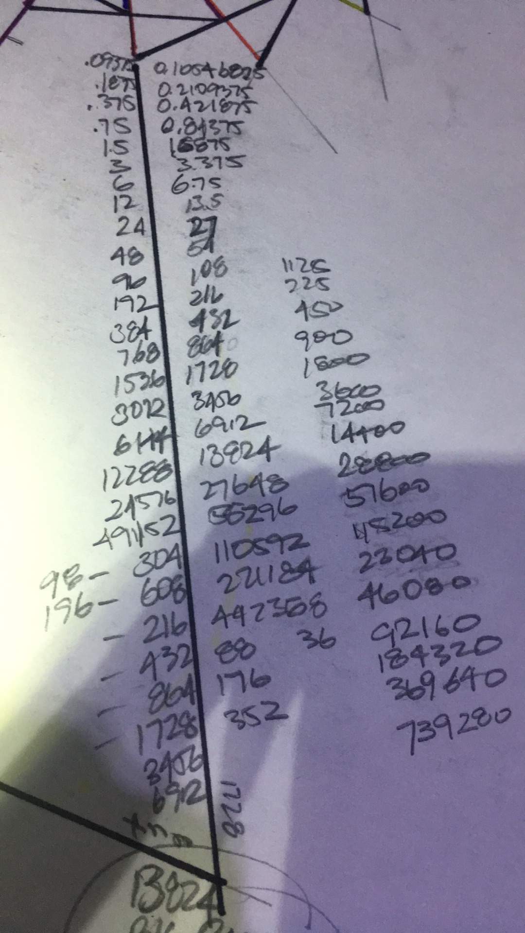

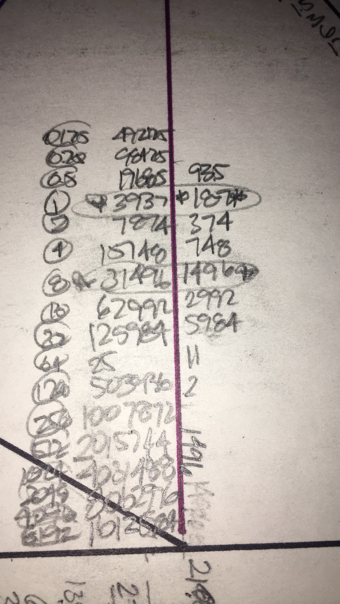

its weird as fawk! but its all the same … Past, present or future(metaphorically kinda) it’s just a rotating thing that repeats and all ends up exactly in number is the same way as it does in frequencies (numbers) and then (in angles on a circle) and then in wave lengths as circumference /harmoinc and then… you reach 1.

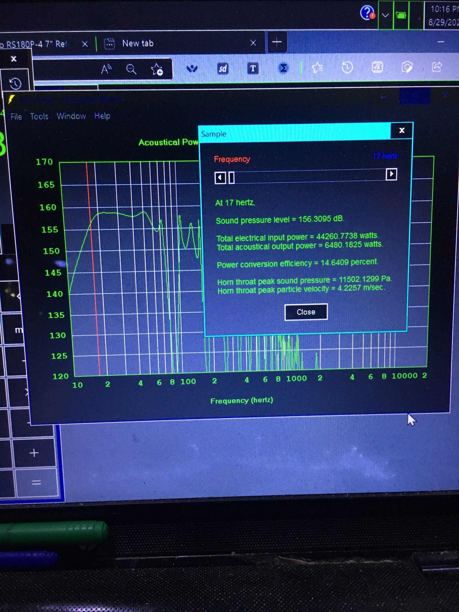

make a spread sheet and design around 3 and 5 👽👽👽👽
but notice what will be a node/antinode in higher order to ‘perfectly align them !!!

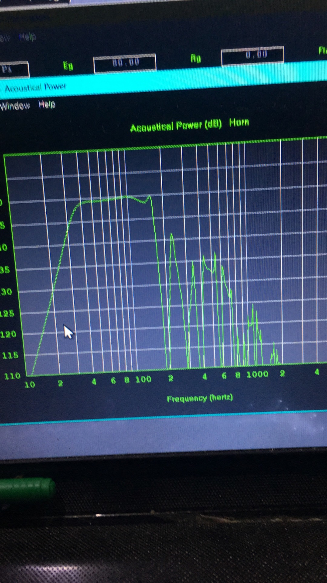

thank ‘phi’ oops, ‘PH1’ mode in HR or OD with red S inputs. this ends up being some of the most ridiculously potent almost excessive subwoofers ever
discover the ‘perfect higher orders just like OD @ 3 x 1/4 H always existed and was intersting to see
its not akways about 0.3490658
its still
‘ timing’ never use top dead center !! grab a harmonic interval always and see the results…. we’re not too old 🙂
