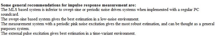

ARTA handles those techniques along with external excitation (like a balloon pop etc) if desired.
Here's a snip from it with some recommendations for what to use when:
