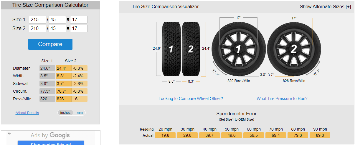

It is nothing like a car tire diameter - let's concentrate on a tire not driven by the engine, just a tire traveling down the road.
See, your tire outer rim/surface is not driven by a motor at a constant speed, it's only driven from the road's movement beneath it, so naturally a larger tire will revolve slower at a given MPH, and vice-versa.

And yes, if the motor, idler, and platter were all the same diameter, the speed would be the same for all.
BUT.... if you had a say, 1 inch motor pulley//shaft, and a 1 inch platter, then ANY size of idler would result in the same platter speed as the motor.
It doesn't matter - the idler ONLY transmits what the motor is capable of to the platter.

But deviations from the diameter DO influence the speed, since the distance between the point touching the motor wheel and the pivot of the idler is not the same than between the point touching the platter and the pivot.

No, I am not wrong. A dent in the idler causes wow. No spring can compensate a deformed idler.Sorry, you're wrong there.
