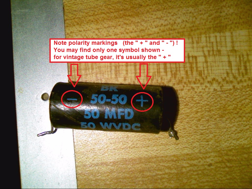

It's easy to spot electrolytics in tubular aluminum "cans", ranging roughly 1/2" to 2" diameter and 1-1/2" to 6" tall. They are usually secured to the chassis or circuit card assembly by twisting, or bending over, small metal "ears" that go through slots in the chassis or board. The aluminum casing is almost always the negative terminal, though occasionally you might find one where both the " + " and " - " terminals are electrically isolated from the case. The most common use for these is power supply filtering.
The atch photo shows the other style of electrolytic you may encounter. Note that it has polarity marking - though some manufacturers only mark the " + " terminal. This style is commonly used as the cathode bypass capacitor or possibly the filter in a bias supply. The actual capacitor is also enclosed in a tubular aluminum can, but a cardboard sleeve is wrapped around the can so the construction isn't obvious at first glance. Nevertheless, you might encounter an electrolytic capacitor like this without the sleeve, just the naked aluminum tube. The value and polarity markings could be applied with ink, or stamped into the aluminum.
Dale
