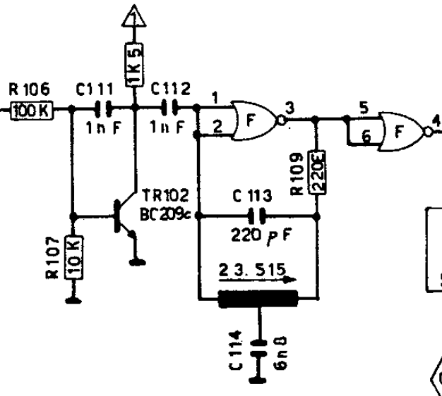

I'm repairing an old organ, the previous owner tried to tune it and destroyed what was probably a trimpot (which is now totally missing).
According to the schematics, the part "number" or "name" is "23.515".
I've found pictures of the missing component: Infrequent Sound [sex.tex] technology: GEM Galanti Group Rodeo 49, made in Italy
My missing part is the bottom left potentiometer.
Does this "23.515" refer to something standard ?
Thanks for any advice!
Oh sorry, I obviously posted the wrong link.
According to the schematics, the pot is connected to a MC14001CP CMOS gate.

Could be a bridged-T feedback oscillator. Some organ fan will have to give you the info on the inductor.
It's adjustable to set the frequency. Might be possible to replace this with another oscillator circuit.
I see two 30-some-odd gauge magnet wires going into that device. That suggests to me *variable inductor*, not pot. It might make sense in an oscillator circuit.
You're right, the missing component looks like a variable inductor.
The tone generator is a MK50241 which seems to expect a 2MHz Clock on pin 2.
I'll have to find reference schematics, close to this one and extrapolate a proper range value.. wish me good luck 🙂
No clue on Digital stuff, but IF that were a resistive trimmer , I see a "T" filter made out of C113 - C114 and both halves of said "trimmer"
IF an inductor, it would be a center tapped one, obviously adjustable, and in both cases presumably part of a tuned circuit, either RC or LC
I would expect to find 12 of them, so 11 other "23-515" parts elsewhere.
or very similar, perhaps 23-512/513/514/etc. if each note needs a different value one but same basic function.

I'm still investigating and I found this (the place where the 'guy who sweeps the fooor'.. 😀)): Generalmusic Spare Part Codes – GEMClub | Generalmusic Owners Club
There's no reference to a 23.515 (nor 230515) component, but around "23-something" we have the
- 230521 : "Yel Dot Tuning Coil 10-20uH"
- 230526 : "Blu Dot Tuning Coil 1.2-4.6uH"
According to photo, the 230515 is progably the "red dot" version 🙂
Sometimes, you need luck ...!
Since I know that the Blue dot tuning pot is around 5uH and the Yellow is around 20uH, I can guess that the red one is probably something between 1uH and 100uH.
I have a few K102 inductance in stock (1000 uH), so I tried to use two of them and replace the missing adjustable inductance. My plan was to measure the output Clock frequency (which is supposed to be precisely at 2MHz), and guess a more approriate inductance value.
And.. it works ! Clearly not in tune (middle C is at 446Hz), a few octaves too low, but well, it plays sound !
