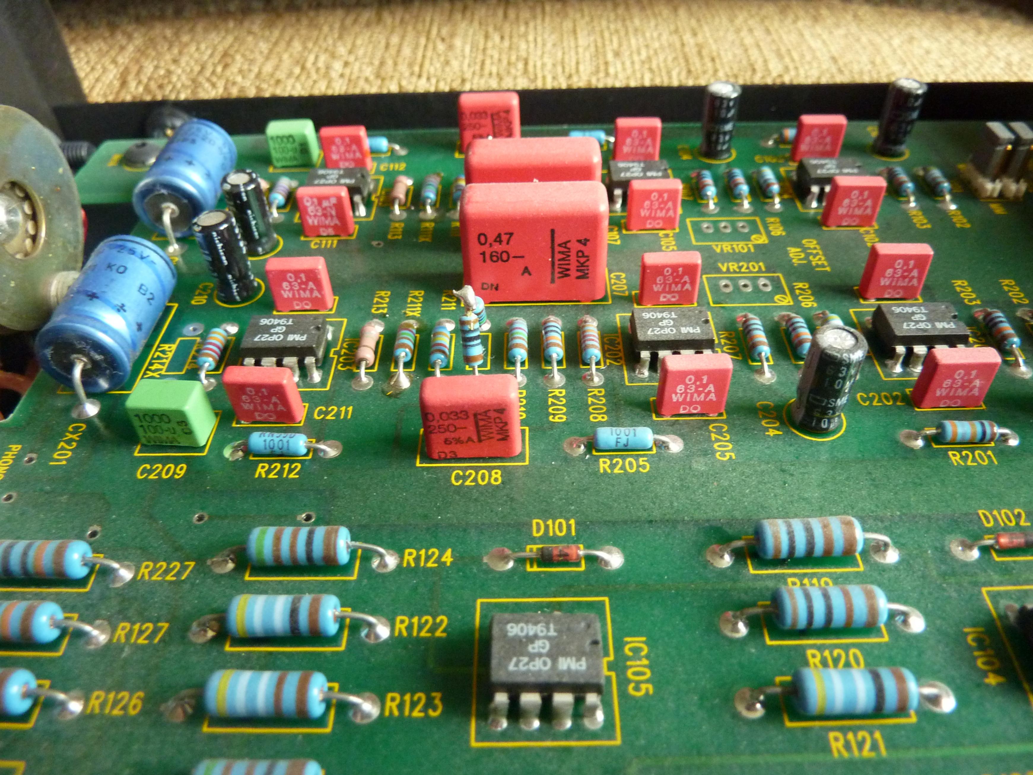

Identify some Wima caps?
My preamp has a number of Wima film caps. The larger ones are MKP, but the smaller 5mm ones say 'DO', as in 0.1, 63-A, Wima, DO.
Any idea what these 'DO' are? They are in a 1993 Classe preamp, original spec.
I used information from a 1995 WIMA catalog I have. The case size and color are two clues. MKP2 parts will be a bit larger and therefore have higher inductance which translates into worse decoupling at high frequencies. With the parts being pin-in-hole, there is some distance between the capacitors and op amps so that printed circuit board trace inductance may dominate. In the end it probably isn't worth changing the MKS2 parts for MKP2 in this application.
Probably Bill is right with MKS2. There are some MKP2 or MKP3 I have im my spare box
with similar lead spacing, but more height. If capacitance isn't critical, it's even more
likely to find an MKP or even FKP3 (film-foil) to fit. Is this 7.5 mm lead spacing (RM7.5)?
The green Wimas are certainly already FKP2s, 1000 pF = 1 nF. Current ones are red
similar to MKP and MKS etc..
Search for the Wima parts catalogue or see wima.com . In many applications there are
sonic advantages for film-foil poly caps, even when they're lower capacitance.
There's an 15 nF ( = 0.015 µF ) FKP3 with 7.5 mm spacing ( # FKP3C021502C00),
which are fine for bypassing. Don't know if the specific value is critical. If the your
current 100 nF caps are indeed MKS2, then MKP4s would be a worthwhile upgrade.

Suspectively the current ones are smaller in physical size. I'd leave them and just
bypass them with a small value FKP on the underside.
As the green Wimas are already FKP2s - I forgot to say, leave them. MKPs are
better than MKS caps, FKPs are better than MKPs.
BTW, "VR101" and "VR201 on the PCB are empty. Is there a bigger model with the
same PCB? If so I'd get the service manual and consider to retrofit the regulators.
