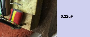

I’m in the process of attempting to renovating a pair of Griffin speakers I bought in 1980.
They have been stored for over 25 years.
As a trial I connected them to my equally aged Sugden Stemfoort amp. The result was ‘over bright’ in fact ‘extremely sharp’ when I removed the bass speaker I noticed that a Capacitor on the three way crossover had become detached from its circuit. On removal Maplin’s and R.S. were unable to identify this faulty component for replacement.
I have now ‘cut’ the crossovers out of their cabinets for closer further examination and found three other similar capacitors which have become separated from their circuits.
I enclose photos of the parts which I’d like to replace. I do not have a circuit diagram to aid identification and guess that the speakers may be: twin ported Aperiodic 27’s
Any help and guidance will be most appreciated, my electronic expertise is limited to the basic level of being able to solder. I understand that even if I’m able to replace what I believe is to be the problem that other factors may surface; but the fact that I was able to get some sound from them indicates that the speaker unit may be serviceable and can then be passed down the ‘food chain’ to my grandson along with my Sugden amp and Aura CD deck.

I believe your mystery part is a 2.2uF 250 volt capacitor (an old film type).
There also appears to be a resistor soldered to it which you would have to identify. There looks to be a bit of discolouration as if it has got hot at some point.
Can you measure a resistance reading across the pair ?

The top cap that is cut off in the image looks to be a 0.22uF. The two below that are 1uF and the one with a leg hanging off is also 0.22uF
R33 as marked on the resistor could be 33 ohm although these days you would take it to mean 0.33 ohm. 33R would normally be 33 ohm. However sticking a 2.2uF cap across 0.33 ohm sounds intuitively a little odd so I would go with 33 ohm at this point.
Try measuring across it on your meter on a low ohms range and see what you get.
Tbh, it all looks very old and those large can type caps might be suspect.

Please confirm: the largest detached capacitor (red body,green and white stripe) 2.2uF 250v
Smallest capacitor shown ( brown body, red, black, yellow ,red.stripe) 0.22uF
Mid size capacitor. (Brown body, red, white , green black).. 1uF
The resistor could be 33ohm;what would the implecations be of fitting a 0.33 ohm resistor instead of 33 ohm and or visa versa?
Again, thanks for the return.
Getting the resistor wrong would totally alter the crossover characteristics. Try measuring the resistor you have first. Just because it is discoloured and burnt looking doesn't mean it has failed.

When you replace that resistor : Increase the wattage AND increase the space to any nearby caps.
Heat kills capacitors as well as resistors. Ventilation saves them both.

All resistors are rated in Ohms and Watts. Ohms is the resistance, but watts is about how hot they may be allowed to get before they deteriorate. Generally, physically larger resistors have higher power ratings.
Any resistor that turned brown/black over time was obviously overheating. That means the power was higher than it was built for. It also means that it gives off a lot of heat to nearby components. Think of it as an internal space heater.
So, yes, if you see this happening you should:
- increase the power rating of the resistor (Watts)
- Increase the space around the resistor (to give it more air to cool)
- Increase the distance from the resistor to other heat sensitive components like resistors and capacitors so they don't also overheat.
As may be assumed, power ratings for a resistor are based on more or less free-air mounting, which allows for convection cooling. If you pack them in thermal insulators, or squeeze them next to other components the power they can safely dissipate drops dramatically. Conversely, attaching a heat sink can dramatically increase the power rating.
Capacitors also have something similar, but for film caps what we worry more about is the temperature rating, in C. The longer they spend "hot" (near or above the temperature rating) the faster they deteriorate.
I see plenty of evidence in that crossover of overheating problems. Cracked capacitor bodies, loose connections, etc. so pay attention to what the crossover is telling you about heating issues so your rebuild lasts twice as long as the original. 🙂

Clearly the resistor in the photos was too close to the capacitor - by lead connection and by convection. Capacitors don't like heat.
Well, I’m now back up and running and sincerely thank everyone on the forum that has contributed posts to my amateur repair project, particular thanks to Mooly who was able to specify the values of the faulty components without such help and guidance I wouldn’t have been able to started at all.
I was able to obtain the 8 capacitors I needed to replace over the counter at Maplins this morning and have taken on-board the recommendations made with regard to the separation between caps and resistors. In the end, I took a chance and re used the original resistors. The crossovers were reposition in the cabinets and resealed all round and then over taped with Gorilla tape.
