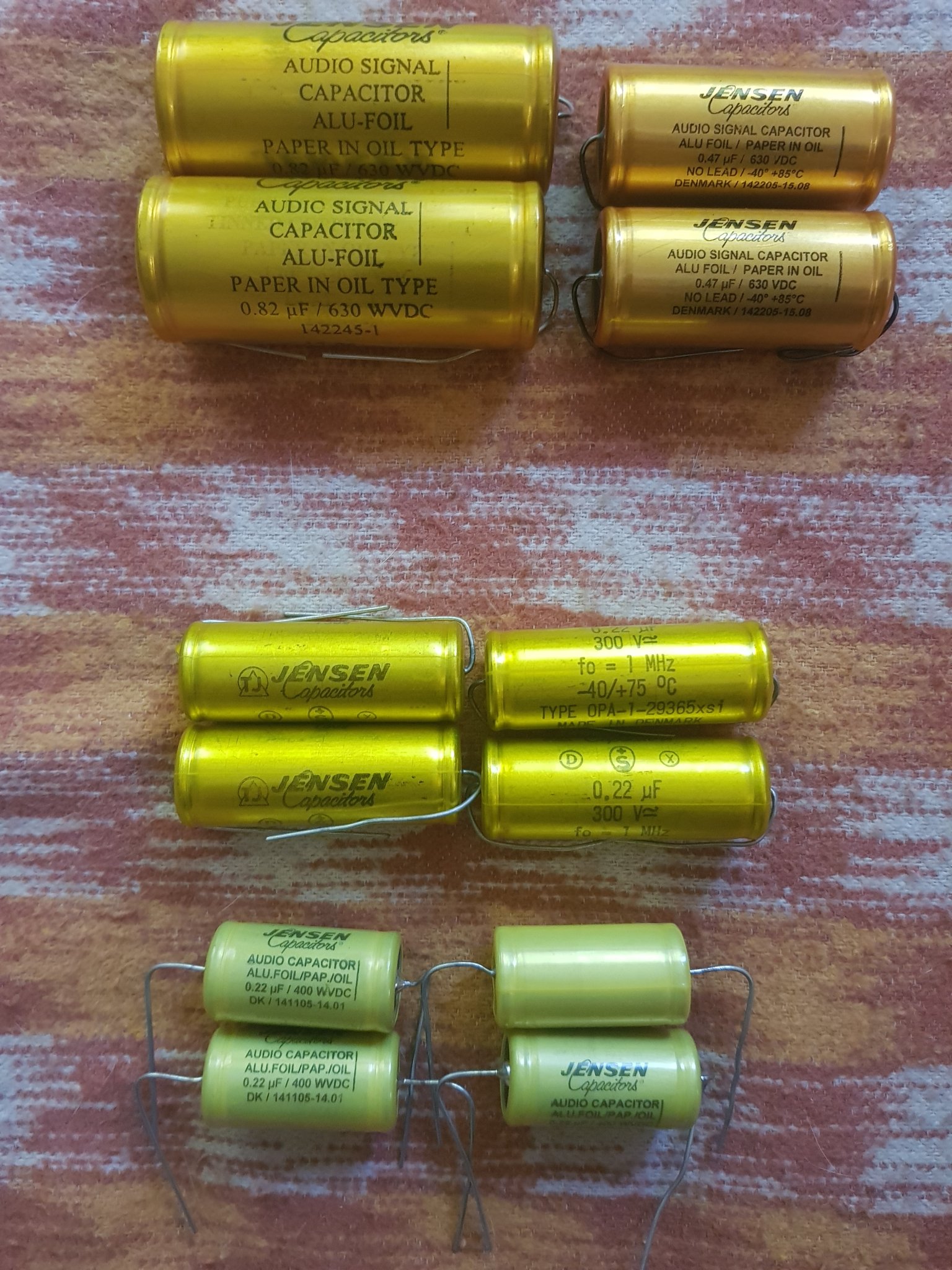

AI 1000 use Jensen oil-paper capacitors.
The Danish Coherent Audio make Duelund capacitors, which are exactly better....as many boutique manufacturer products (I use teflon V-Cap) ... but all of them pricey as hell. And many of them size such a shotgun shell.
See upper section (original AI capacitors):
Miflex make KPCU series capacitors, TME sells its ... but also big size ones.
![AI capacitors.jpg AI capacitors.jpg](https://www.diyaudio.com/community/data/attachments/1222/1222545-2c24d6288a07f7499afe100fa8133a5e.jpg)
