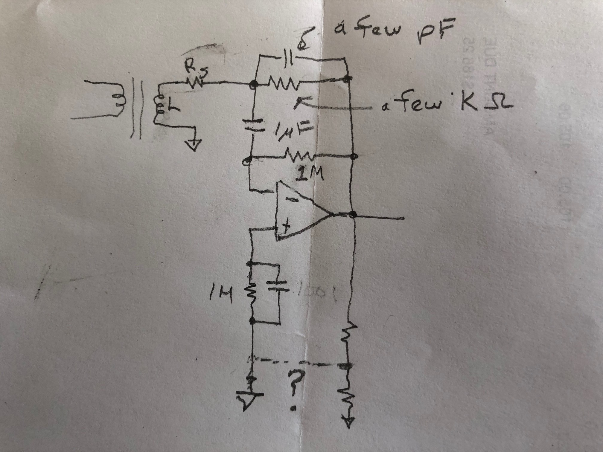

Ideas to improve a zero-field transformer based circuit
I have finalized the instrument:

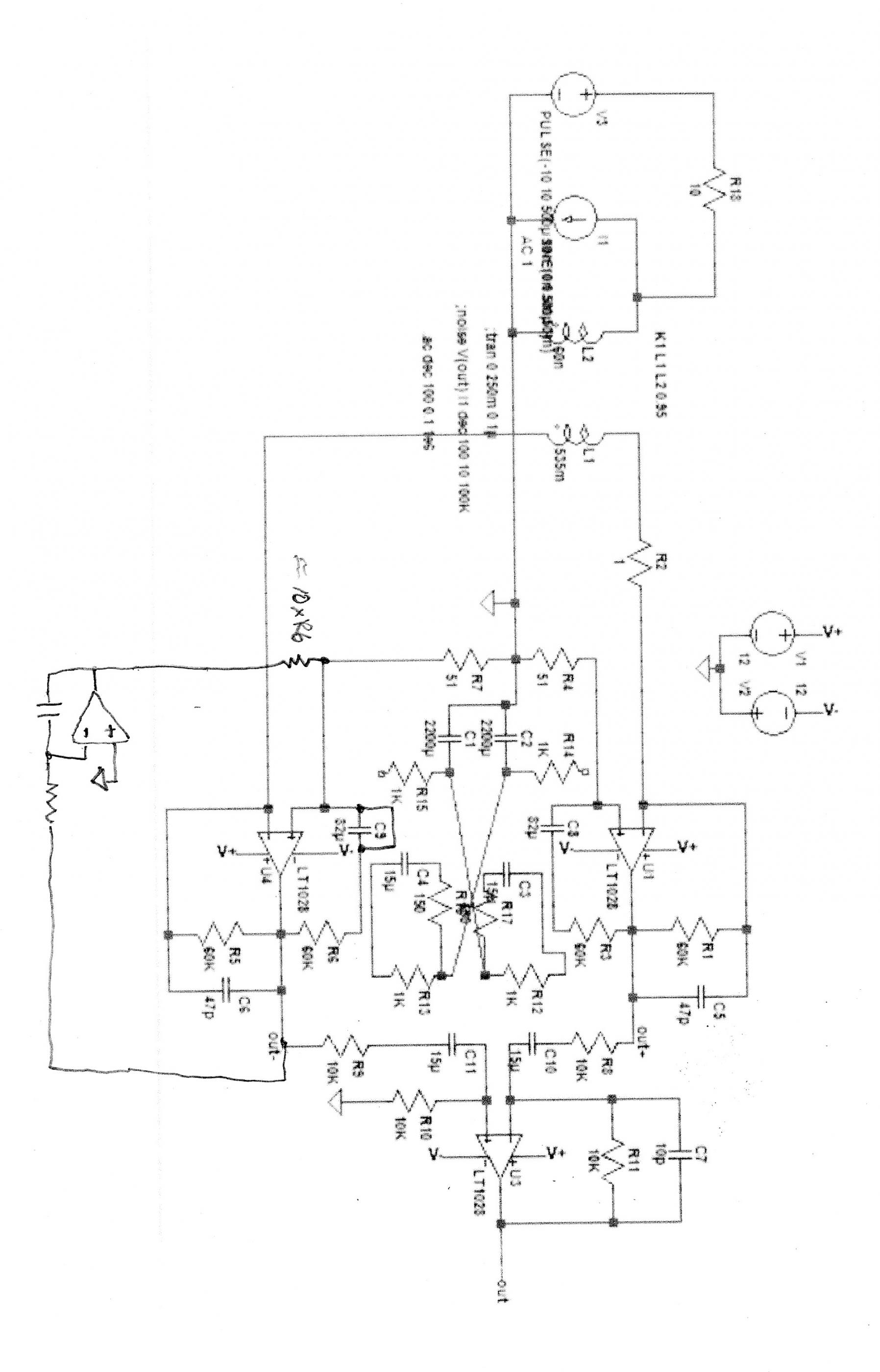

Here is the final circuit:
attachment.php
Some comments:
L2 & L3 are the bifilar, aircore compensation windings mounted inside the probe. As they are connected in opposition, their inductances cancel.
They have an odd value because I used an already wound coil-former: this spared me a winding job.
A word about C8. I faced a dilemma: I didn't want to leave the metallic cores floating, because they could pick-up electrostatic interferences and transfer them to the windings covering them, but I didn't want to connect them directly to the GND, as they could come into contact with some live part.
The tradeoff I opted for was to connect them to the GND via a low value, Y-type safety cap.
It is sufficient to shunt HF interference but it does not compromise the safety or the galvanic isolation, something essential for this kind of instrument.
D1 & D2 have no active role, they just protect the windings and electronics in case the probe is subjected to a high current with the power switched off: the zero-field circuitry being inactive, it cannot compensate the primary currents.
The "Ampere" conditioning circuits have discrete buffers, because they need to cope with the maximum peak of the transformed measured current (200A times √2 times the overload margin, ~2 in this case).
On the "mA" path, the role of R23 & 24 is to "paralyze" the circuit when it is not active.
Initially, C1 was mounted downstream of the mA/switch, and it changed the amplifiers into a multivibrator when the inputs were left open.
As the oscillation was a 10kHz 25Vpp squarewave, it leaked elsewhere in the circuit.
Since all the 6 sections of the switch were already used up, I didn't have the option of shunting the inputs or removing the power to the unused path, which is why I resorted to the resistors.
Under active conditions, they introduce practically no error, and they are sufficient to eliminate unwanted oscillations

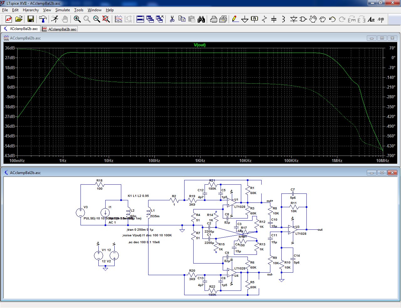

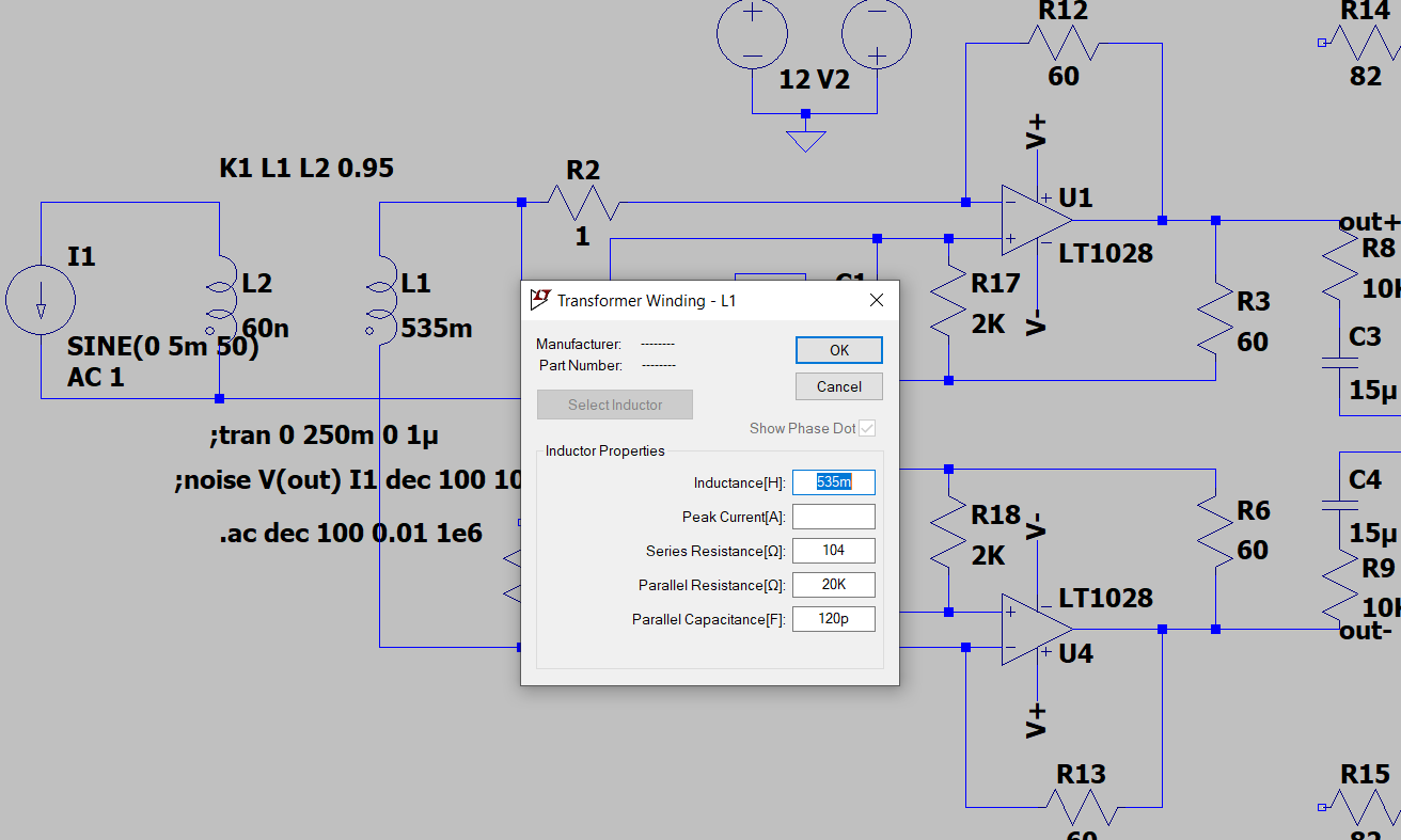

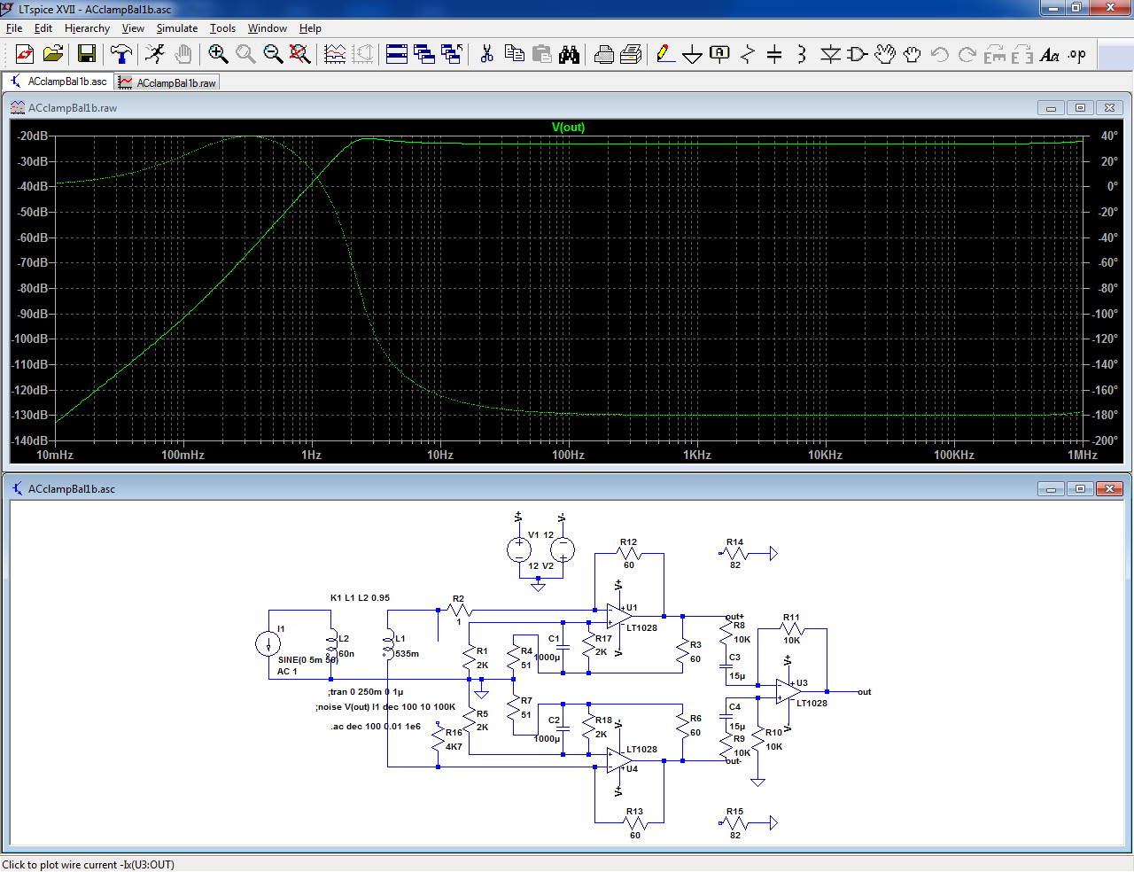

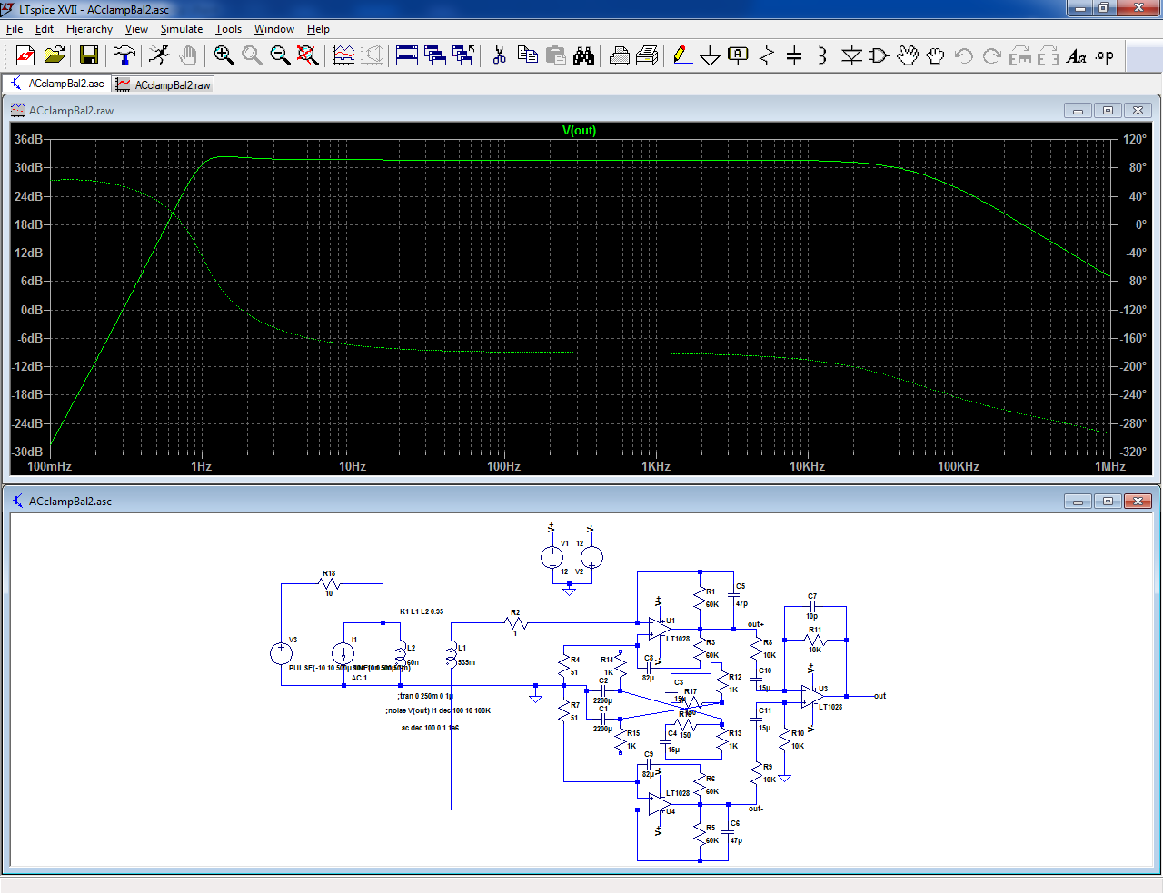

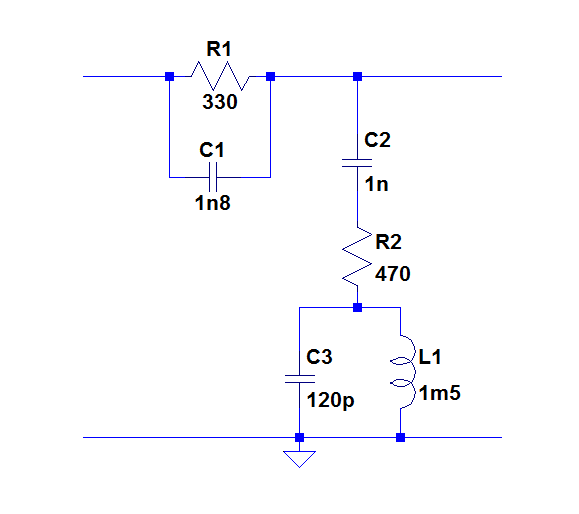

The rest of the circuit is relatively mundane and ordinary: each path goes through an equalizer, aimed at taming the seriously anarchic behavior of the sensor at high frequencies.
Equalization starts at the conditioning amplifiers, but the specific part is downstream: L4, R35, C17, R34,... for the ampere side, and R38, R39, C19, L6 for the mA side.
That is needed to eliminate the ringing.
The supply and AC voltmeter are run-of-the-mill circuits that haven't changed for more than 40 yrs.
They are perfectly OK in this case, no need to reinvent a rounder wheel.

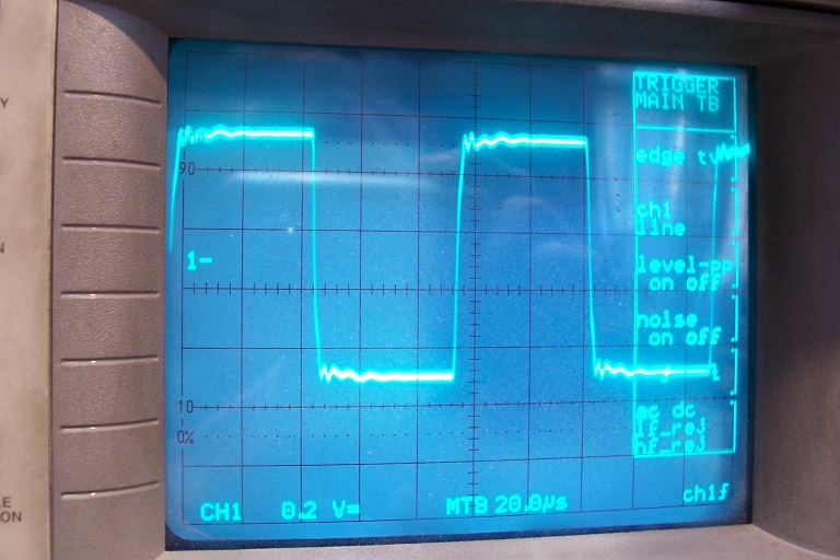

What about the performances? As hinted earlier, the BW is flat from below 2Hz to more than 100kHz, which is perfectly OK for audio work.
The step response is correct, which means some tradeoffs: without this requirement, the BW can be pushed to 250kHz by adapting the EQ circuit, but the transient response becomes ugly.

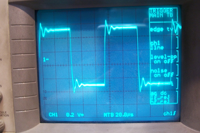

Some examples:
A 10kHz squarewave on the mA path:
attachment.php
A 1kHz squarewave on the mA path:
attachment.php
A 10kHz squarewave on the A path:
attachment.php
A 1kHz squarewave on the A path:
attachment.php
The waveforms are far from being perfectly spotless: some ripples and wrinkles remain, and it is possible to refine the equalization to arrive at a perfectly square output, but it makes little sense: the position of the tested conductor inside the magnetic loop has a greater influence.

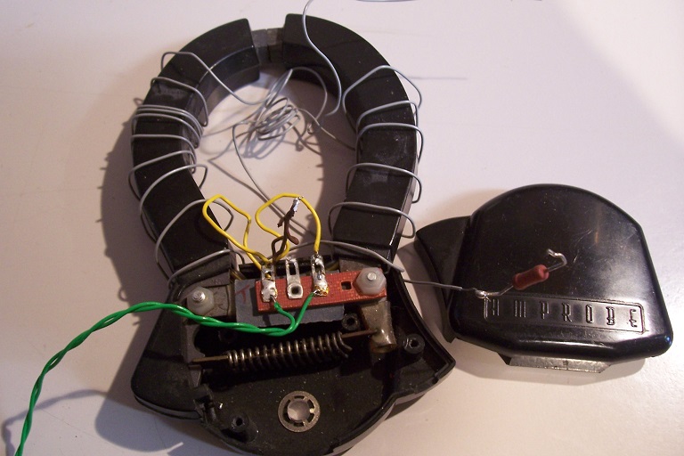

This is the circuit inside the probe:
attachment.php

One could question the point of the whole project: after all, current probes aren't exactly a rarity, and converting an old electrotechnical instrument into something else looks like a needlessly difficult path.
I had this probe gathering dust in a chest, and converting it into a useful instrument looked like a good idea.
The zero-field, negative-resistance circuit sublimates this low-accuracy, low-linearity, low-sensitivity single-frequency probe into a highly sensitive, highly linear instrument covering the 2Hz-->100kHz range.
Of course, that's what other current probes do, and in general they have a wider bandwidth, but good current probes tend to be short and fat, and have a small opening.
This one has slender jaws and a wide opening, which allows some interesting tricks.
