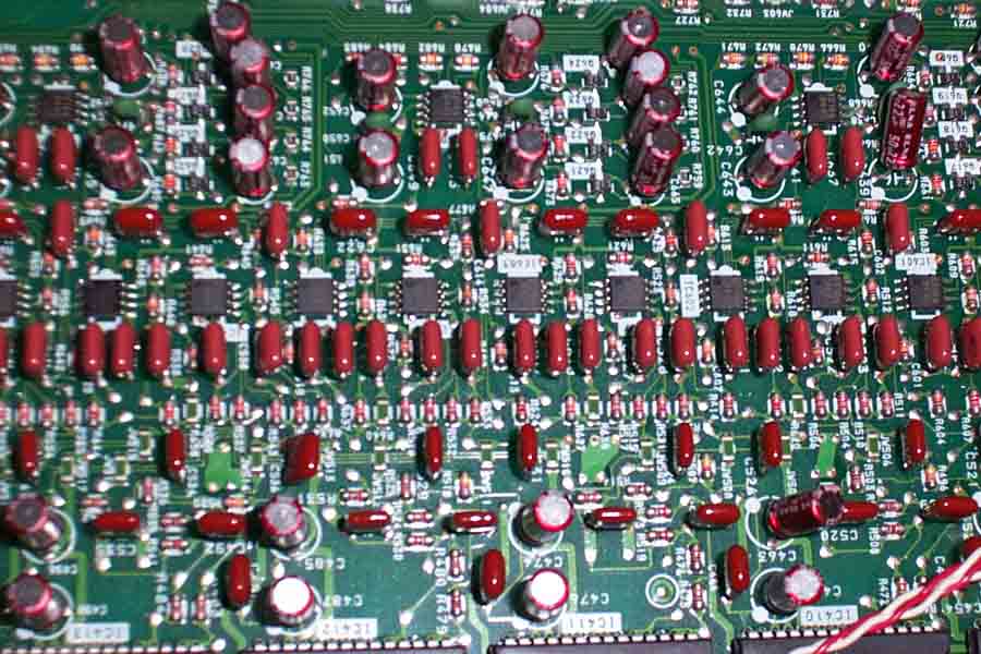

I had picked up a brand new sony sdpep9 es a couple of years ago on ebay for around a hundred bucks and immediately shelved it because I didn't think it sounded great. The recent activity on the behringer DCX has inspired me to unpack it and have another look. Well, in 2 channel mode it actually sounds pretty good I guess...just not awesome. I'm thinking that maybe I can improve the analog section after the pulse dacs. Maybe I can integrate the New Ellis_Jens filter right after the dacs with balanced outputs right there in the sony chassis?
I have searched the forums and the only reference I could find on the unit was here by member wombat. He is talking about a different model but the guts look the same. Gotta send him a PM.
Does anyone have any schematics or experience with this unit? Geez, I'd like to eliminate the front output analog section and take the dac right into the active filter boards buffer..I couldn't do it without a bit more info though...well, maybe a lot more🙂
Thanks,
Marc🙂
By the way, those opamps are 5218A

I'm not a digital expert, but I know enough to be dangerous.
It looks to me like the digital volume control takes a current signal and outputs current as well, looking at the output terminal designations, and the impedances at the next stage (LPF, IC415, etc.) This stage looks to be the I-V as well as the low pass filter.
Depending on your willingness to work, you can try anything from taking a balanced output after IC 415 (eliminating IC601 and all those switching transistors), splicing in your own I-V stage/ low pass filter before IC415 or getting rid of the likely biggest offender, the digital volume control and disconnecting IC409 and connecting your I-V stage to R25-28. Of course that means that you just signed up to build a 6 channel volume control. There are a couple of kits for that available here, though.
For all I know the DAC may be voltage output, judging by its 100R loads, but it seems odd to have a voltage output DAC with 2.6V of offset. If it is a current output DAC, the current is low and you'll need a heck of a low noise I-V stage. Sony doesn't seem interested in publishing a data sheets for its proprietary chips. Wonder why?

Look at the feedback network and filter elements around IC415. There is 10R and 270R setting the gain. This low resistance along with the 10R-22nF-10R low pass filter is what makes me think that this is the I-V conversion stage - low impedance and high voltage gain (29.4 dB)
I suggested a buffer following that assuming that there is not much room and your filters would be in a separate enclosure. It is not strictly needed as long as the cable runs are short and you take the output from the output pins of IC415 (before the 10K resistors.
Looking at it again, you might find some improvement adding decoupling caps - it seems that IC415 and IC601 share a single pair. That's not the best practice, but it does save a few pennies per unit.
There might be some improvement just bypassing the electrolytics in the signal path C639, 640 etc.

...........It is not strictly needed as long as the cable runs are short and you take the output from the output pins of IC415 (before the 10K resistors.
That's the direction I want to take. The boards will reside in the sony unit with no interconnects. I didn't know exactly where to grab the signal and your tips are priceless.
