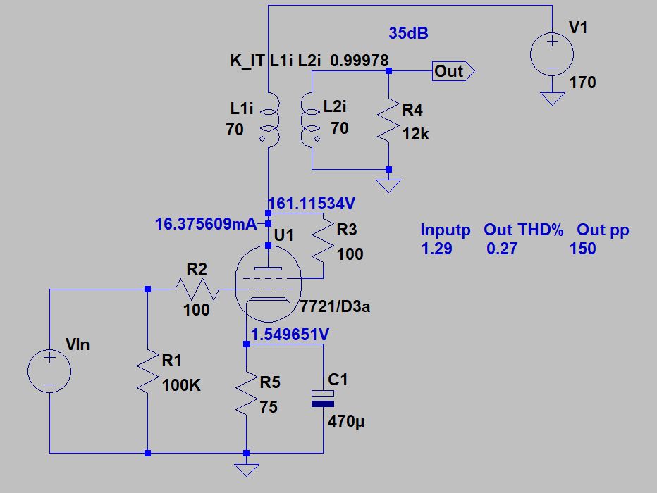

D3a (or E280F) and C3g (or rare C3o) as triode are perfect VAS tube for two stage amplifiers.
Both have low distortion even at large swing, and harmonics distribution results "good tone".
Sample:

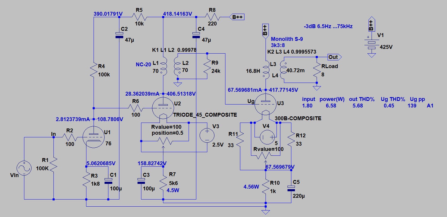

Hi, as my thinking progresses and am starting to lean to the all triode 76/56 DC coupled 45 -> NC20 -> 300b path… I’d like to pick your brain on the WAF of all of this and practicalities of how to build this.

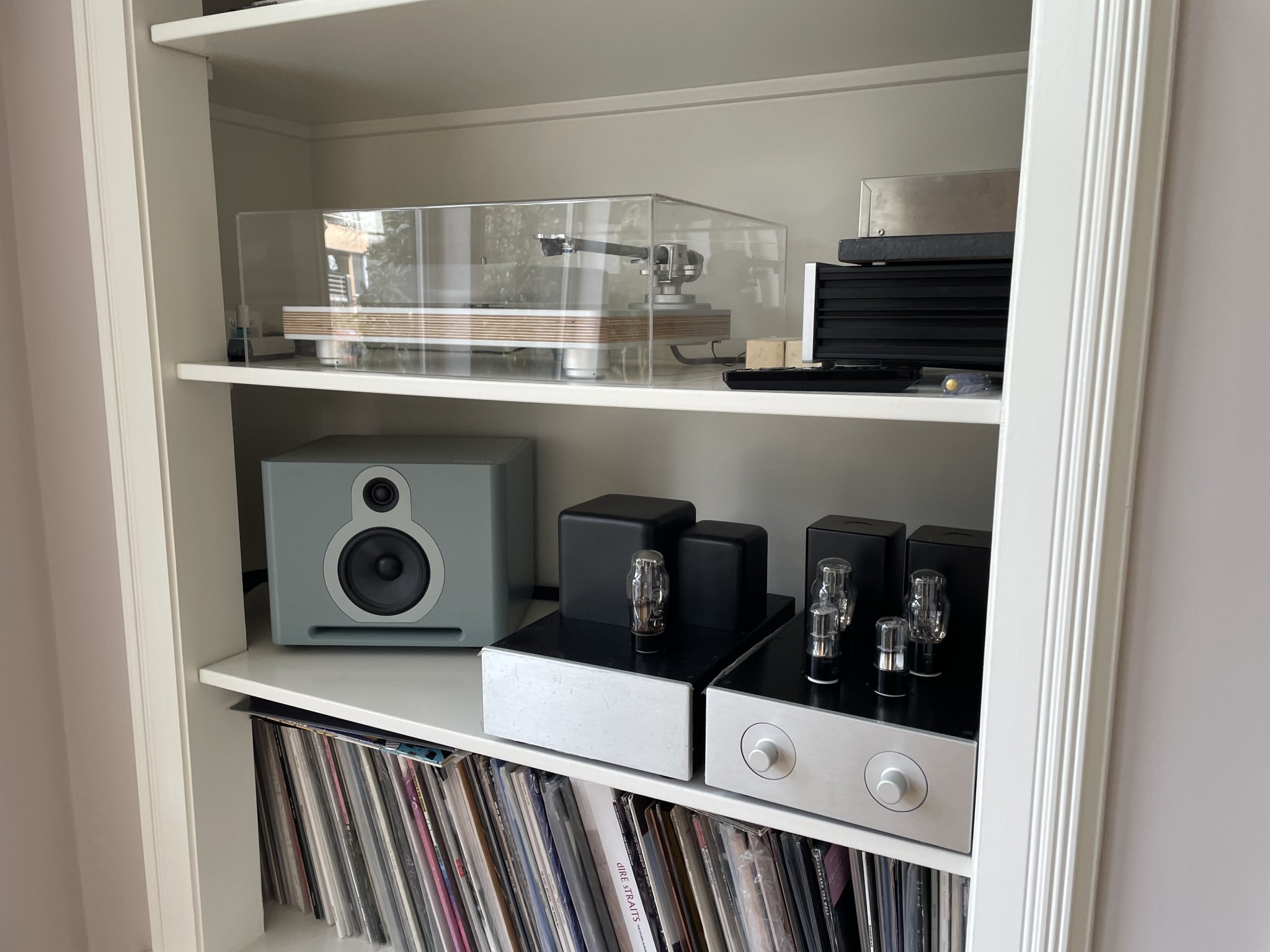

That’s a tight fit, and nicely done. It would probably still fall in the “bulky” category as my wife called the Simple 45.
I’m coming from the 47 labs Shigaraki, which obviously is “petite” compared to anything with proper DHT valves 🙂
That said even though I would need to cram in some rectifiers, input selection and an attenuator, that symmetric layout is quite neat, also puts the interstage transformers in a natural position. (So far I thought the 300b might end up hidden behind the ITs).

Some more progress in my thinking and the first components start to come in (two 76 tubes on the bench, and 45s on the way).
I’m keen to forego maximum wattage for now and run the 300b with lower voltage and amps, also with an idea in the back of my mind to keep the door open for the EML Mesh version (which should be run at lower dissipation). Therefore I’m thinking an anode voltage of 350V, 63mA and the grid at -74. This, if my thinking is correct, should result in a 425V B+.
Would this imply I could run the 45 at 250v 34mA and -50v grid as per the datasheet or go a a bit higher at 275v, 36mA and -56 at the grid?
Intuitively I’d rather run on a lower voltage as I suspect distortion is lower, but I also see that the output impedance goes from 3900 to 4600. Would this have a positive effect on sound quality? Or would a lower impedance be better? Should I consider 180V and go for more filtering?
If the 76 is run at 100v anode, then 100+250+50+ a few volts through the NC-20, would conveniently be rather close to the 425 B+ required for the 300b.
Any inputs much appreciated!
"lower voltage as I suspect distortion is lower"
Higher current of tube == lower distortion and lower output impedance.
Lower output impedance == higher driving ability == lower distortion with problematic (for example high Cp) load.
If you have the opportunity to increase the current (within the reasonable limits), must be done.
Hi @euro21 thanks for the response, I didn't realise about the 30mA for the NC20, nice catch, not worth risking these expensive ITs.
The schematic above, did you build that in Spice? again impressive how quickly you turned that around. I was planning to do some simulations to see if I could calculate all resistor values etc... correctly. Although seeing the above, I can perhaps skip that and use your values 🙂🙂
As for the distortion, perhaps I'm not using the right technical term, I thought by not running the valve at max power, one could stay in a more linear / symmetric region of the load lines, but that's just an unscientific assumption, underpinned only by the fact that a lot of classic schemes in case of the 300B seem to bias only at 320-350 with +/-60 mA.
I'm not looking for the highest output wattage, my current 45 SET goes plenty loud, nor for the best measuring amp, but looking for that fluid natural Single Ended Triode sound. Again thanks!
