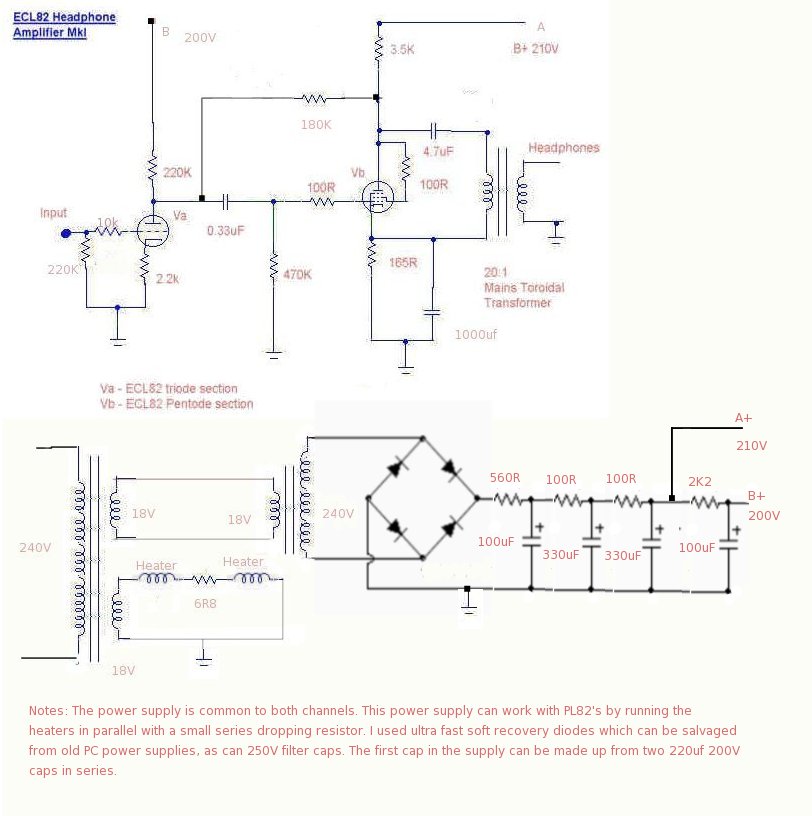

Here you go.
Shoog

Just came across this thread. Nice little project. I'm getting together the stuff to build a low power resistor loaded amp from Steve Benche's site. One question on your design: Why not put the parafeed cap on the ground side of the OPT? You can use a lower rated cap. Maybe at these voltages though the cost would not be much different.
Sheldon
I had to hand some nice 4.7uf caps which are rated at 170V (not quite there but I think it should be OK). I always have slight concerns about the safety of putting the cap in the return leg, just in case there is an interwinding short.
Shoog
"Thanx. You should save that as a gif. The noise in the jpg makes it a bit hard to read."
I know, but I did it in "Gimp" by a proccess of cut and paste. Does anyone know of a good schematic drawing program which works in Linux land. Someone mentioned Eagle to me but I think this is windows based.
Shoog

A couple of minor notes:
Not sure though why your input grid stopper is so big while the
pentode GS is quite small? Might try equalising this a bit by using
1k in both positions. Might not make any difference, though.
Also not sure if current in input stage is sufficient with the plate-
to-plate feedback. Probably marginal, actually. I have a feeling
the sonics would improve with more current. The 180k resistor will
look like something rather a lot smaller to the input stage due to
the feedback action. Though it could be OK with cans, as the
voltage swing required is usually rather small.
Sheldon,
Why would a parafeed cap in the return lead require a smaller
voltage rating? As far as I can see, there is no difference in voltage
requirement whether it's in the "send" or the "return" lead. Either
way, it should be rated same as B+ voltage or a little more to safely
survive start-up. Pre-heating the heaters lowers the requirement,
but I would anyway use a 200-250V part here.
Morgan
Morgan, I seem to remember from my examination of the datasheet that the Triode doesn't really like to stay linear and deliver more current. I have a strong feeling that the 200K and 2K2 was the only sensible operating point. I would have to check the data sheet to be certain.
Shoog
