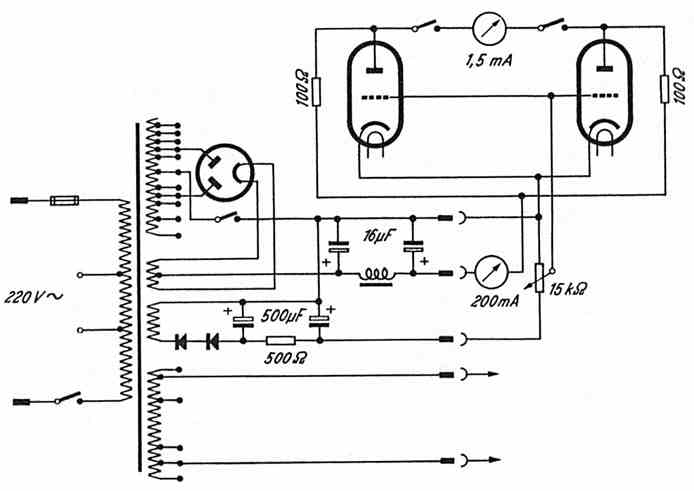

For matching Tubes maybe this Schematic is usefull as a starting point:
Röhrenprüfgerät für Gegentakt-Röhren
Only problem is to find an amperemeter with positiv and negativ range and zero at center position.
Best regards
Michael
Interesting idea to match tubes all over their working range. The ammeter may indeed be a problem, but wouldn't it be possible to use a low value (10R?) resistor instead with a DVM across it? DVM can show both + and - without a problem.

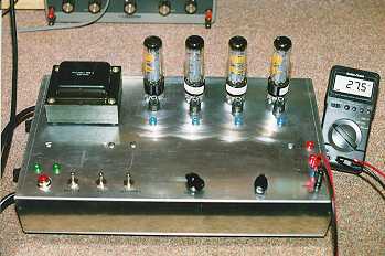

here's a picture of a compatible setup i made, its working fine. but I'm still thinking of possible improvements. it is still missing the lettering, and the rest of the enclosure.
specs:
Anode and G2 voltage: 0-320volts limited to 140 and 45mA
grid +- 100 volts 10mA
heater: 1.25 to 24 volts 5A (Lm338) whit 3 taps on the transformer to limit dissipation.
all Pots are 10 turn, and after this picture was made, i added a Dialer to the grid coarse and fine controls,
The 7 knobs are rotary switches, they set all the connections between the tube and the supplies.
the right knob operates a shorts test between all elements, when a short under 2mohm is detected the neon lights up, in the final setting (10) the relays for the high voltage are engaged
it has a lot more gizmo's i'm not going to bother you whit all of them, But of course i just wanted to show of my new toy😀

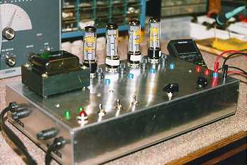

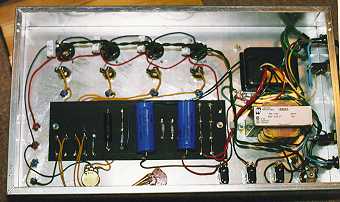

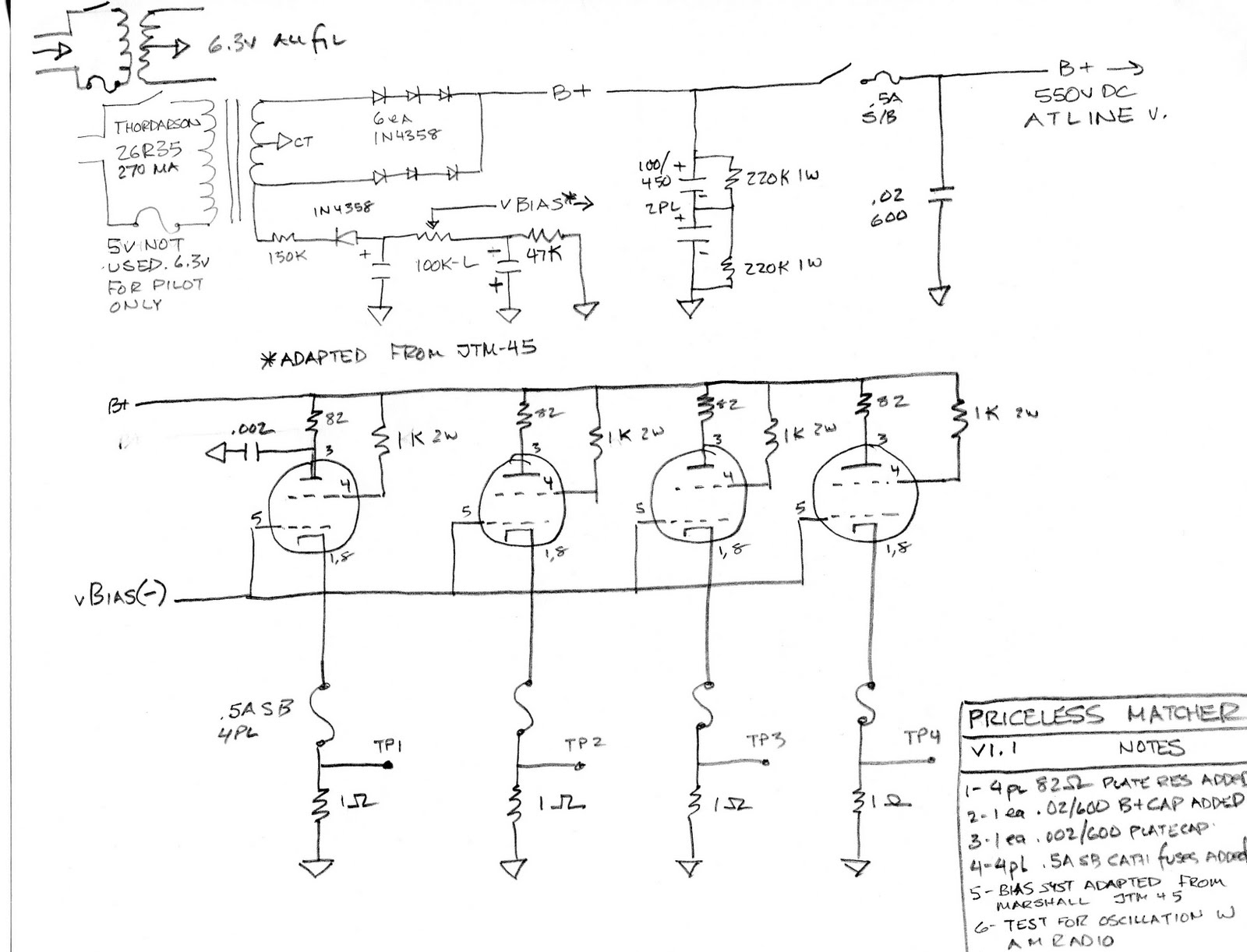

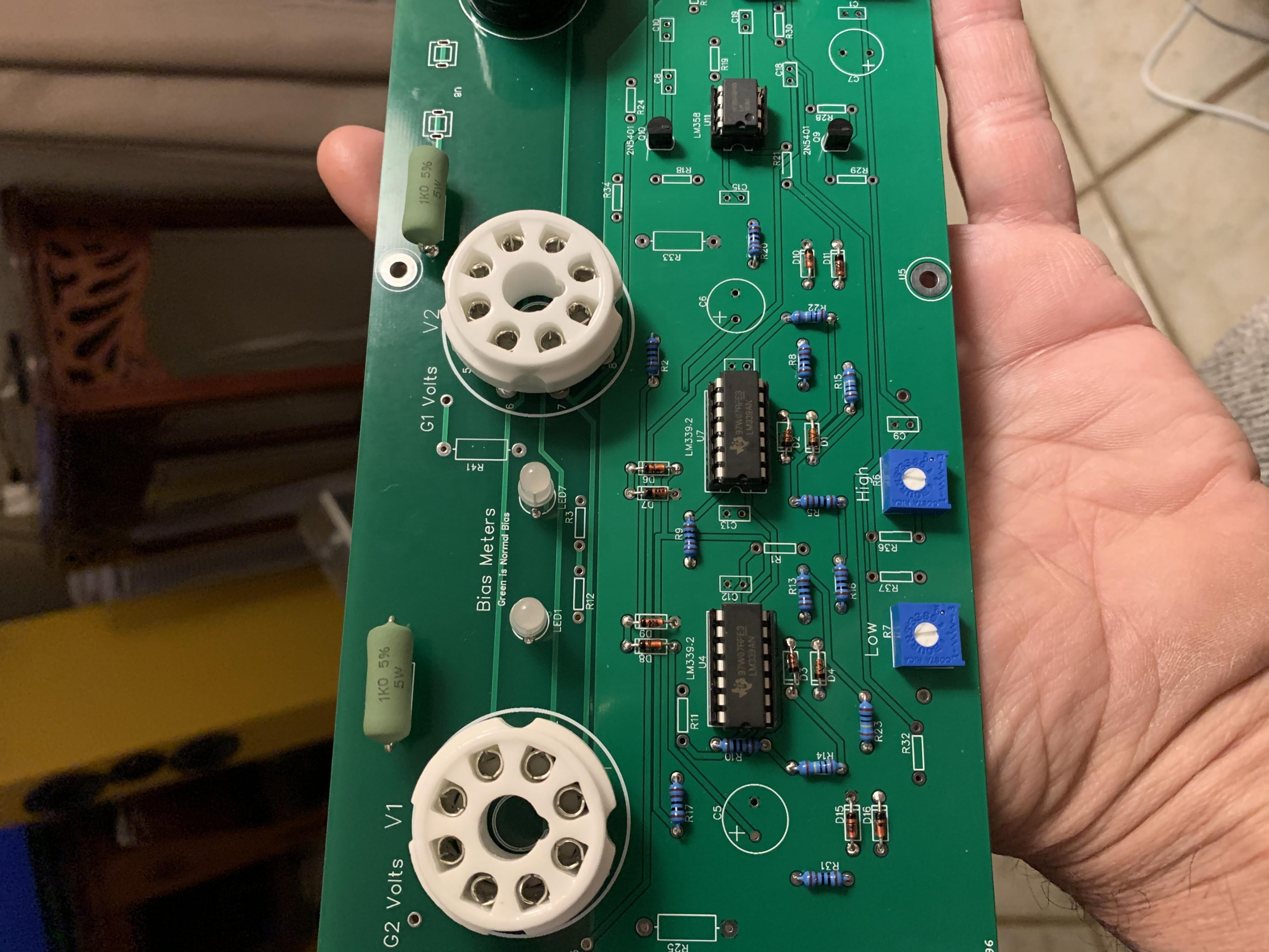

Here is something I came up with it works really well so far,just doing some tweaking now. It comes with a bias control and meter circuit, I’m thinking of using panel mount volt and amp meters if it goes into a case. At the moment I’m using about 495VDC for B+. I’m modifying it where there is just one control(trim pot) for both the reference voltage and meter calibration. Will post more pics later
